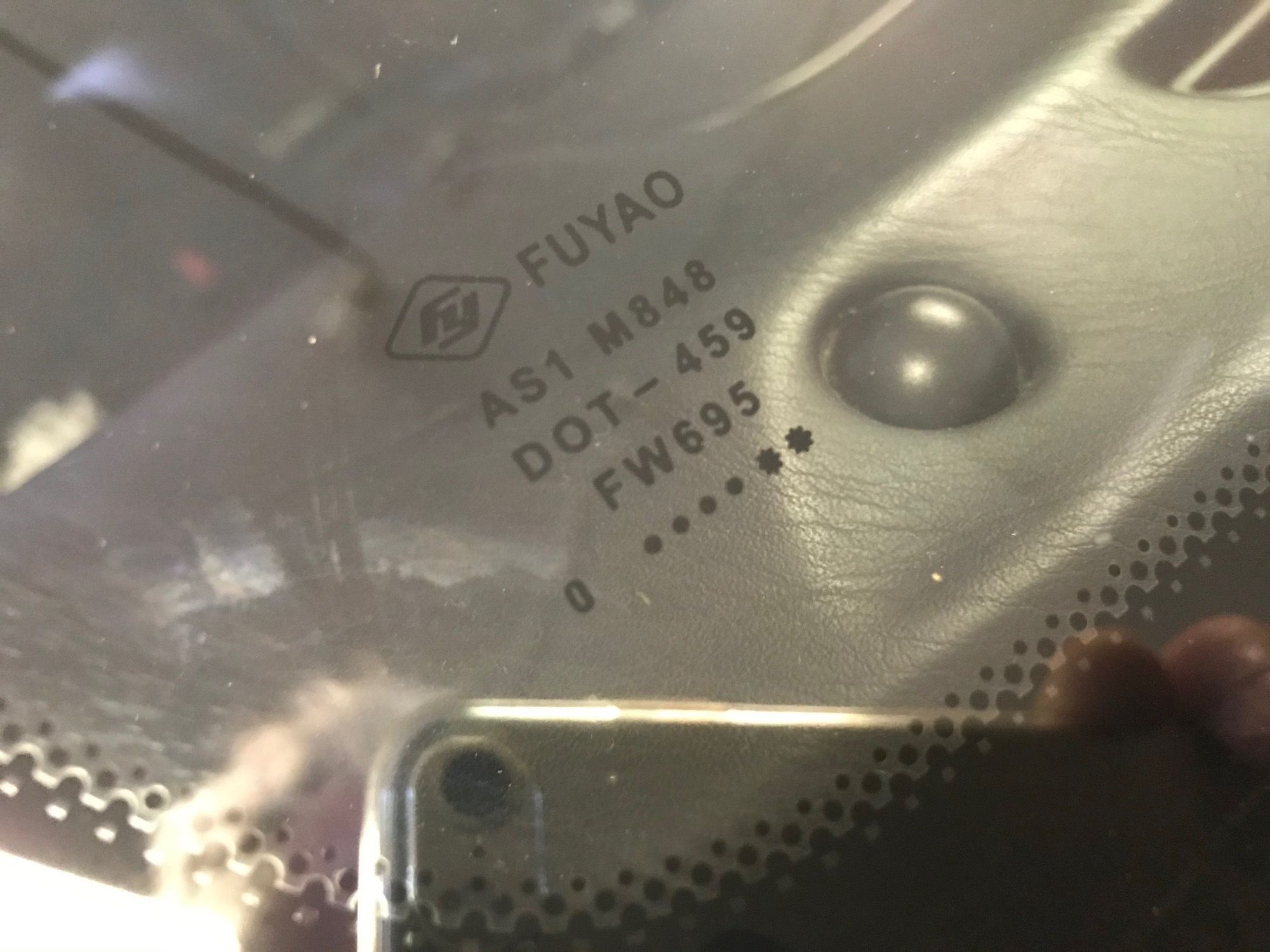

Glad you had a positive experience. Would you mind sharing what brand the glass is? What you paid? Photos of what the rubber seal/trim looks like?

Here's a couple Pics of glass ID and the surrounding molding...

Oh, and an FYI- Bonus! it's made in Ohio.
