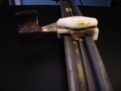

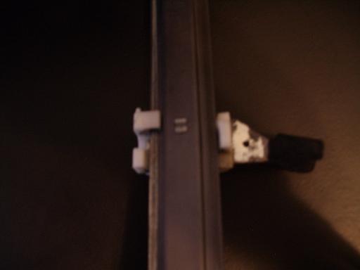

My passenger side window regulator went out a few weeks ago. I ordered a new part from Carson Toyota and really didn't have any problems swapping out the parts. The plastic piece was broken in three areas.
Notice the two 'fingers' broken off:
Here you can see where the part was starting to break similar to the way OLT's broke:
