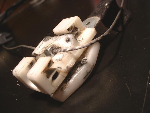

Due to both my driver side window regulator and passenger side regulator breaking in the same week, you are now about to learn how to fix your regulator with 5 bucks worth of materials and get an understanding of how this unit works.
Below is the start of images to come and detailed instructions on how to fix and understand what is going on inside your door. Kiss that $100.00 charge goodbye to replace it. I don't play that

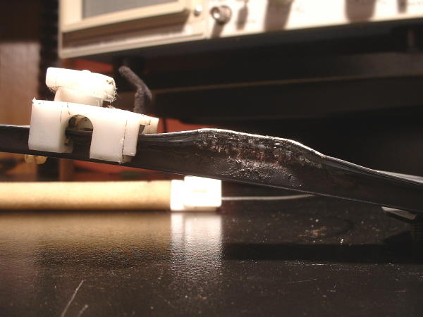

First, the part that breaks is the plastic coupling that rides on the tracks wire which is wound around a spool attached to a motor. When the part breaks, the small metal block breaks through the plastic and the window drops. As the wire and block continue to go up and down, it now is seperated from the plastic coupling that the window is attached to.
As we progress, we will learn how to fix this plastic piece back to "good as new" strength and make our regulator functional again without spending $100 bucks for a new one, when our old one works fine.
The first picture shows the spool that the wire circles on. The second picture shows the track and the faulty plastic that breaks as the regulator fails. Notice the metal block, this is what is supposed to be inside the plastic. The relevance of the spool is that it must be released and unwound to get the wire out of the regulator.

After unwinding the spool, proceed to the following.
The first horrible truth to this operation is that because of the way the plastic arms mount, there is no way around it.... you have to bend the regulator. When the factory built the unit, they first slid the plastic onto the rail then proceeded to rivet the pulley wheels in place. In this picture, the regulator has been bent using vice grips. although the picture doesn't show the vert well, the side has been bent up at a 90 degree angle facing strait up so when the plastic slides past it, the arms will simply lift strait out and the coupling will be free from the track.
Once you have removed the coupling, the wire and the coupling should be free from the unit and you can now assemble them back properly as seen below. as you can see, when they break, they loose a lot of the plastic that holds the unit in place. place the piece back into it's respective position and proceed with the reforming of the plastic. (coming shortly)

Now we come to the part where we are going to fix what is broken. I am choosing to use a company that has been around longer than i have. We will be using the original formula JB Weld. First i cleaned the surface of the plastic to remove all the old grease from within the center where we will be applying the mixture. Then i scruffed up the slick plastic with some sandpaper to allow the mix to get a good grip on the plastic. Finally i applied some aluminum foil to keep the mix from running into the track area on the side because this stuff turns into a rock when it dries. Then i have applied the first coat of the mixture to the wire and coupling. Don't worry about it being a little messy on the coupling, you will have to do a little light sanding to perfect it later.
