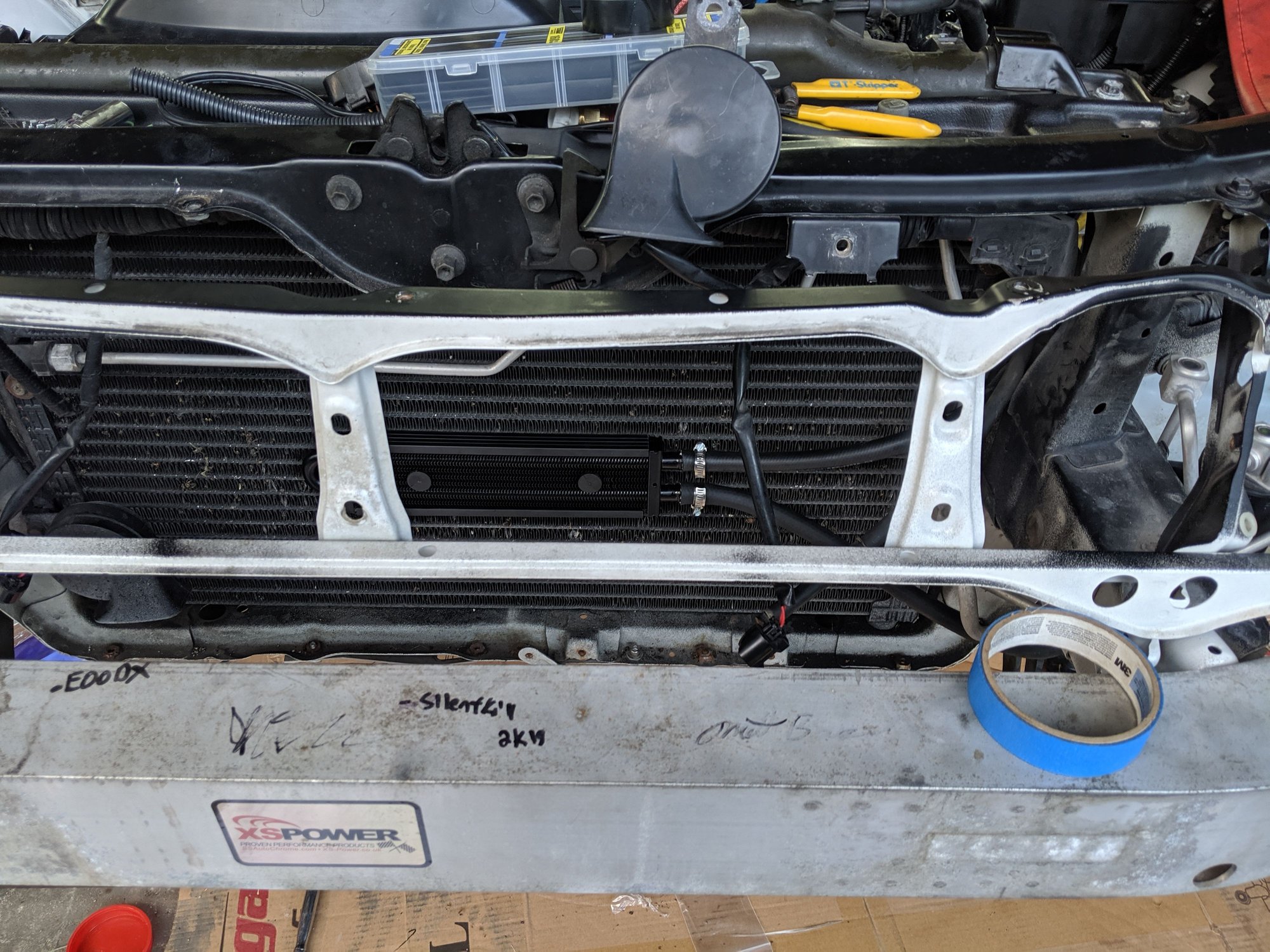

Power steering is done, video on it and some of the frontend stuff.
Old Aug 22, 2019 | 07:34 AM
  #71
silentkill's Avatar
silentkill
Joined: Jun 2017
Posts: 652
Likes: 227
Couple of pics from power steering system completion.
