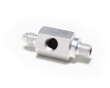

I think for the oil feed i might pick up one of these fancy adaptors i found:
this is 1/8 BPST to -4 or -3 AN Male and the top port is 1/8 NPT which can be used for oil pressure gauge.
I might just have to run a 90 at the end of it or maybe i can get away with it straight we'll see, might just need to make my own -3 line.
