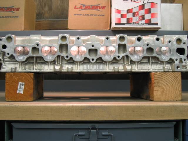

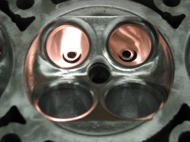

AFA the heads - it sounds a lot like nobody here has actually stuck a die grinder down a port. I've done both GE and GTE heads. The GE head lack the cooling of the GTE heads, and the GTE heads have all screwed up exhaust ports. The ideal head is the GE intakes raised and widened a few mm then blended with the floor of the exhaust ports welded up ~4mm to flatten it out and raise them then add the GTE cooling passage over the top of the exhaust ports. So, that head doesn't exist in real life. But the intake ports would look like this:
(This is my work, not some shop. There are bigger pics in my photo album, and this head belongs to someone well known in this thread)
Ideally this head would also have 1mm oversize valves on both sides and 85% port to valve diameter ratios. The GTE head likes 88% on the exhaust for some reason, but I think it's because the GTE exhaust ports are not as nice as the GE's. JMHO.
So, in the end, I'd marry a GTE short block to a GE head modded similarly if I wanted best power and good reliability. The extra cooling provided by the under piston oil jets makes tuning a little less scary, and you can run ever so slightly leaner without disaster, so if you make a small tuning mistake it won't cost the whole engine. Finding a junk 2JZ short block worth rebuilding isn't too hard - I've got one in the garage right now just waiting for the time to do it. The head work is pretty easy, and bolting it all together isn't hard either.
I haven't played with a VVTi head yet, so I really can't speak to any advantages or disadvantages, but I will say one thing - thick headgaskets are the kiss of death. Spend your money and change the compression the right way - put in the right pistons. Thicker headgaskets only increase the squish volume and reduce detonation resistance. Ideally you want the top of the piston ~1mm from the bottom of the head at TDC, and maybe even less (GSXR 750s seem to like a little less than 0.5mm for best performance!) but the whole reason for this is to reduce dependence on band aids like water/methanol injection for killing detonation. They have their place, but if you get the engine's internal dimensions right the first time, you'll get far more from plain old pump gas than you ever imagined possible.
BTW, I just read some serious misinformation about the compression on the GE and the GTE being determined by the headgasket. Nothing could be further from the truth. See pics below:
Notice the step in the head around the combustion chamber on the GE head? That doesn't exist on the GTE head as you can see in the lower picture of the GTE combustion chamber. The bottom of the GTE head is flat with no step at all. Also, the combustion chamber volume on the GE is significantly smaller than the GTE. Notice the shrouding around the valves on the GE head that is not present on the GTE head. This shrouding takes up a lot of room and raises compression ratio all by itself. Both are terribly limited in the squish area department and this is why the more modern engines have better specific output (more compression, less detonation problems), but the combustion chambers are just as different as the ports are. FWIW, this GTE head is a true street port - not pretty, but very functional and intentionally left rough for post-portwork ceramic coating.

For the sake of discussion though I wanted to point out to you that the staggered cam theory was proven incorrect with dyno tests by a company that posted up on SF. They tried it with some mismatched 264s and 272s and with the cams as a matched set. They got better results with the matched set.
what is the piston deck height of a 2jzgte? I would really like to know that so that we are comparing apples to apples.
What is the cc volume of the gte vs the ge head?
I dont really agree with the context you put this into - It certainly isnt "misinformation" or "nothing further from the truth" although it does not include the fact that the head is shaped differently. The head gaskets and pistons are different. I have to give props to Bean for his writeup. Taking the time to explain something that has got thousands of views is something that not a lot of people care enough about or have the knowledge to do.
