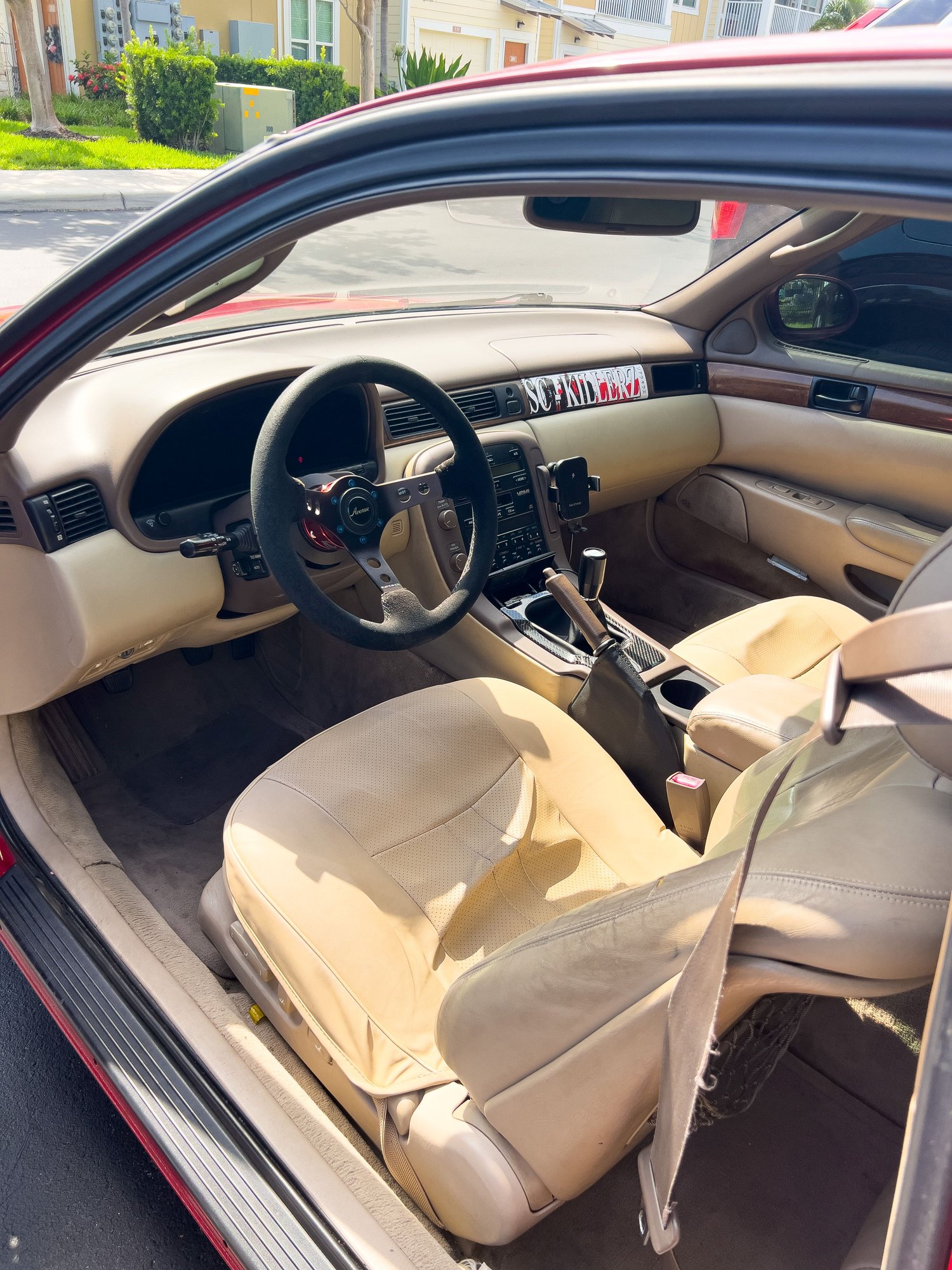

I did get the bigger cupholder upgrade and a carbon shift bezel to replace my stock one that was falling apart
it has a Cube short shifter on it, but the W58 is in desperate need of solid bushings for the tripod as it moves quite a bit. Should feel much better after that.

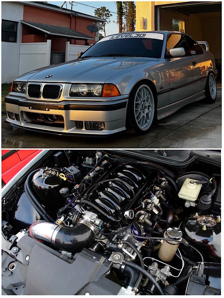

Also i figured I’d post a picture of my previous build! Planning for the SC to turn out even better than the E36 did. I actually work at a small BMW shop now so I have access to a ton more tools, lifts, etc. The E36 was built in my garage from start to finish
