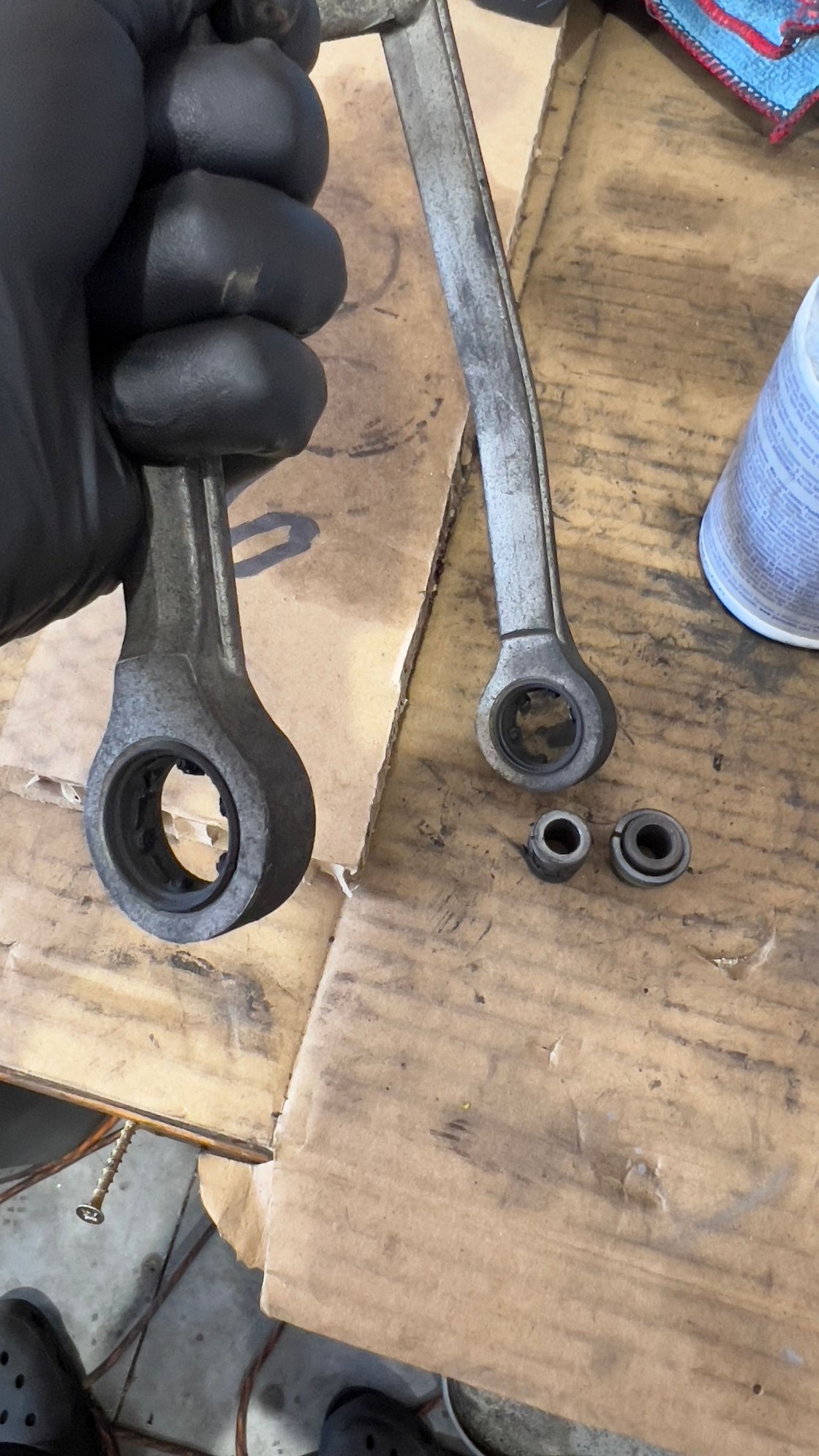

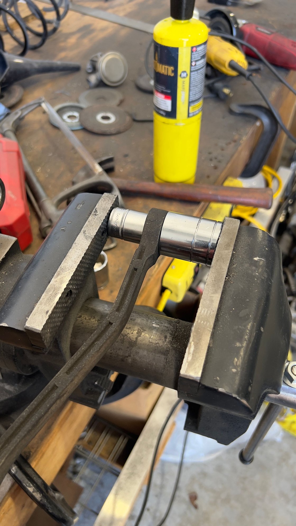

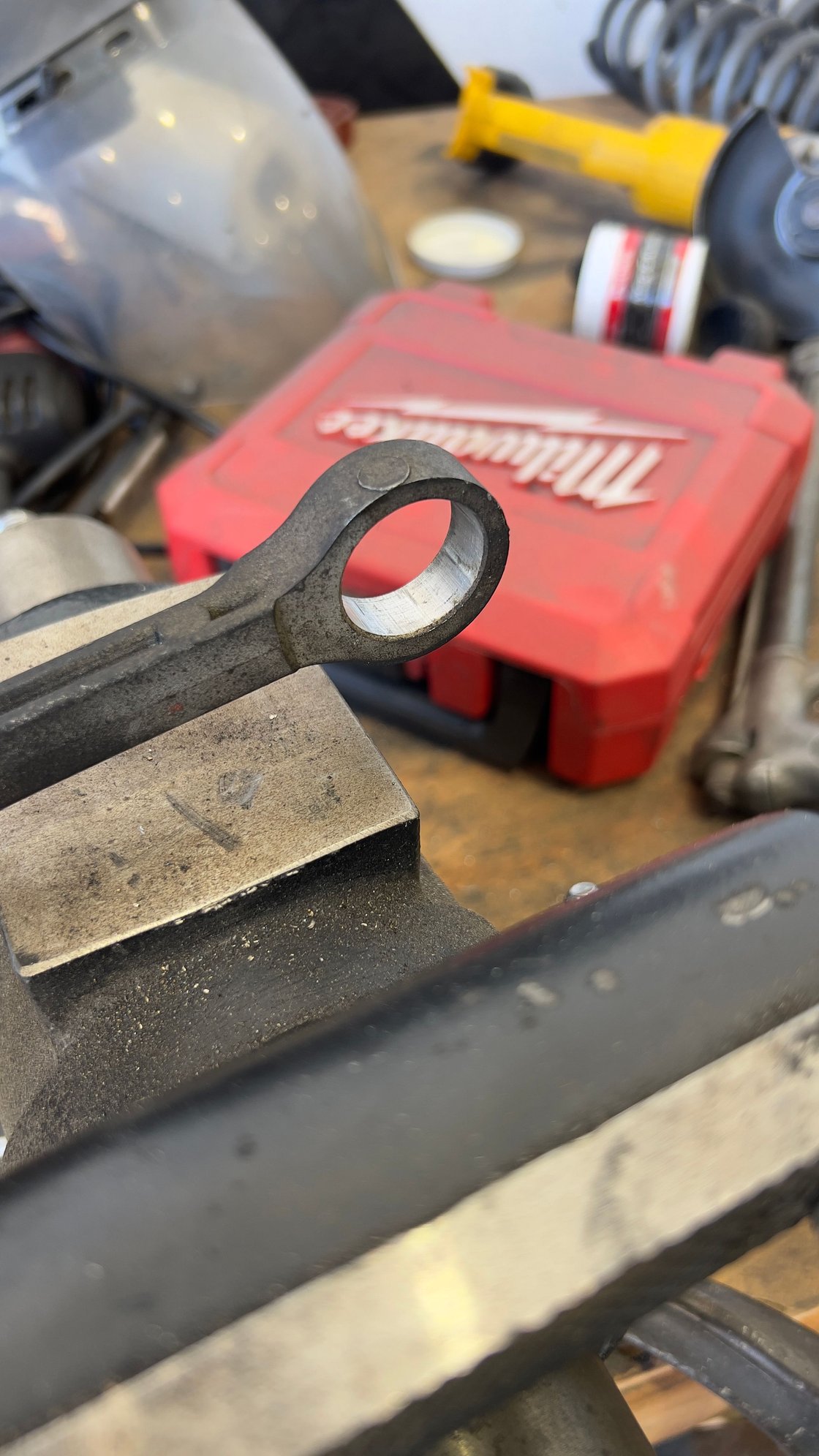

W58 tripod bushings were falling apart, pressed them out with 18mm and 22mm sockets and put in some new Cube aluminum bushings. Feels much more solid now!

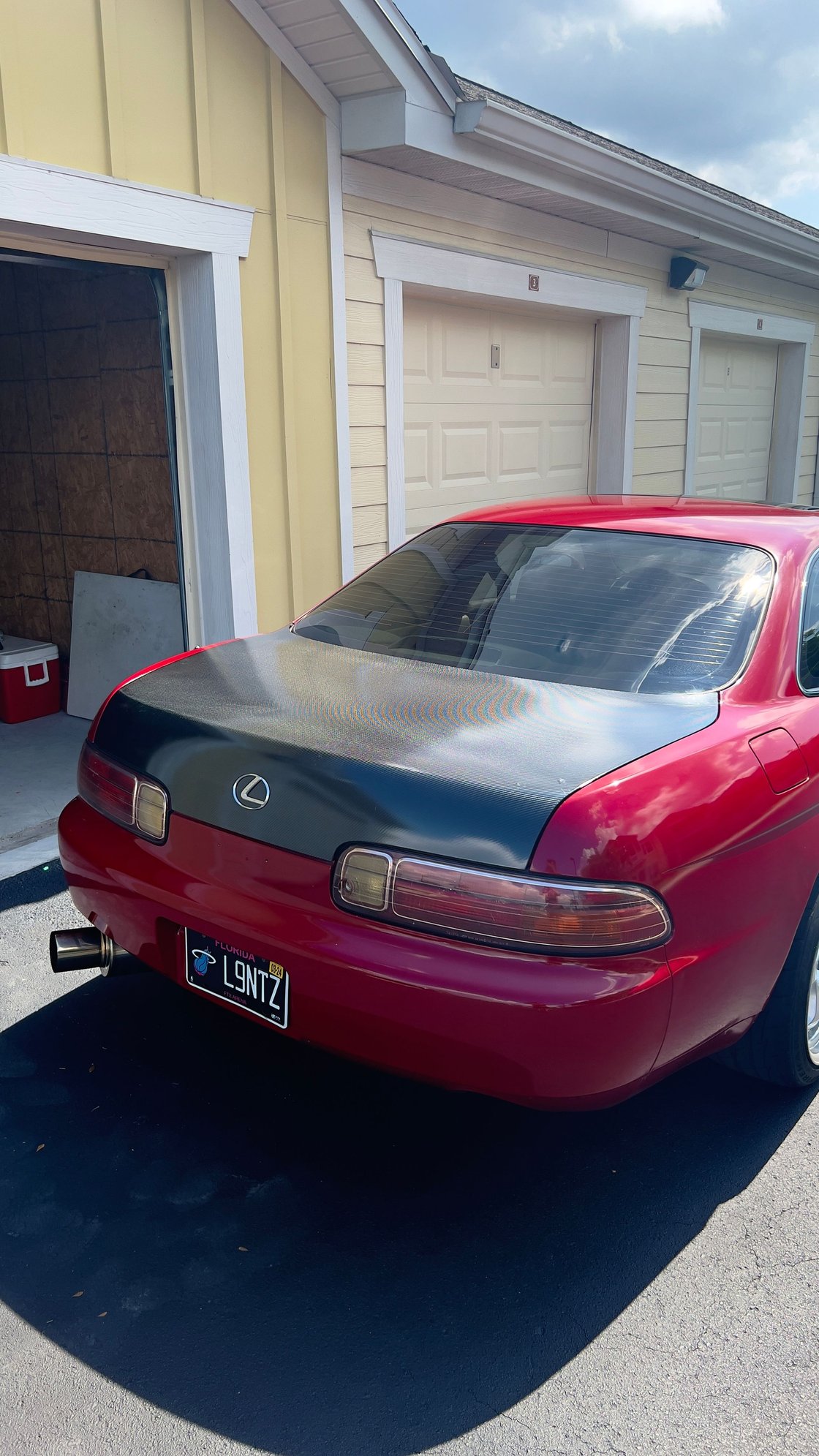

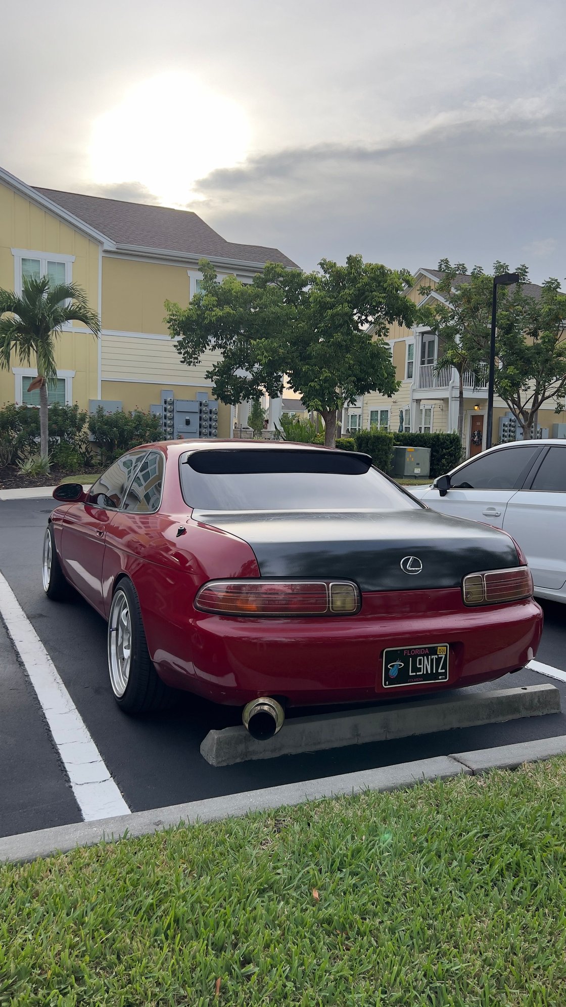

When I got the car it had a black trunk on it for some reason (and an imperfect one at that), I’m undecided on whether the car will be wrapped or whether the body kit will be painted to match the car so for now I wrapped the trunk in carbon fiber and it looks much better in my opinion!
had to throw the logo back on of course!

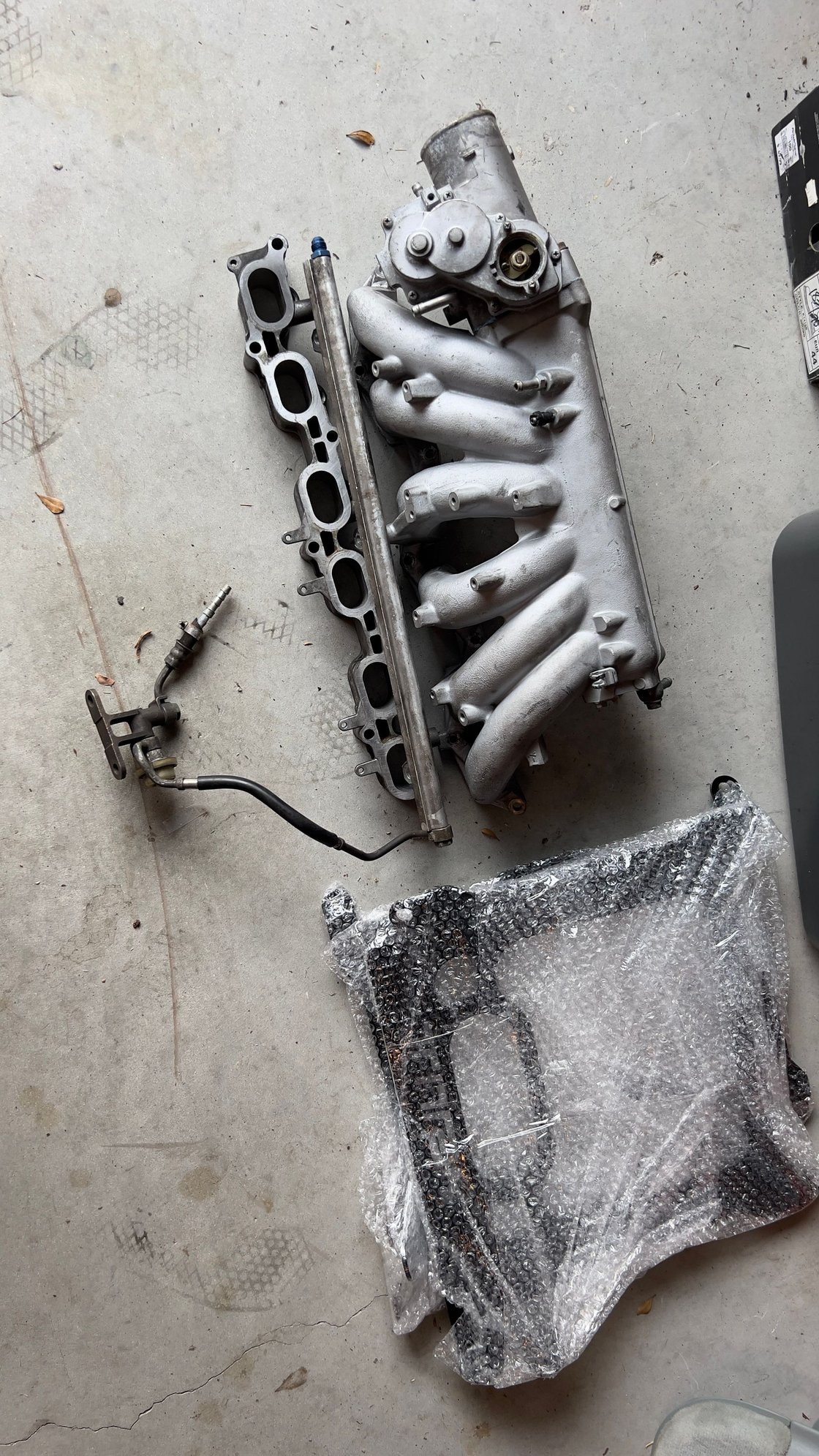

I picked up a stock 1JZ VVTi intake manifold for $250 today! Definitely going to run this instead of the aftermarket intake my 1jz has now. Will be much easier to fit intercooler piping since I plan on running the Greddy LS intercooler kit for a Soarer. Still undecided on what turbo setup I’m going to run.
Also in the photo is the Titan Motorsports Supra seat brackets I bought. I’m going to run those and Braum seats because my stock seats are not in great shape and my head is practically touching the ceiling in this car. But the seats are backordered until August unfortunately. But excited to get them in!

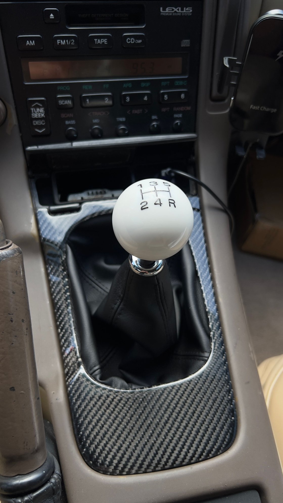

i have always been a fan of these old school muscle car shift ***** and had bought one for my S13 project in high school 10yrs ago, realized the SC uses the same thread pitch so I bought another one for the sake of nostalgia. Might not be everyone’s cup of tea but I enjoy it

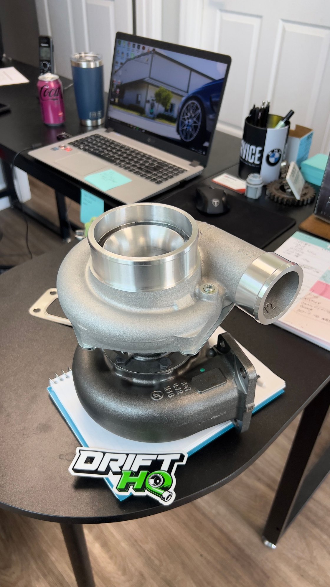

Sooooooo my buddies over at DriftHQ had a huge sale on Garrett turbos so i decided to grab one of the Club Line turbos for the 1jz. It’s a GBC35-700 .82AR with a T3 housing, I’m super stoked on it! Got a great deal on it and will be perfect for the 1jz

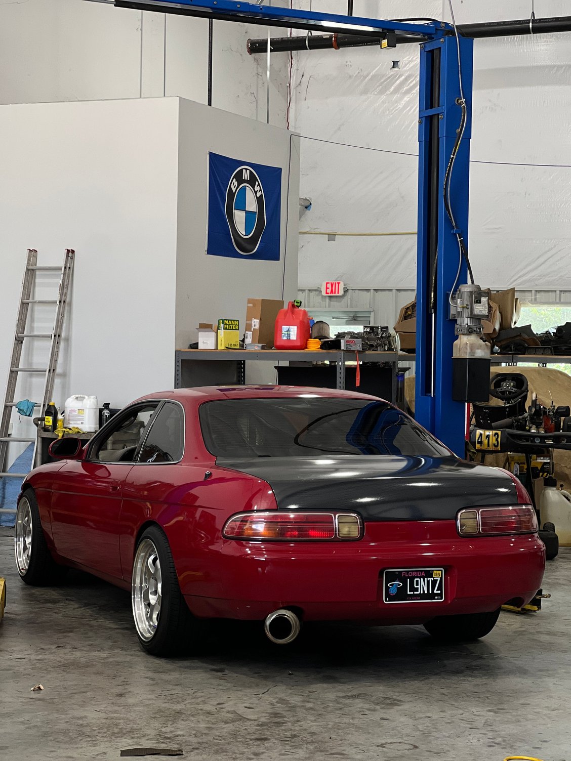

Another update, got the car fully retinted including front windshield and got my HIC roof wing on, i like it a lot!
