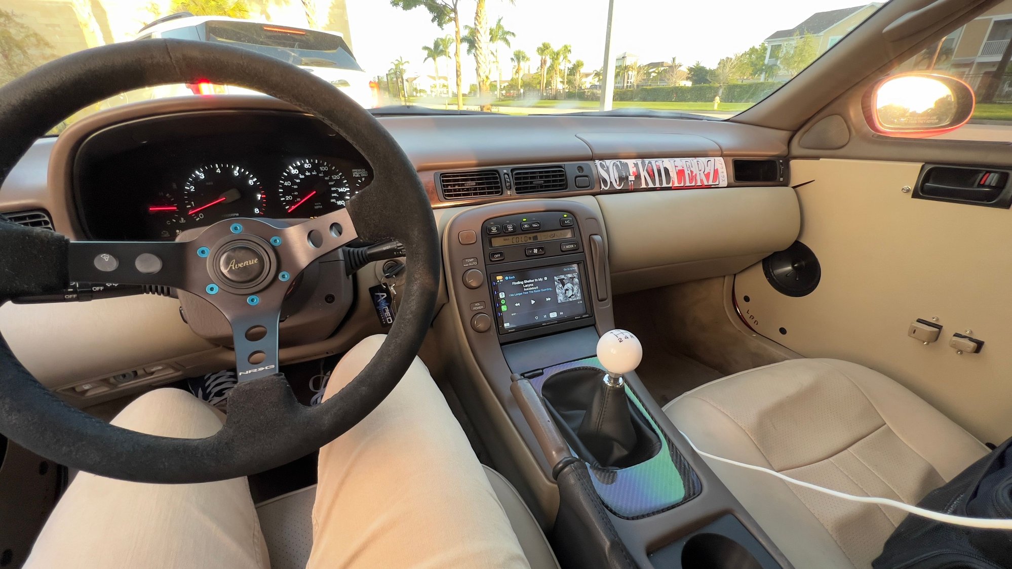

Not me matching the interior >.>
Figured I’d upload a current interior picture, pretty happy with its current state. Think I’ll probably get a different steering wheel at some point though

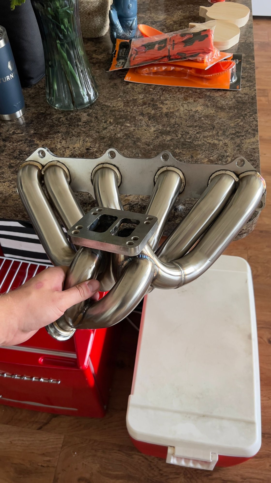

I also got my turbo manifold in the mail today, had a bit of a delay in shipping but I’m very excited to get it on the engine. It’s pretty nice quality for a reasonable price

Great pictures and congratulations on the new manifold.

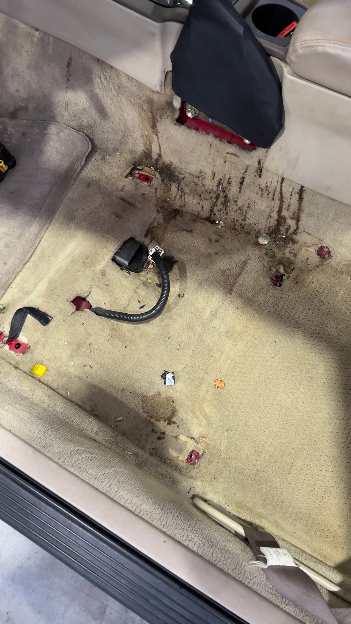

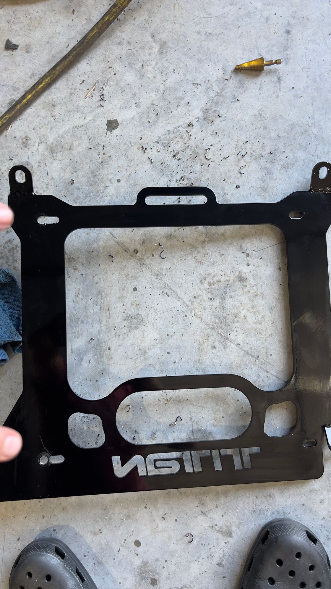

I finally got my Braum seats in. They were backordered and came in on Thursday. Got them mounted over the weekend. I purchased Titan Motorsports MK4 Supra seat brackets because they’re the lowest on the market along with Bride. I had to drill a couple of holes in them to mount up the seat rails (which came with the Braum seats) but nothing difficult at all. My head was almost touching the headliner with the stock seats and now im practically sitting on the floor. Much better seating position for me and getting rid of the heavy stock seats was great.
unfortunately it also shows how dirty the carpet is now LOL I may put black carpet in the car at some point.

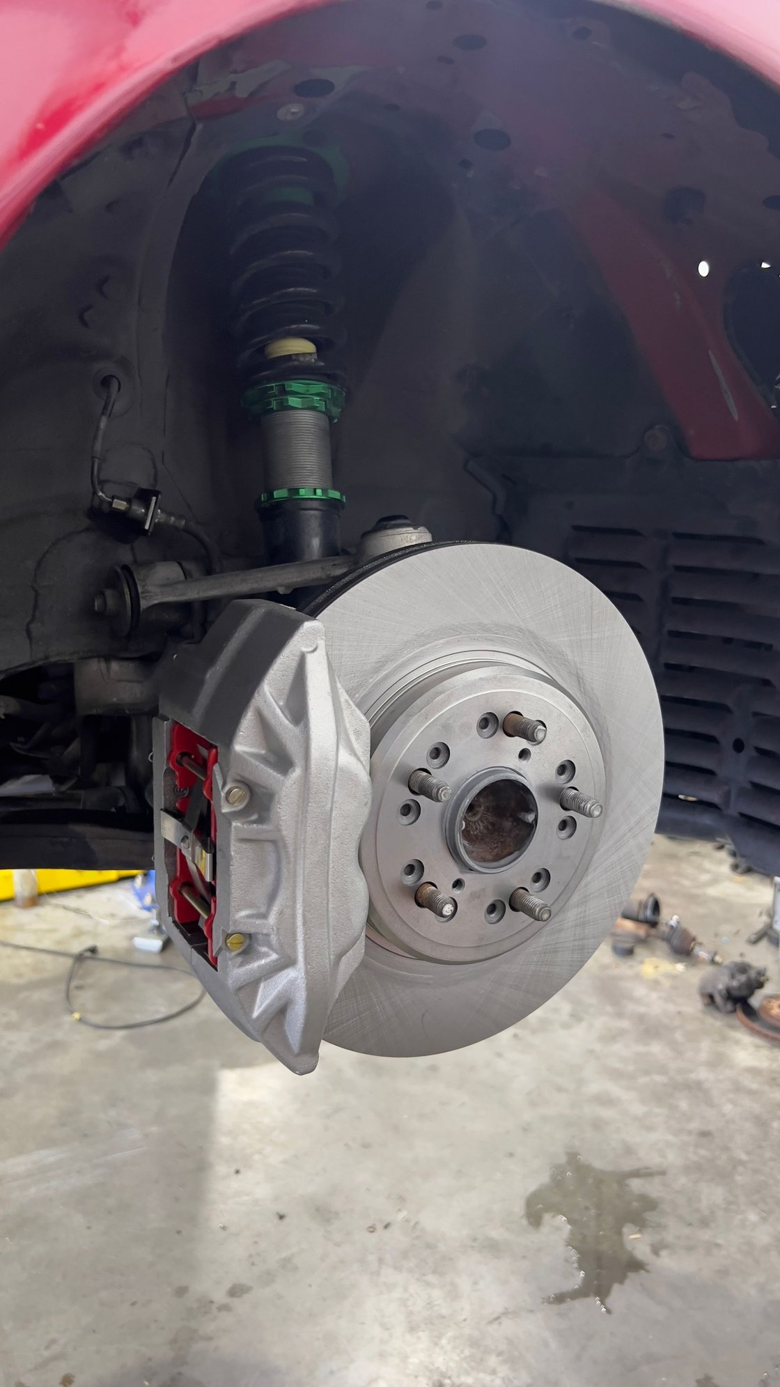

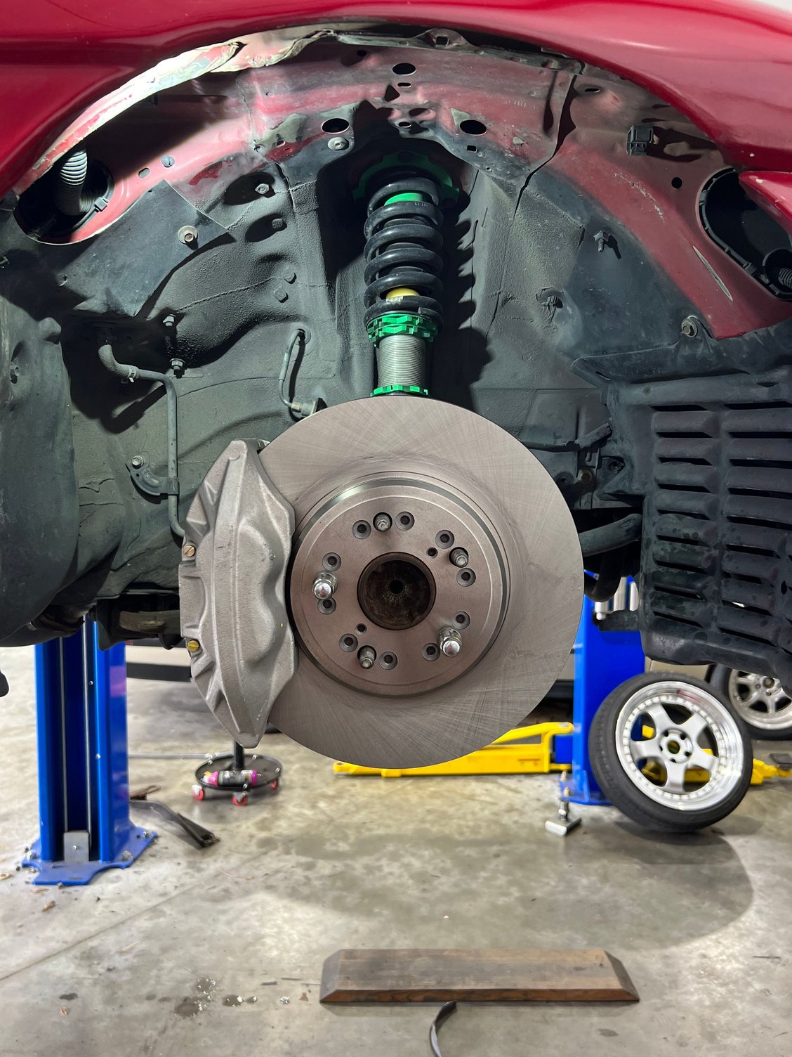

I finally have something to post here! I finally put my LS400 front brakes on! I still need to get stainless lines though, I got LS400 ones and they were way too short. I’m going to find some good SC ones because mine aren’t in great shape. I do plan on upgrading the rears too so I don’t get a nose dive when hitting the brakes as I do now. But the stopping power is significantly better, I will say. The calipers close me $87/ea rebuilt by Raybestos on Rockauto. I got EBC Red pads and OEM LS400 rotors. Had to trim some acres material from the caliper, maybe 1/4” worth of extra webbing material that was in the way of it lining up but not difficult. Had to trim most of the dust shield off with a cut off wheel

Now you have a safer car. Great looking installation. Supra Mk IV TT rear calipers are going to be your best bet for the rear. They just bolt on with out any problems , just some trimming on the backing plate. Another option is to use your rear calipers with rotors and caliper brackets from a SC400. That gives you a bigger rotor for the caliper to grab on to. Stock brake lines work. This is very inexpensive compared to the TT calipers and rotors. Also Lexus installed these 400 brakes on the 300 in '98 or '99 on. Someone correct me on this. Good luck with 300.
