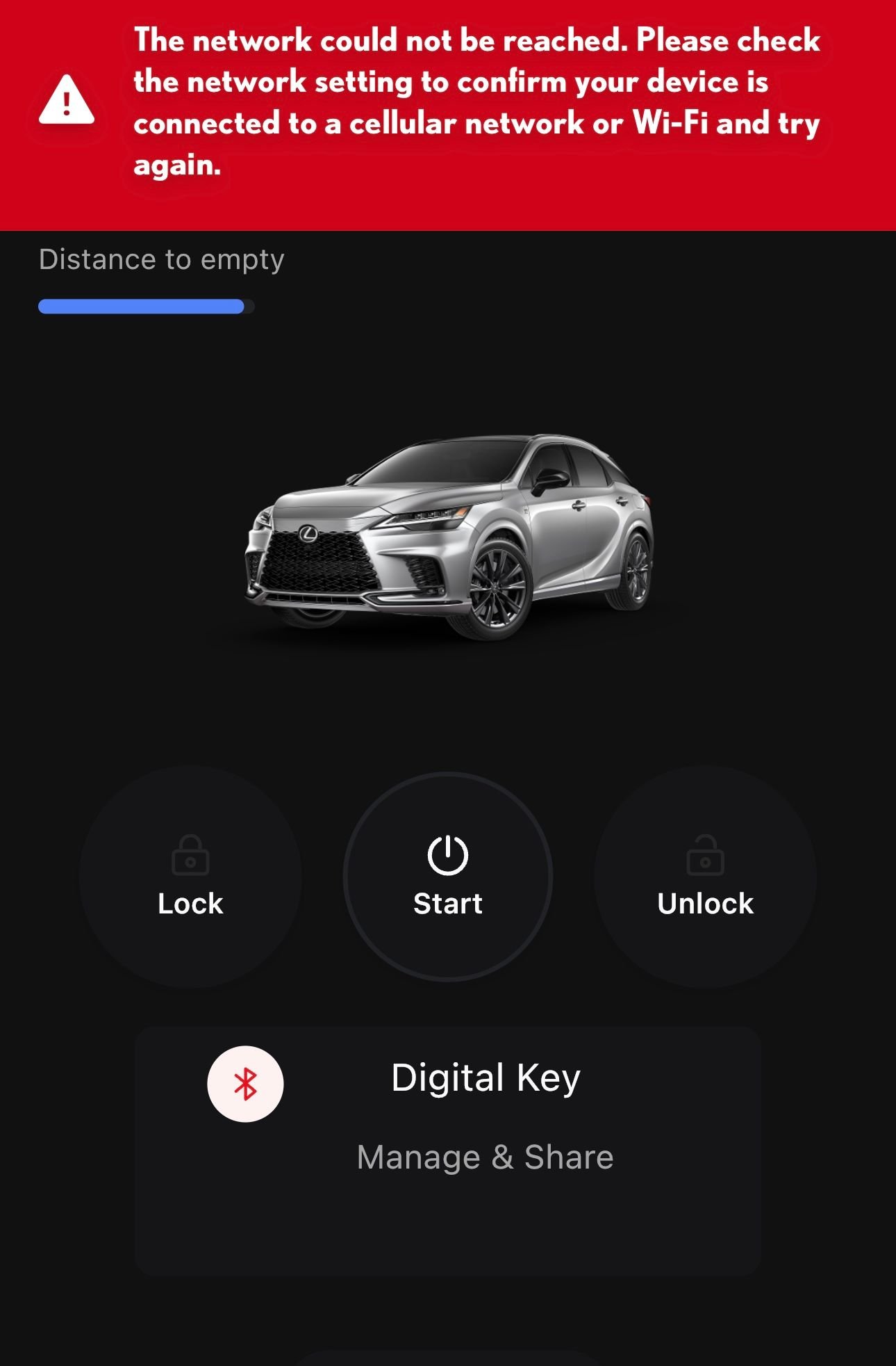

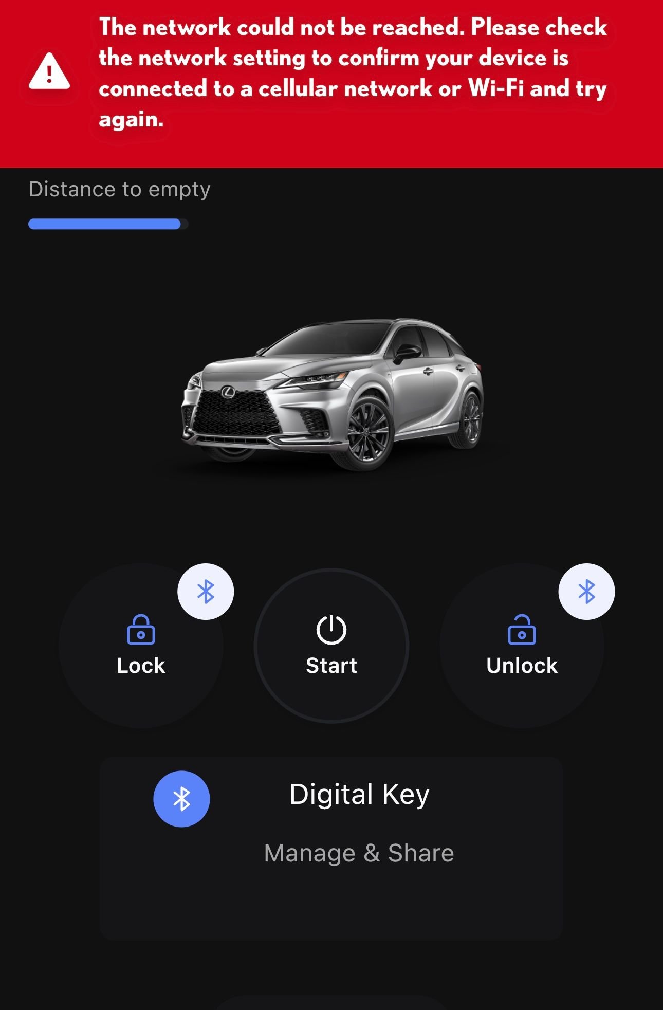

Originally Posted by alextv
I hope this is the way it works as my dealer told me it has to have data connectivity also and looking at what Lexus requirements are for it to work seem to require data also and being within 10 meters of car for bluetooth. It makes sense for it to not require data but heck this is about Lexus making money.
I just tested it and it does work without Wi-Fi or mobile data. You only need Bluetooth once it’s provisioned. Now I don’t know how often it needs to “phone home” to refresh a token…. So this may not work over several days of no data. But it seems resilient against intermittent loss of data such as areas of poor cell coverage.
Approximately 100 feet from my vehicle, notice no data and app can’t see vehicle over Bluetooth:
And when I get closer to the vehicle it sees it over Bluetooth:
When I grabbed the door handle it unlocked and engine started when I pushed the button.
I did this test without having a key fob on me.
