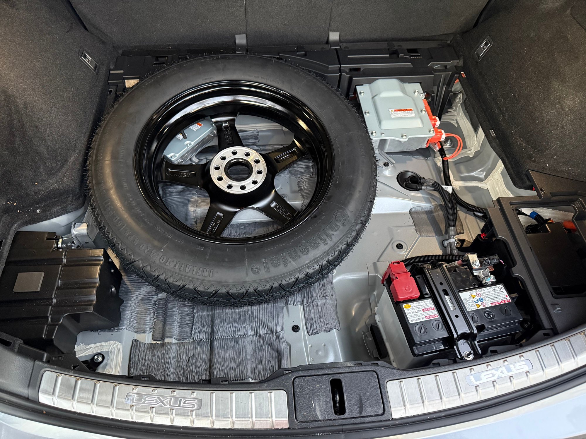

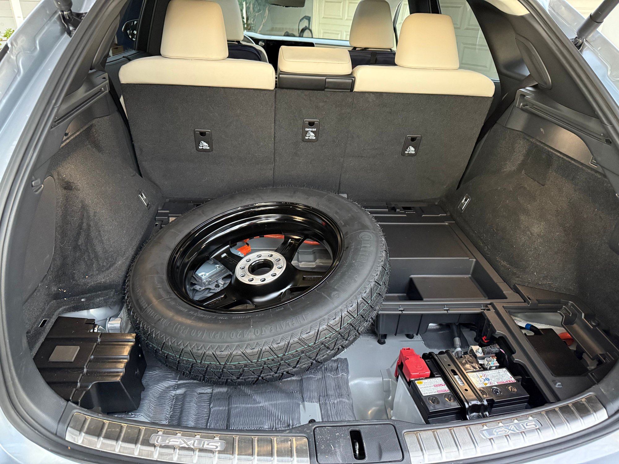

Unfortunately, I can't simply drop a full-size spare into any existing space in the back of the car. With most of the panels and boxes removed, it sticks up on the front-right quadrant.
With all of the panels and boxes removed, it lies flat -- but is resting right on what I believe is one high-voltage part (front-left quadrant), and right against another (front-right quadrant). This seems suboptimal, but it is low enough that I can put the back cover in place and it's only elevated about ½".

However, I find it highly encouraging that you were able to position it flat after removing all the panels, and sub-optimal points you point out - but I would like to glean whether those are really sub-optimal, in terms of any risk to the HV components (on this note, people can please not comment with speculation, and only comment with near-certain or certain knowledge).

I'd be concerned about "...I can put the back cover in place and it's only elevated about ½". "
It looks (can't be sure from the photo) like the tire weight really is resting on the box in the upper left corner, and anything you then add to the cargo area would be transferring more weight to the box.
Factor in shock/vibration from actually driving it (normal road stuff), which would transfer to the box as impacts, and it might lead to a box warping/failure.

Yes, I think this is a great direction to look - just deflate the Modern Spare (or even the Lexus spare) enough so that it fits even better than you already have in the second picture - without pressing against the HV parts. If that works well, that would be THE solution, methinks. In any case, at least I and perhaps most people carry a portable inflator - so that solves the problem.

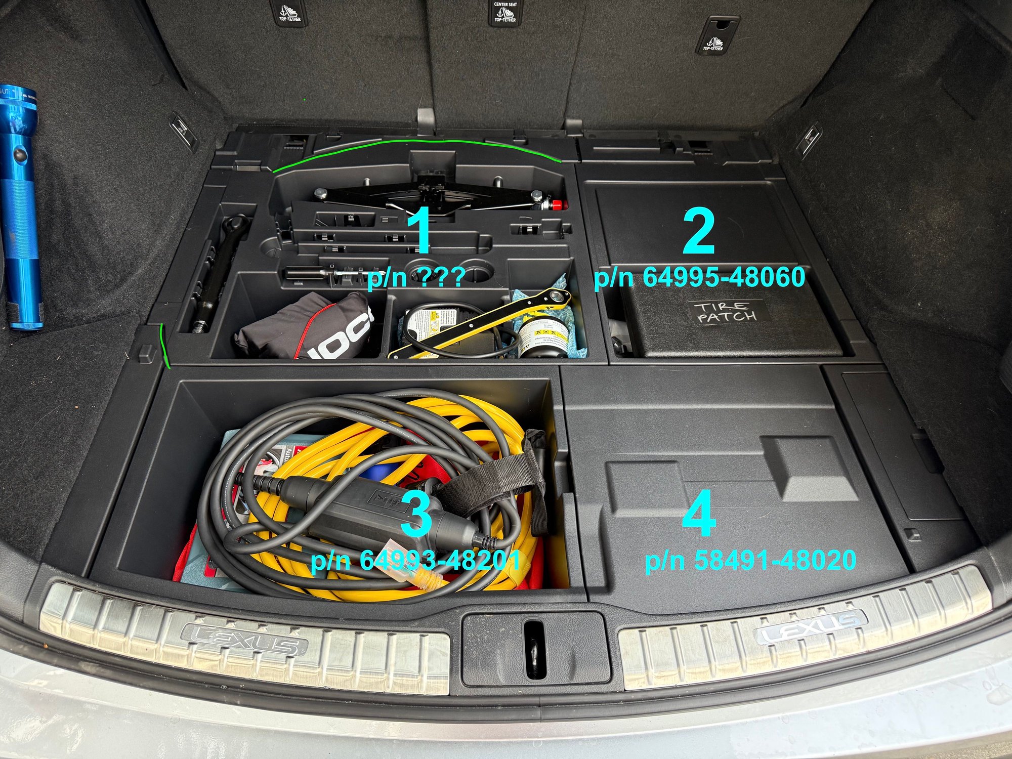

Here are the panels and components that need to be worked around somehow. The part numbers are imprinted on the underside of each. (Note also the highlighted green curves, which seem to accommodate the placement of a spare.)

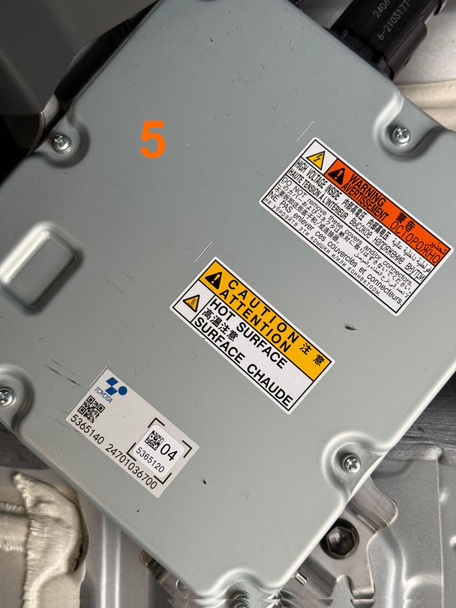

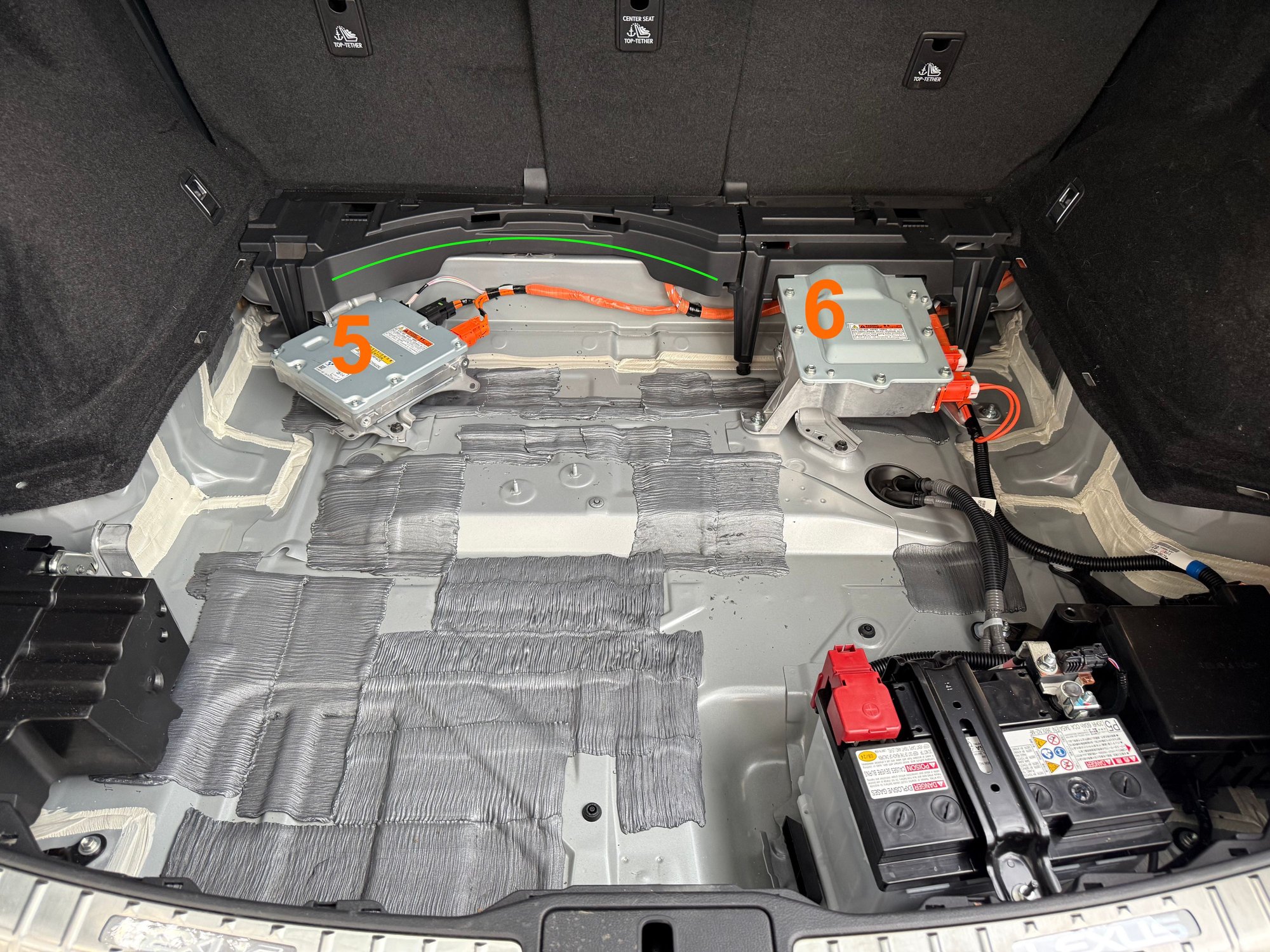

...and here are the two high-voltage components that I do not want to mess with, followed by their close-ups.

Either way, I'm now leaning toward my original Solution #3, which would entail some kind of spacer/shield between the tire and high-voltage component 5, and replacement panels & compartments from Lexus that I can jigsaw & dremel as much as I want until the tire fits. This would mean the removal of section 1 and the trimming of sections 2, 3, and 4 (and possibly a notch from the small panel under the blue MagLight).

It appears that the HV component numbered 5 is the real problem for placing the ModernSpare on top of. Aside from the minimal reduction of size on deflating.
