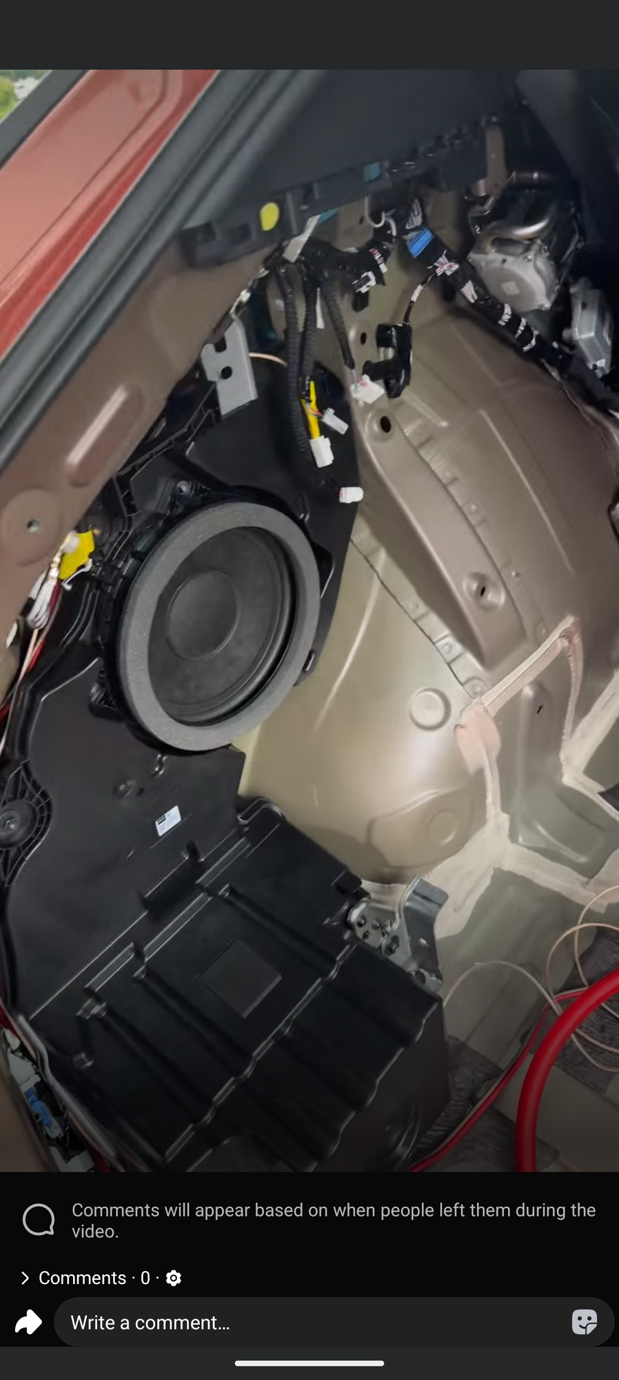

Found these photos on face book
Intriguing. I wonder what they did with the HV component at forward-left. I mean, besides detaching the wires...
They were replacing the mark Levinson sub with a full size sub, but I was trying to point out the sub assembly if any one had thoughts of removing the sub to fit a modern spare tire. The bolts in the sub floor are different with no way to mount the tire.

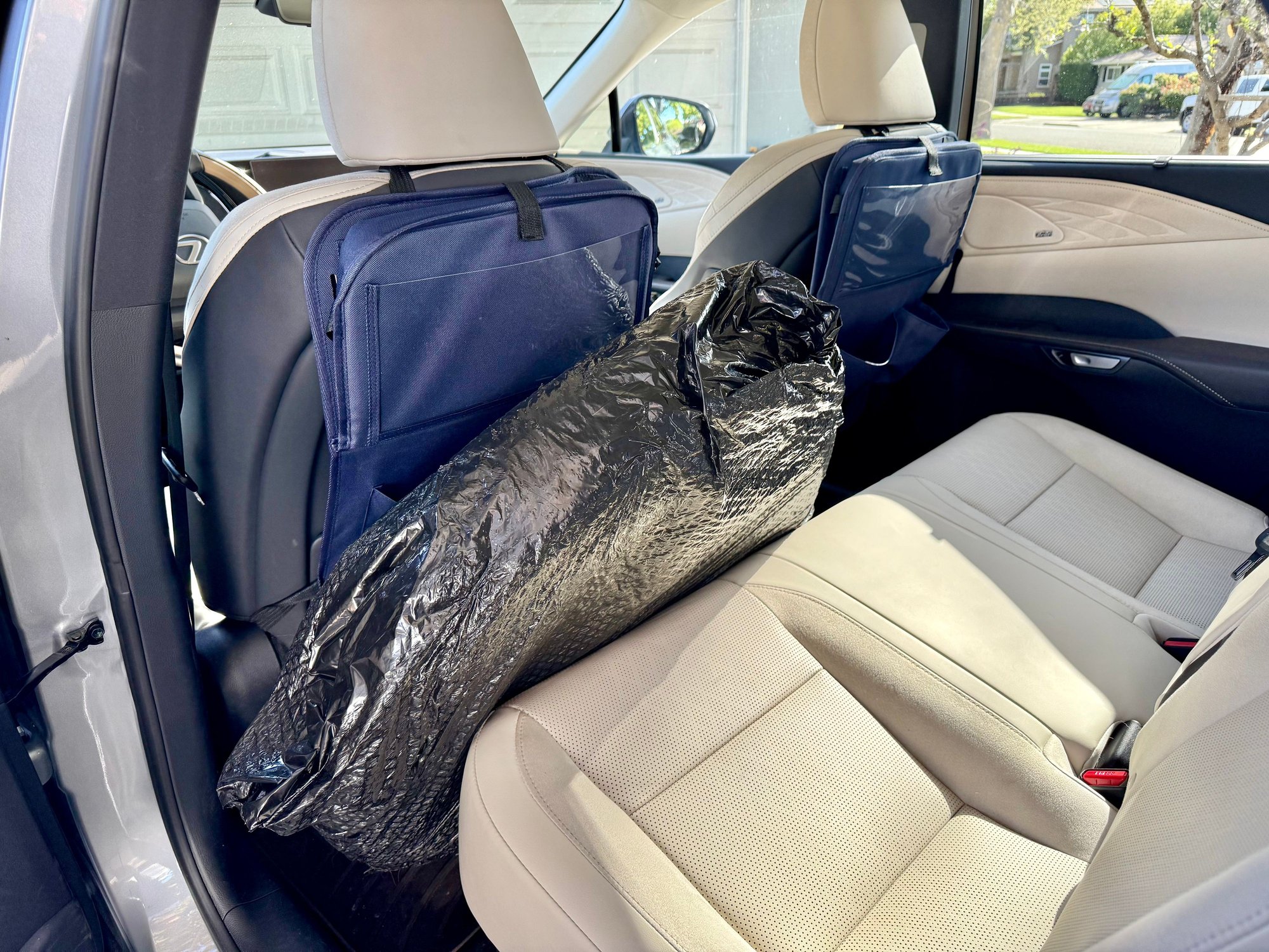

Question for those with the ModernSpare. I was thinking about picking one up with the carrying bag for long road trips. Would it fit on the floorboard behind one of the front seats?
Lying flat, not a chance. It's nearly as big as the stock tire. Standing upright, yes. Here it is behind my driver's seat (in a garbage bag, for some reason -- I can't recall why I took it it out of its carrying case).
Thank you so much for taking the time to snap that pic! Much appreciated.
So the question for me is should I do that or put it in the back and put some luggage on the back seat?

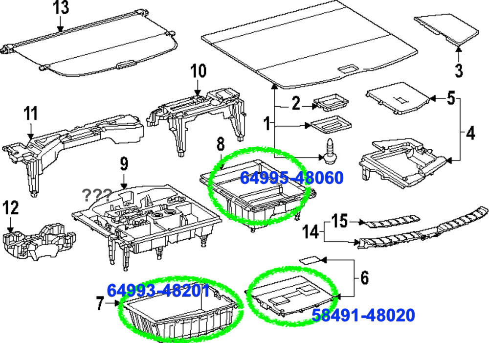

I just ordered all three parts that I will need -- the Right-Forward box (64995-48060), the Left-Rear box (64993-48201), and the Battery Cover (58491-48020) from Tom Wood Lexus ($5 cheaper than local by avoiding sales tax). Arguably I don't need to buy these parts, but I want to keep unaltered, stock backups on hand in case I really screw up when Dremeling-out the tire cavity and they become too hard to find down the road (pun intended).
The thickness of the Modern Spare while lying flat may still be ½" - ¾" too much, but if so, I can 3D-Print whatever spacers I need to elevate all the boxes evenly (if necessary to keep the entire floor level).
As for that high-voltage component at forward-left, I will measure the space between it and the bottom of the box above it and 3D-Print something that maintains that space even with the stock box removed and a spare tire in its place.
