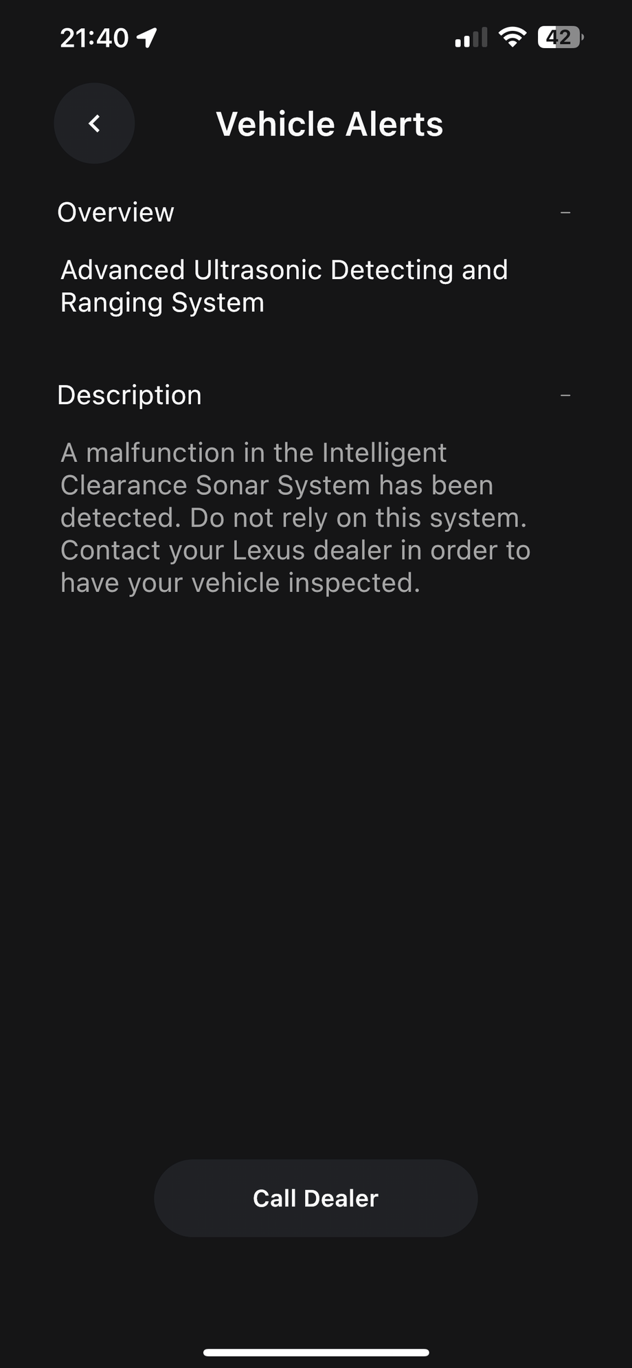

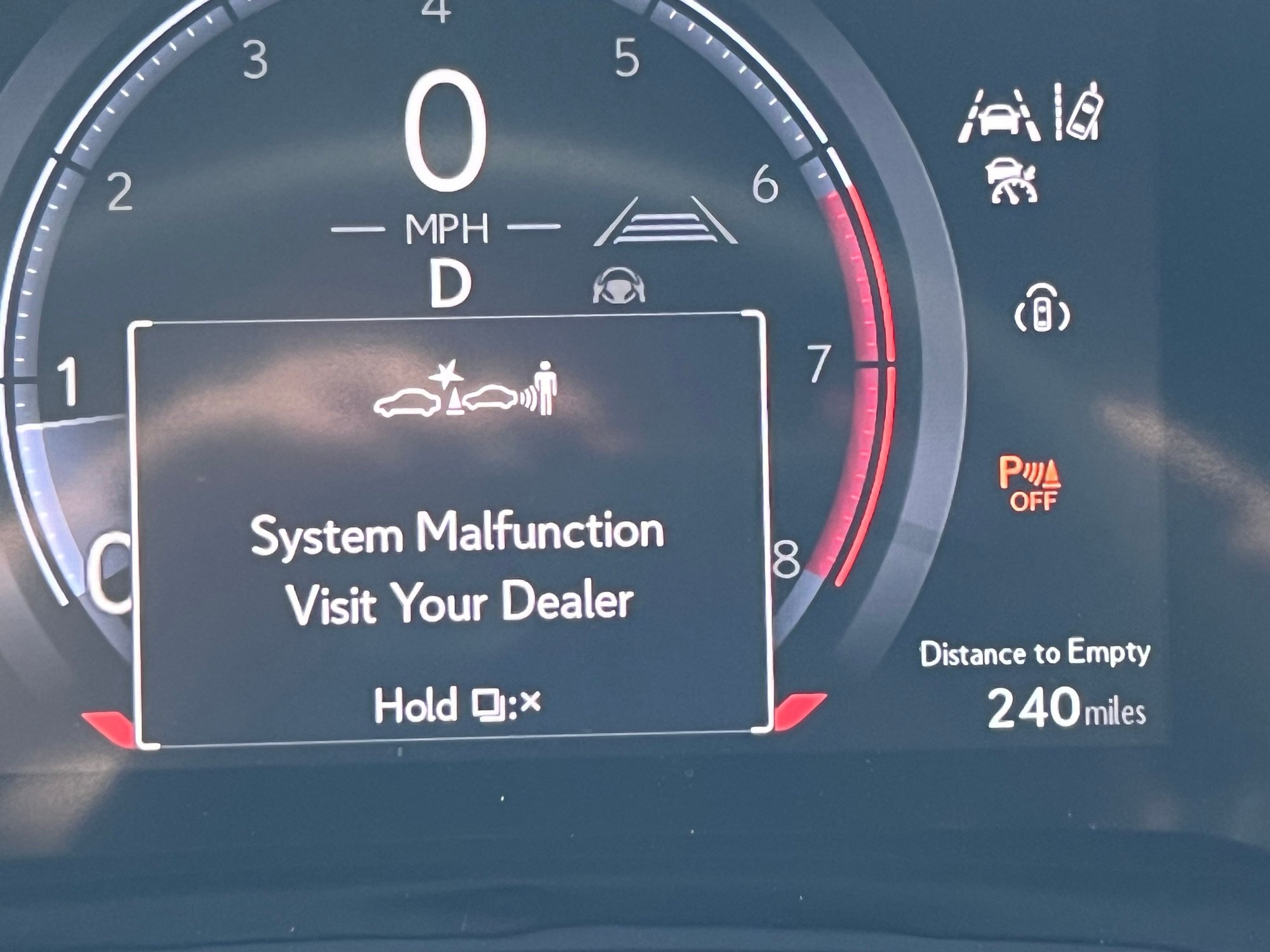

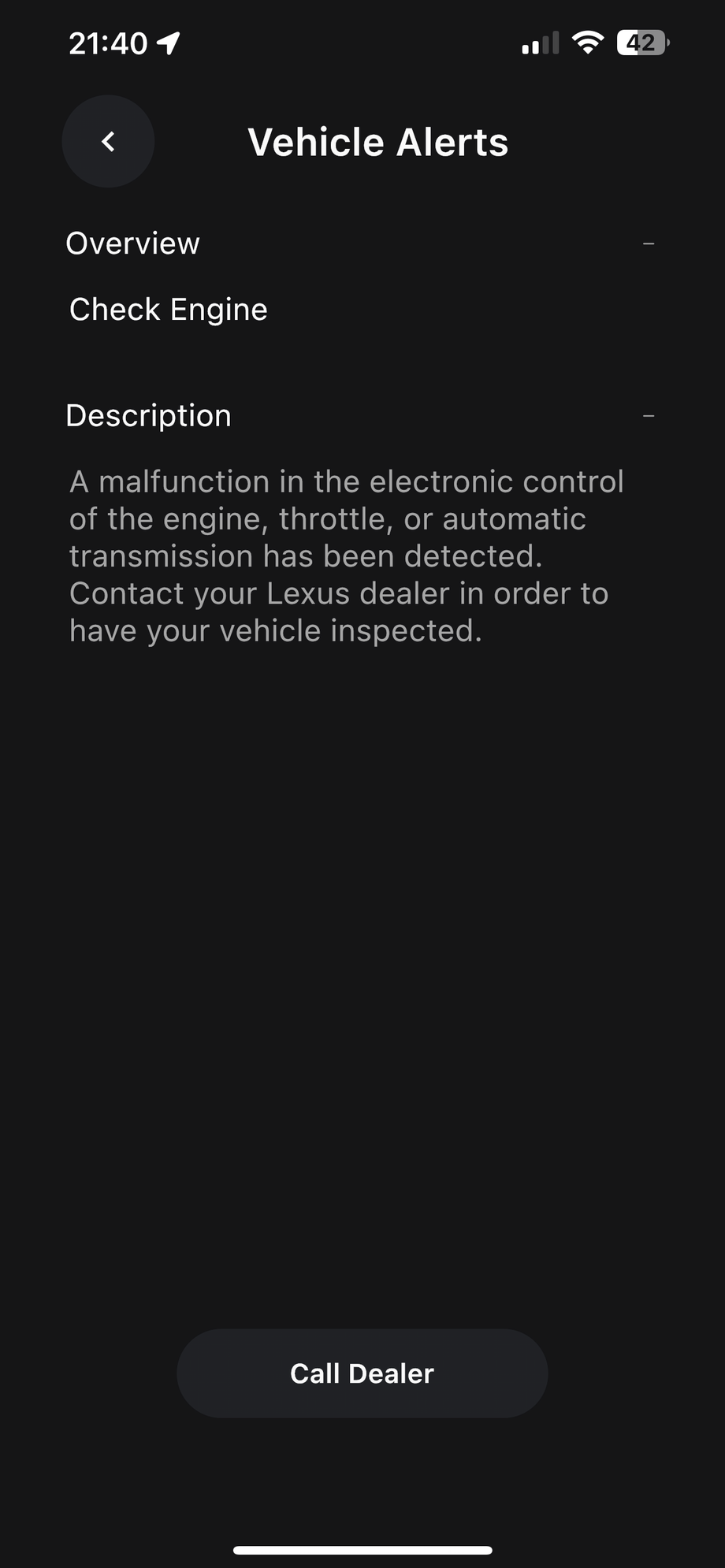

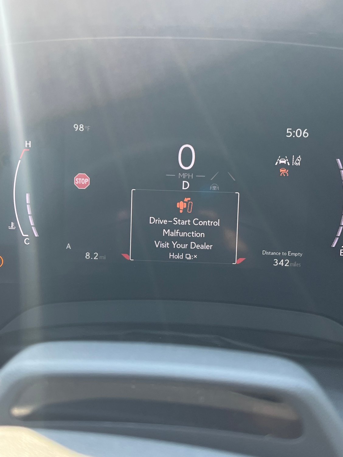

Less than a week and 183 miles on my brand new Iridium RX350 Luxury, I have the following problems:
- Side mirror doesn’t dim
- Seat belt tensioner doesn’t retract
- Numerous error messages:
Advanced Ultrasonic Detecting and Ranging System
Drive-Start Control System
Check Engine
Are these a fluke or is quality going down? I’m a long time new Toyota and Lexus buyer and have never had issues with a brand new car.

Nothing like those reported here before. The first one sounds like one of the sensors is bad or was hit by a stone, etc. The second one is more concerning, does the engine start at all or does it have to be towed to the dealer?

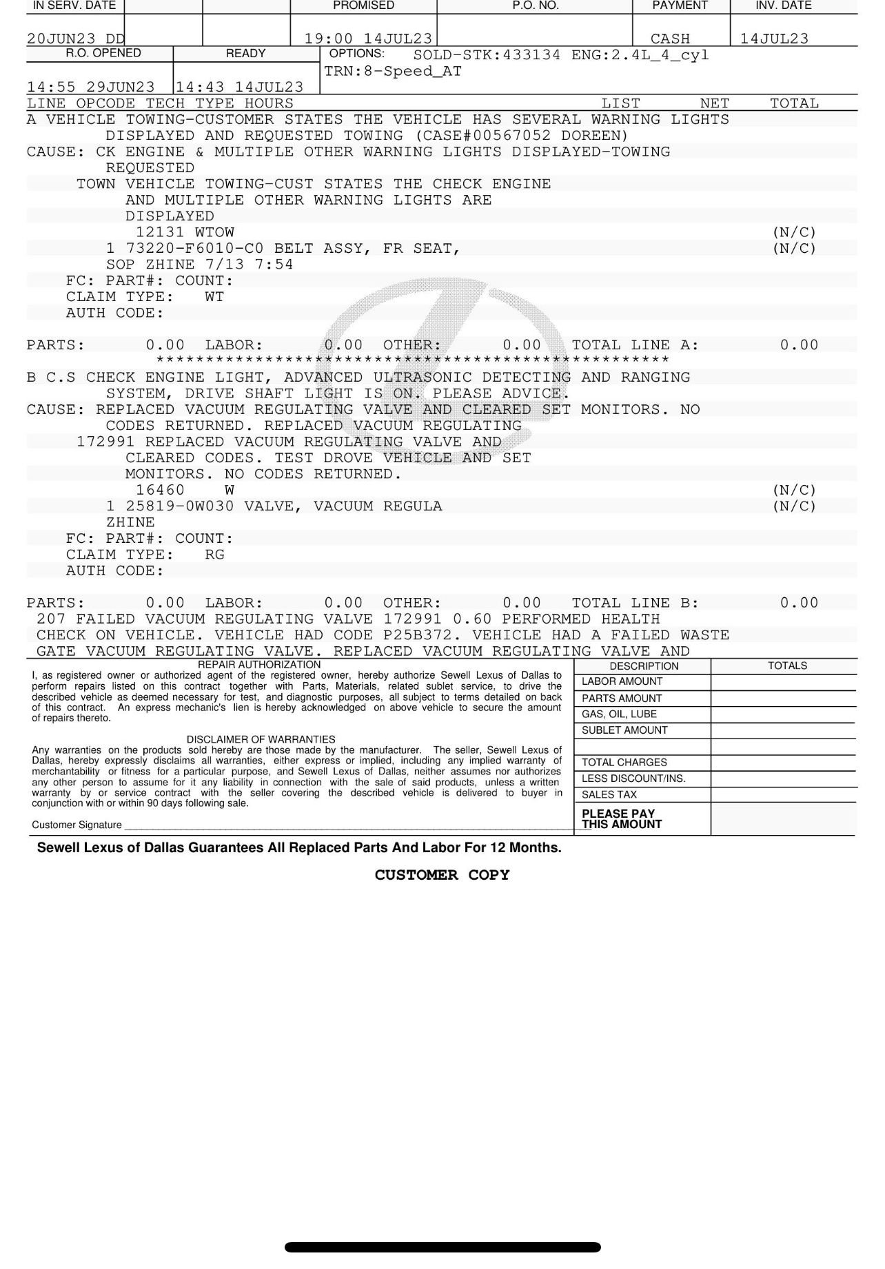

Originally Posted by blynch
We are having same engine code issues. They are on a second attempt to repair. Do you have any updates on what they have done to try and reslove your issue?
Here is the receipt detailing the issues. No problems with this since.
