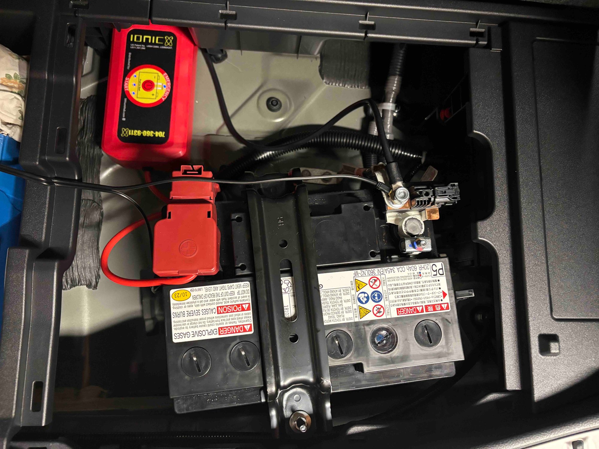

I have the Ionic Emergency Start and a Bluetooth battery monitor working together. The Emergency Start app only monitors the Emergency Start so is not redundant to a battery monitor.

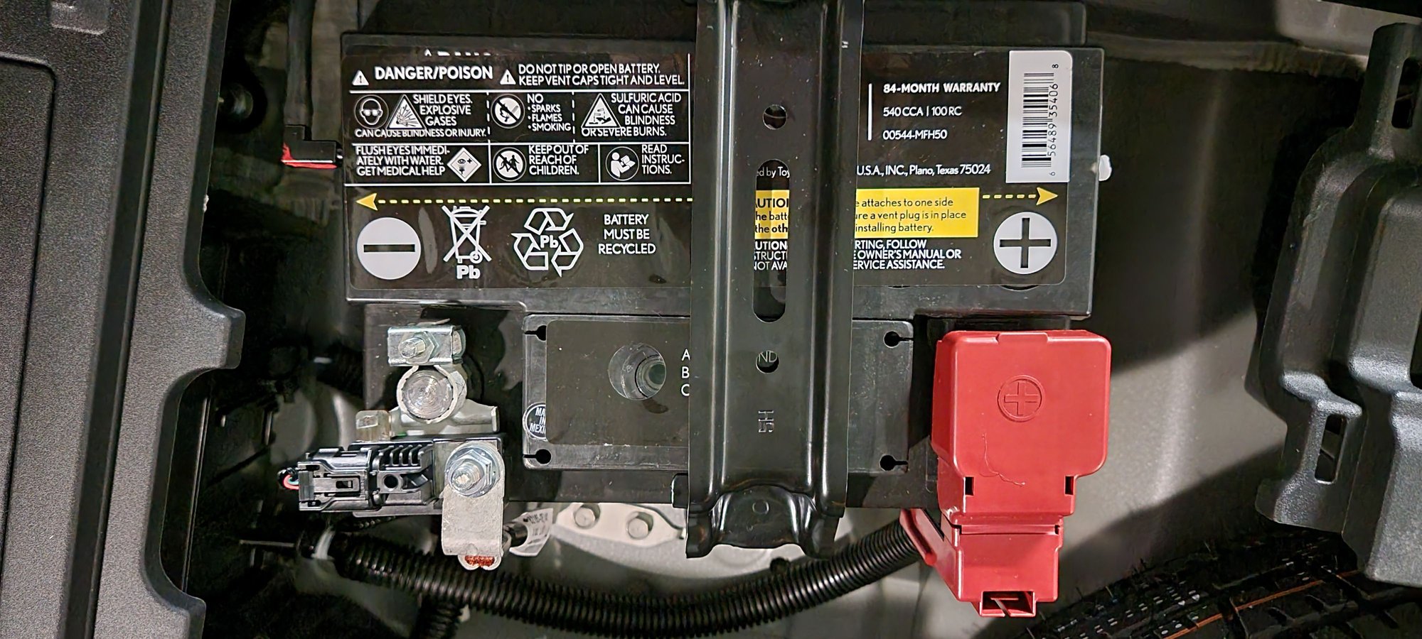

I have a 2023 RX350h and finally had my battery replaced under warranty by the dealership. The service advisor told me it's very common, and very indirectly told me it's my fault the battery was having these problems. Apparently the culprit was infrequent driving and mostly very short trips (a mile or two). They kept the car for a few days to monitor the battery and then got approval from Lexus to replace it under warranty.
This is the replacement battery --
The new battery is holding a charge much better than the original (which had gone totally dead five times). I'm now using a bluetooth battery monitor to watch the voltage. After a 180 mile trip that charged the battery 12.05V to about 12.85V, the battery slowly fell to 11.96V 42 days later. A 14 mile trip then charged it to about 12.5V, and after 9 days has dropped to about 12.05V. Once I charged the battery in Ready mode for about 20 minutes which took the voltage from 12.15V to 12.65V, and it was back to 12.13V just four days later. The original battery was going dead after 5-10 days even after a full charge.
My experience with the original battery prompted me to buy a Schumacher SL1611 jump starter. I also know from my experience with the original battery that I shouldn't open the rear hatch when the battery is low as the hatch will open but the battery will be drained enough from that to prevent the car from starting. I've also uninstalled the app so the car doesn't periodically try to phone home with status updates (as suggested by the service advisor).
