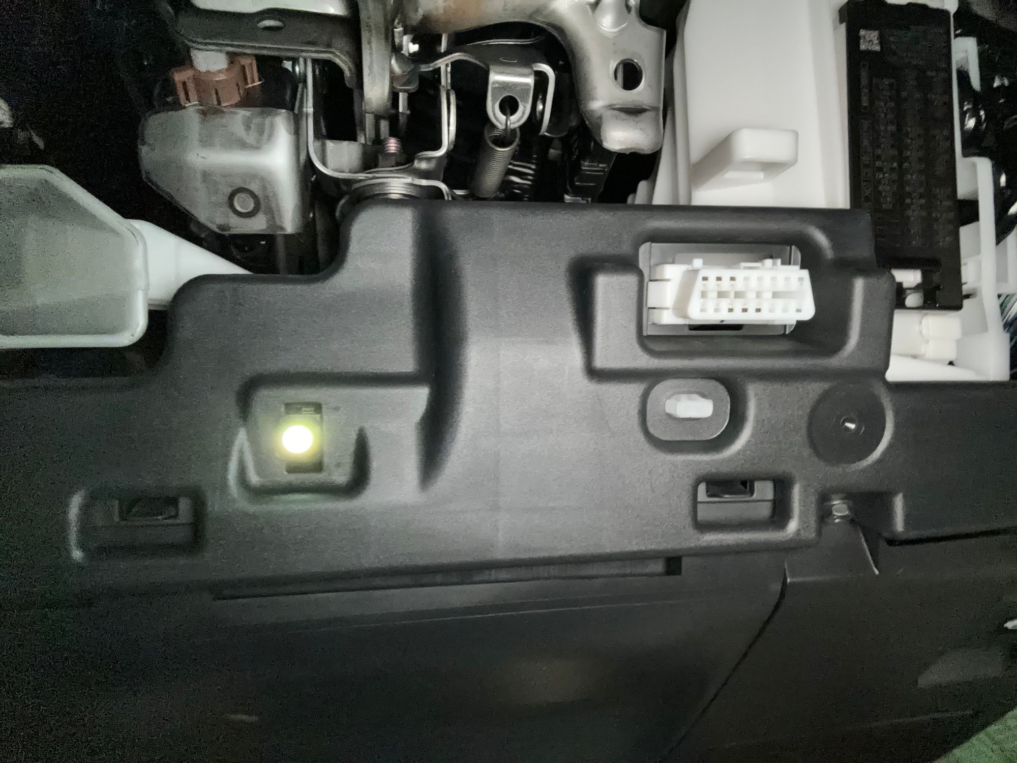

Old Jun 14, 2024 | 05:44 PM
  #443
wrinkle's Avatar
wrinkle
Joined: Nov 2023
Posts: 979
Likes: 646
Originally Posted by John89
I know this may be totally unrelated, but I was watching you tube and they had all these Toyotas which all had small drain. If the owner didn't drive them for 3 weeks battery would be almost dead. Further research showed there was tracker installed behind the OBL connection and they were assuming it was either by Toyota, Transporter or even possibility the dealer. The device they found people put in comments is some type of GPS tracker, it was piggy backed against the OBL port. In comments people wrote they checked and some actually found same tracker connected to there OBL. They were not sure if Toyota was using it for some kind inventory tracking or maybe theft prior to selling the car, or possible Lojack component dealer would put in and not remove.
Here one of the videos very interesting, also there a lot of post on Toyota boards as well. I
https://www.youtube.com/watch?v=7UkBD_BrpRk
This is great information to have. Below is the picture of what my OBDII port looks like, and there is a LED that is lit greenish-blue and ON when the car door is opened without having turned on accessory mode or Ready mode to on.
Does this look what a stock (i.e. without dealer having messed with OBDII port) to those with a 5th Gen RX, preferably a 450H+ ? Does this LED attachment look normal ?
I haven't opened up the plastic attachment yet, so looking to compare with others first. The port, when insert my Bluedriver dongle, is NOT firm, but the entire assembly is not firmly attached at one end, so it doesn't look like the squishiness being talked about in the video (?).
