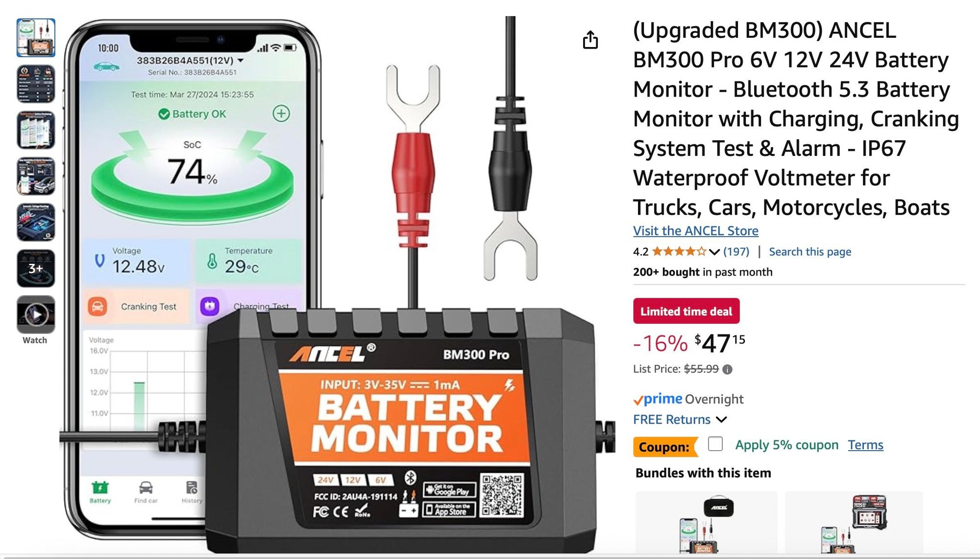

Thanks for the quick reply.
I was wondering about the fact that the hatch was open and I had my fob in my pocket. Also, will the voltage go back up after shutting the hatch and hiding the key or when it goes down it is down?
I think I am going to have to invest in a bluetooth battery monitor. Is this the exact one you guys recommend?
Amazon Amazon
Old Jun 11, 2025 | 09:57 AM
  #1225
WellsB's Avatar
WellsB
Joined: Oct 2023
Posts: 1,292
Likes: 1,077
That's the battery monitor i have and like.
I always give it about an hour to recover from being open.

@WellsB Since I have your attention....
What voltage level do you set your BM300 to alert you?

I bought an Ancel BM200. Would there be any difference using the BM300 or BM300 Pro instead? I liked the smaller form factor and we don't need weather proofing for the hatchback area.
Old Jun 11, 2025 | 08:27 PM
  #1229
WellsB's Avatar
WellsB
Joined: Oct 2023
Posts: 1,292
Likes: 1,077
I see conflicting information about the BM200 vs 300 vs 300 Pro. I went with the pro because it could monitor multiple vehicles from the same app, but it looks like the BM200 can do that too. It looks like the BM200 was recently updated though so might have more features than before.
30% and 50%

Based on Ancel's specs, https://www.ancel.com/products/ancel...0284ac40&_ss=r it looks like the BM200 is the way to go. It is $33 CAD on Amazon.
