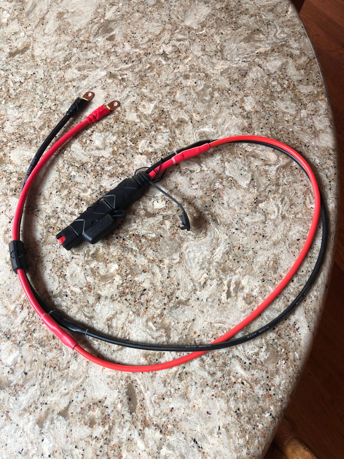

Quote: I recently found a handy cable produced by NOCO for those of you using NOCO chargers and jump starters for your Lexus hybrid and plug-in hybrid. These are a heavier cable to use with the jump starter, with an adapter on the end which can be used with a NOCO charger. The car can be jump started or charged directly from the cargo area, as opposed to going under the hood. Unfortunately, the cables are not all that long and would have to be lengthened a bit to make them accessible behind the rear seats. If only they had manufactured these with longer cables. Still, they could be useful. https://www.amazon.com/dp/B071F36LXZ...fed_asin_title
This one has been lengthened with 8 AWG sections.
I bought exact same eyelet cable. Hooked it up to the battery and tucked it under the rear trunk lid. There’s a little opening from the battery to the storage cubby underneath the trunk lid. Works great. Never had to use it though. 🤷🏻‍♂️
Reply 1

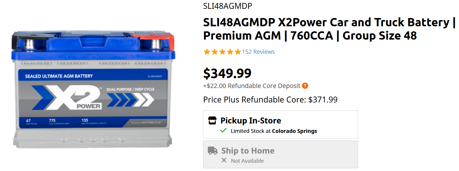

This is getting a be a very big thread, and I'll also contribute with our latest issue. Our battery died for the second time last night in our 2023 Rx350h. When our battery dies, and we attempt to start the car, the car enters a mode where it flashes the lights on the console and the headlights randomly and quickly turn on and off. I have not found a way to stop this from happening until it completely drains the battery, which can damage the battery. Pressing the Start/Stop button does nothing. We don't have phone as a key, the ACC was not on, and my battery monitor showed that it slowly drained over three days that we weren't driving it. Granted, it wasn't at a high level after we drove it last because the battery never charged beyond a weak level.
Once the car completely drains the battery, the doors don't open without using the physical key and manual door release. The hatch won't open, so I had to google how to manually release the hatch to open it. Our charger won't charge the battery because the battery is at such a low state that the charger thinks the battery is damaged.
Rather than getting the battery replaced under warranty and possibly getting another garbage battery, I replaced it with a larger battery. The battery tray is actually large enough to accommodate a size 48 battery if you remove the plastic stop in the battery tray that holds the smaller OEM battery. I purchased the one shown below, which is rated at 67 AH as opposed to 60 AH for the OEM battery. I'll be monitoring it closely to make sure the car is charging this new battery properly, but it looks good so far.
