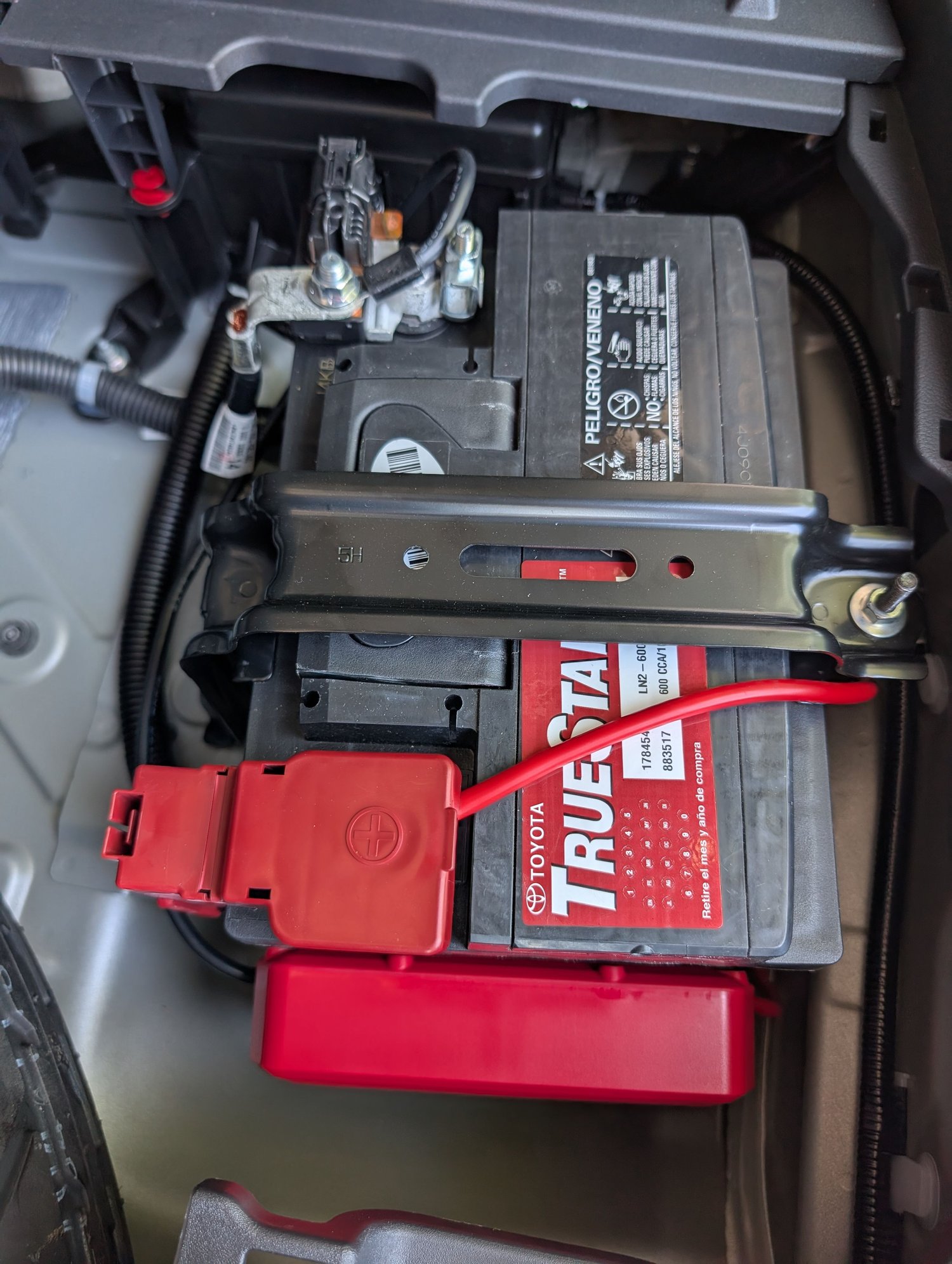

Hi guys. After the November 2024 dead battery event, last week I installed the Ionic Emergency Start battery on my 2024 RX350h. Pretty easy. As soon as I loosened the nuts on the battery the power went out. Fixed the Ionic cables, tightened everything up and put the velcro sticker on the left side of the Lexus battery. The power liftgate would not close so I did it manually. Also, the side rear view mirrors would not automatically fold. I locked the SUV and opened it up again, pressed the auto folding switch on the drivers side door and everything was back to normal. The power liftgate was working again. Also, I ran the App and could see the battery there. The Ionic users manual states that the battery bluetooth will disable in 30 days. Does this mean in 30 days I should short press the button on the red battery?
I did not need to interrupt the 12 V battery connection to the car, by using separate nuts I bought, with which I tightened the ES to the battery/car leads on top of the the original/factory leads. This way, there always flexibility to detach the ES if one needs to, without disturbing the car's 12 V circuit with the Lexus battery - though one has to buy the couple nuts from Home Depot or similar hardware store.
The second question is already answered once in the thread: The car wakes up and resets the ES everytime it starts up to READY mode, so, as long as one starts the car at least once every 60 - 90 days, one doesn't have to do anything with the ES. If the Bluetooth connection to the phone is dead because one doesn't start the car AT ALL for 90 days, only then would one have to press the red physical button on the ES (assuming the Lexus 12 V is already dead in that situation) to activate the ES and hence start the car.
