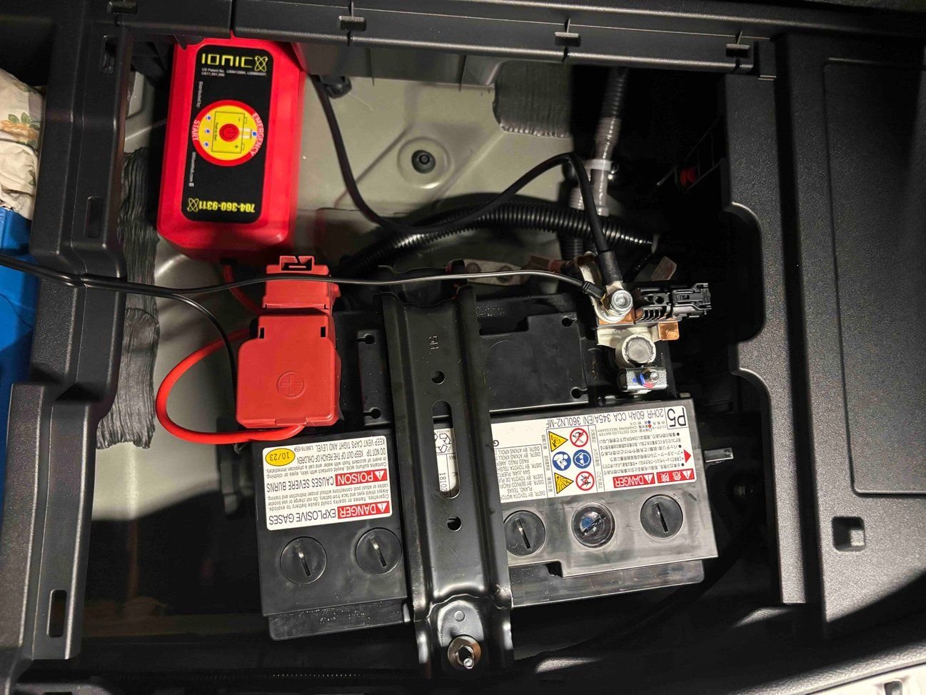

Originally Posted by Lexuscome
Installed on 2024 RX350h, used additional nuts supplied by my dealership to add to existing posts. Used zip ties to secure.
The 12V battery in the above picture looks small for a car loaded with electronics like the RX350h. I notice that the label reads "20HR 60Ah CCA 345A". Not sure what 20HR indicates, but in comparison, my previously owned 2013 Avalon Hybrid had a much physically larger Panasonic S65D26R battery that had 75Ah and 750CCA. I realize CCA is not important for a hybrid, but Ah (Amp-hours) is. The Panasonic Avalon Hybrid 12V batteries were expensive, trouble-free and lasted 7 to 10 years. Sure looks like the 12V battery in the RX350h is simply too small, likely a cost cutting move.
My 9.9 HP Mercury outboard trolling motor uses a 350 CCA battery! I have to believe that some engineer went by the book (displacement x 1.20) to get CCA and then the bean counters said they'd save $30 bucks with a smaller battery. I wonder how large a battery one could fit in that space?

The 20hr 60 A-H rating means that the battery will supply 3 amps for 20 hours before falling to 10.5v.. (60 divided by 20)
I believe that the fact that the battery is only half-charged in normal service is a much bigger deal than the nominal rating. Our 60 a-h battery is actually closer to 30 in normal service. Throw in random excessive parasitic discharge and (eventually) sulfation induced loss of capacity, and it's a recipe for dead batteries.
