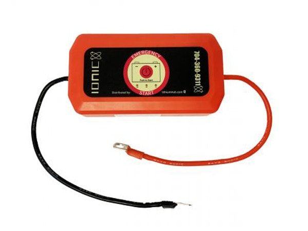

My 2024 RX350h battery is dead. Dash lights, headlights started blinking. Would not open rear cargo door. Checked my Ionic App to fire up the red battery I installed back in April and I cannot see it:
Am I doing something wrong or is the red battery dead also and is the reason it's not showing? Help!

The Ionic Bluetooth times out after 3 months. Happened to me too. It's the last sentence in the manual before the specs. I wish it was more prominent in the manual. I connect monthly now

If you do lose the bluetooth connection for the Ionic because of the elapsed time (3 months) you can press the button on the device itself to turn the unit on and it will connect to the app.

I'm following the WellsB approach, have set a monthly 15 minute calendar item to connect from the app. That's infrequent enough to not be a PITA, but often enough that if I do miss one I'll get the reminder the following month (the likelihood of multiple misses by me is low).

Roadside assistance came and used a big portable jumper on the front fusebox and ground metal engine part. Turned car on and in Ready mode without any trouble. Went to the back end and opened my Ionic App and now I could see the battery.
@Markfm so to assure that Bluetooth will still be active besides physically pressing the button on the red battery I can connect from the App and press the start button? And leave on for a while and then press again to stop?

All you have to do is connect from the app more often than every 3 months. You don't have to press start. I do it monthly just to make sure

Just went to the garage and tried my ionic to see if it was working and had the same screen. I restarted my phone and it came up fine and working.

Yes, there is sometimes bluetooth interference with wifi causing this problem (which doesn't have anything to do with the Ionic itself). I keep my 2.4 GHz wifi at home limited to 20 MHz channel width, to prevent interference with Bluetooth (the IoT devices such as home security cameras, etc work fine with 20 MHz wide channels at 2.4 GHz).
However, I did not expect the Ionic to timeout - since the Ionic is really NOT "not being used" for 3 months. Its constantly waking up every time the car is turning on. When I'd read the specs before buying, I understood to mean that if we left it in a closet for 3 months, the bluetooth would timeout. I'm wondering if its a bug we are seeing so I updated to the 1.0.16 FW on my iPhone app. Android could be showing a different latest FW.
