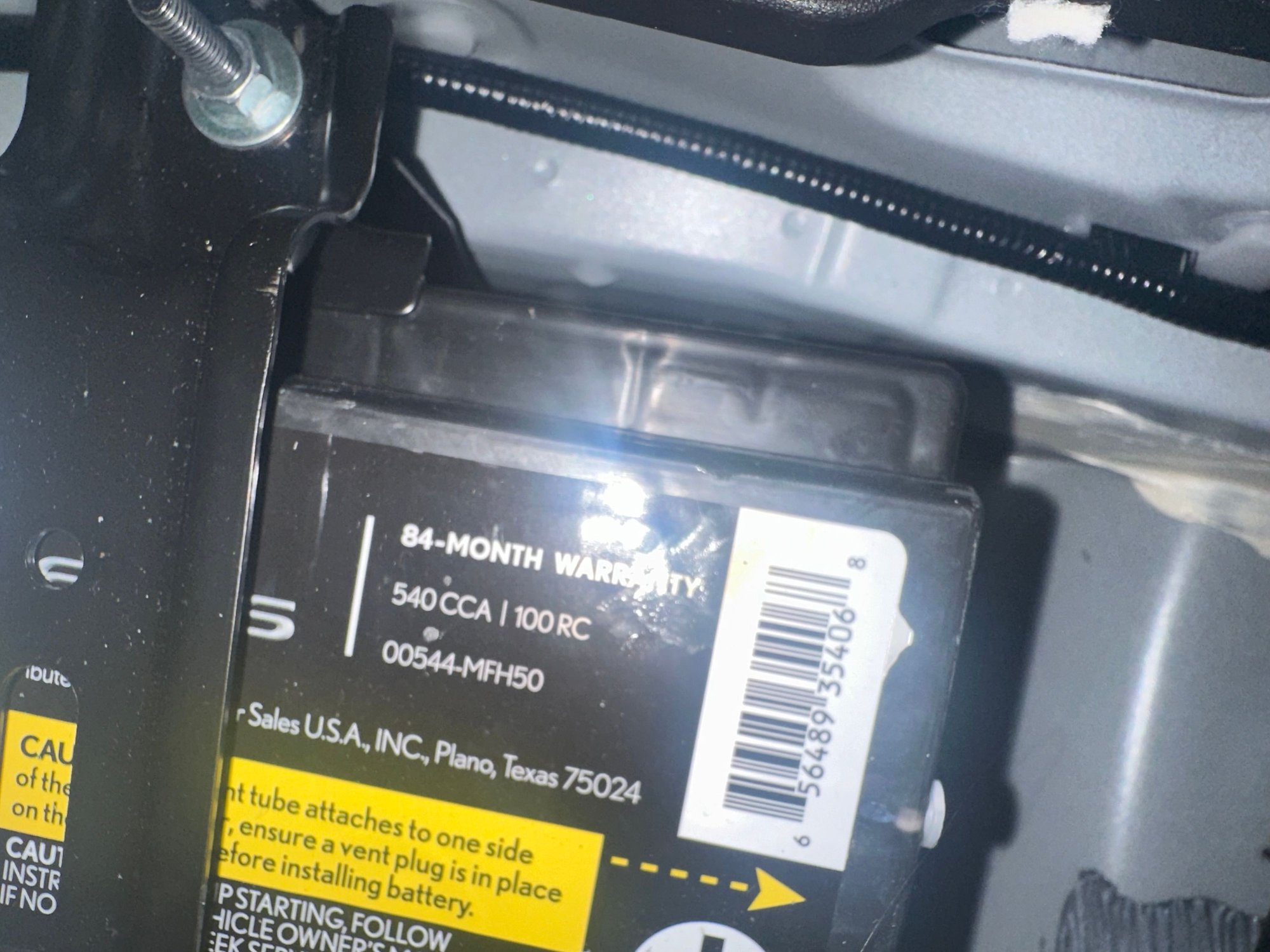

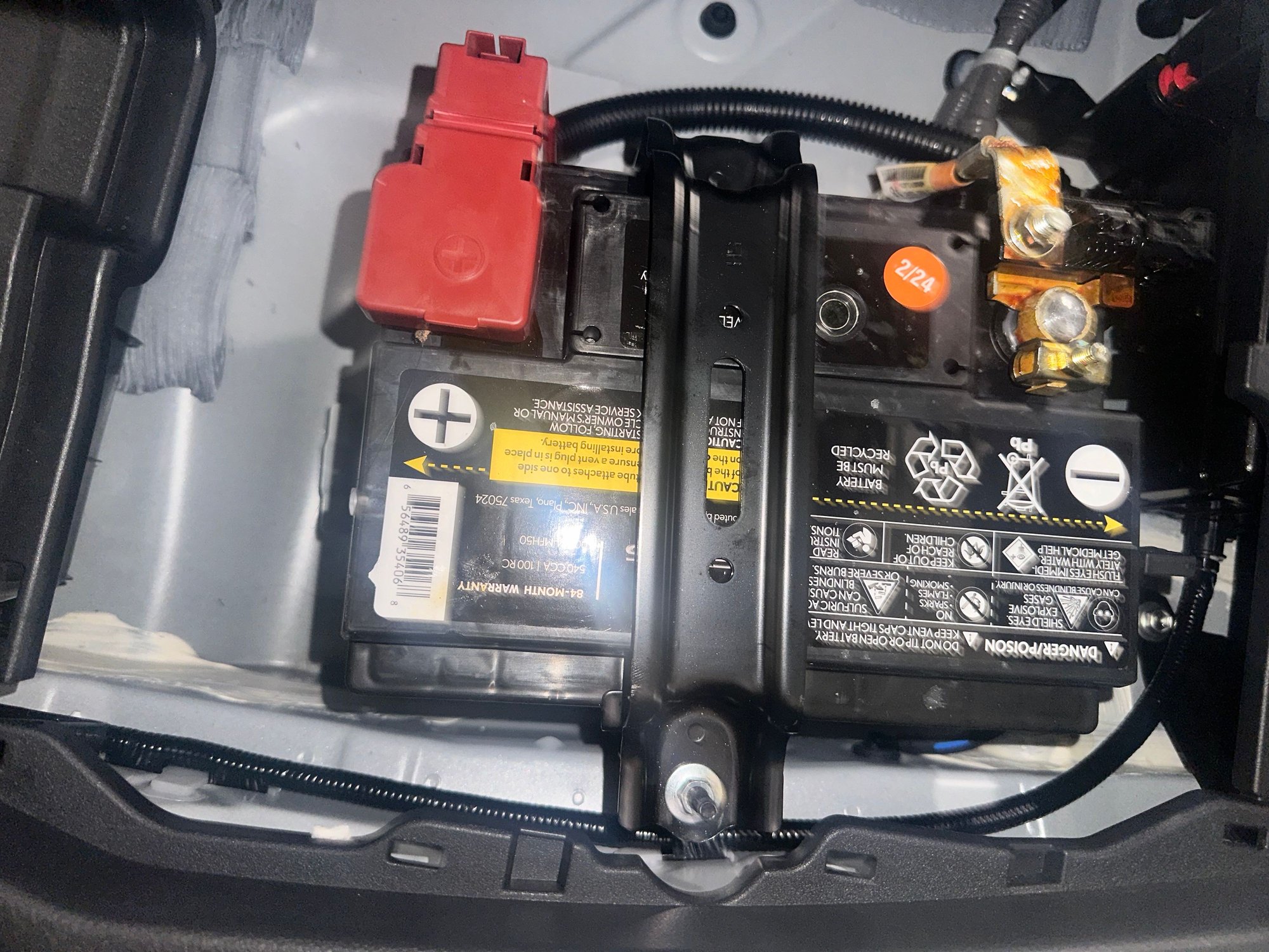

Went to use the car this afternoon and battery dead once again. Lexus replaced the battery in February…just a bit frustrating. At least this time was able to get in the car, but needed the booster get the hatch released and open. Currently on a charger😡😡

What was the replacement battery (brand, Ampere-hour) that Lexus/dealer replaced with ?Originally Posted by MooneyPilot
I retained the Panasonic battery because I didn't think my battery was the problem (poor charging algorithm, combined with parasitic drain is)

I am not seeing anything in reference to Panasonic. 84 month battery….right now I’m not seeing that it’s going to last more than 5 months. I reset the auto-shutoff to minimum settings and shut off the digital key.

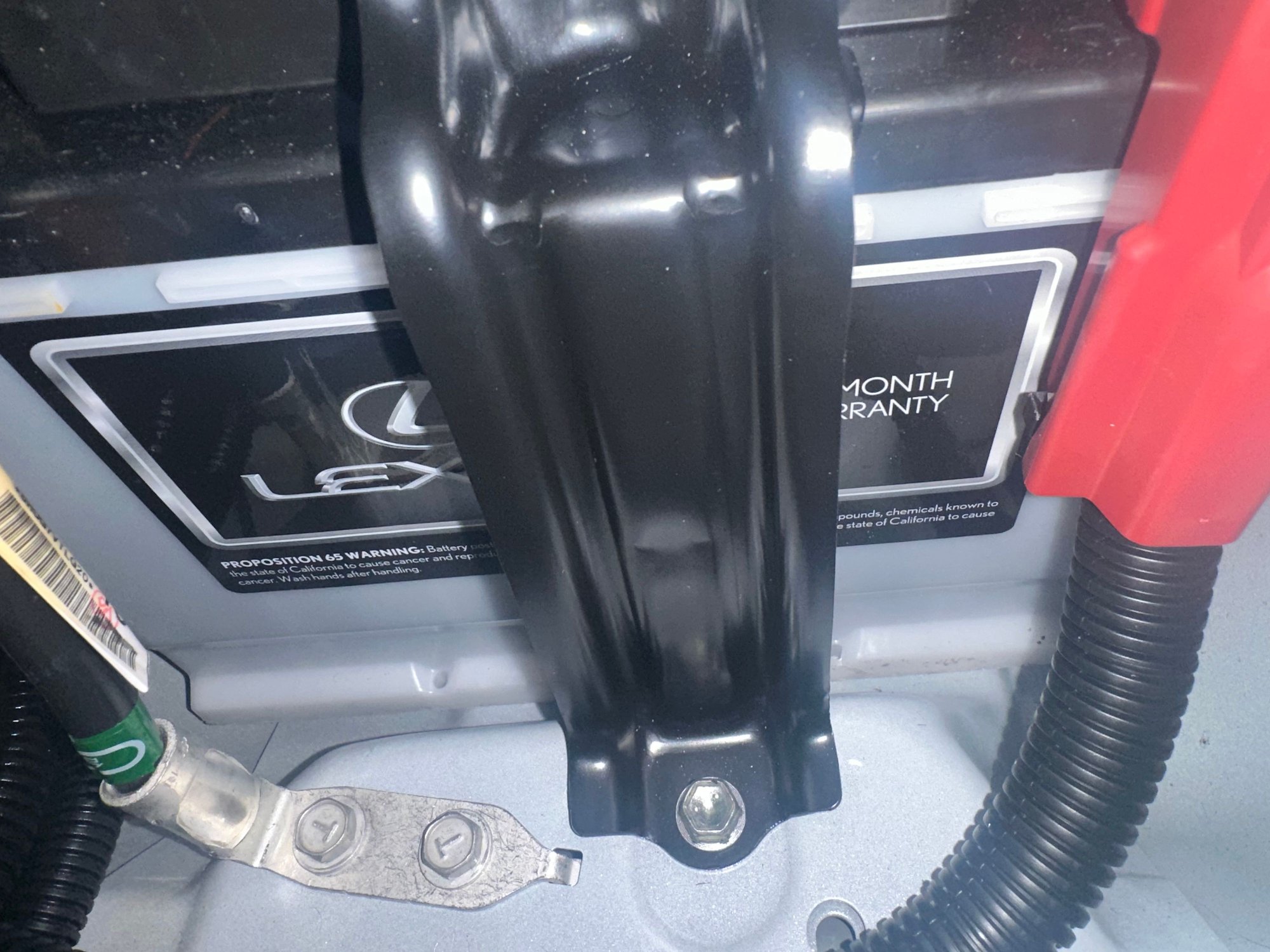

Thanks for sharing - looks its Lexus badged, so probably re-branded from a battery maker. It has 540 CCA, relative to 345 CCA of the stock/OEM from factory. I seem to remember another person stating that the dealer gave them an Interstate battery.
So its becoming increasingly clear with hard evidence that the battery isn't the problem (for most people), as the new battery is also dying. Getting an AGM out of pocket may band-aid the problem somewhat, going by the NX450H+ owner's experience and couple folks on Reddit, but I'm trying the key-in-Faraday pouch, proactive charging only once a month avenue first. I didn't want to deal with the dealer, who are clueless about the real problem anyway. I've not had a second dead-battery after the winter episodes when the temperature dropped to 4 C. I drive about 100 miles every week, so admittedly, there is frequent use of the car (hence charging happening, however, inefficient that charging is, during use), and I kept the fob in Faraday pouch - but have not been charging with maintainer (or remote starting the car) more than once per month intervals. I have turned off digital keys, and rear-seat reminders, but kept all other reminders (i.e. windows open, etc) on. Have turned off Clean Assist and Drive Pulse - to serve dual purposes of turning off useless app features that collect location and driving data and can be misused, while also potentially draining the 12 V.

I was trying to remember what the cca was of the previous battery and I had it in my mind it was around 350, so I think you’re correct on there. I have disabled the digital key and set the auto shutoff timers to the minimum. Near as I can tell, the Lexus app on my phone is unable to communicate with the car, so I’m hoping no draw is there.
