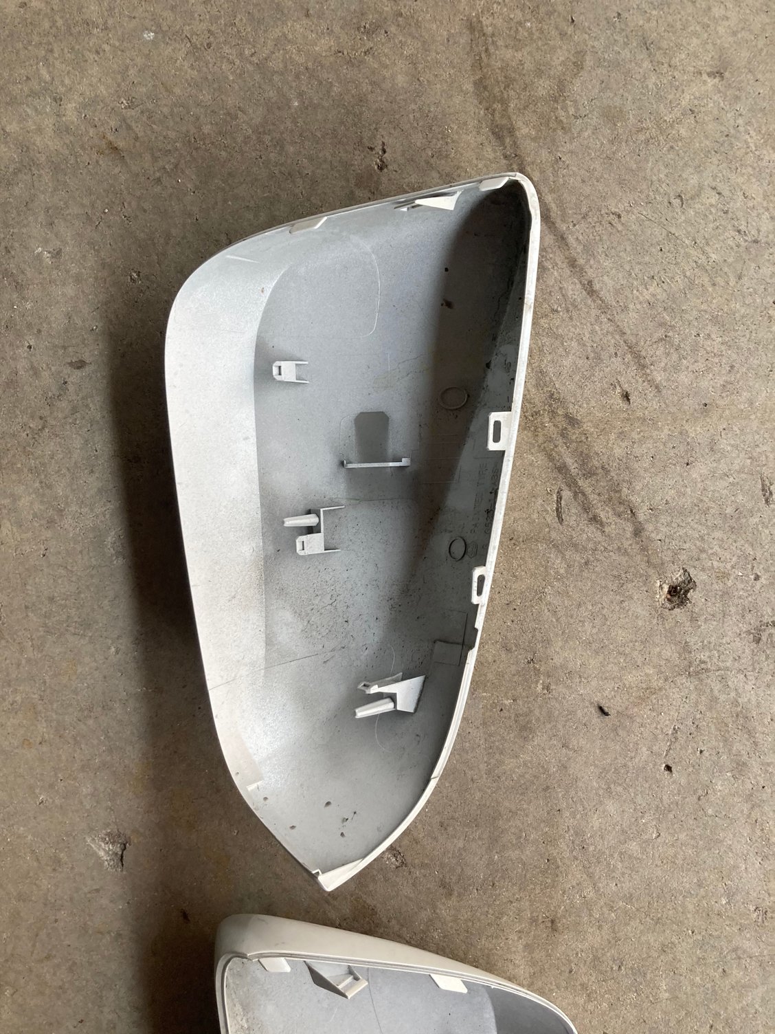

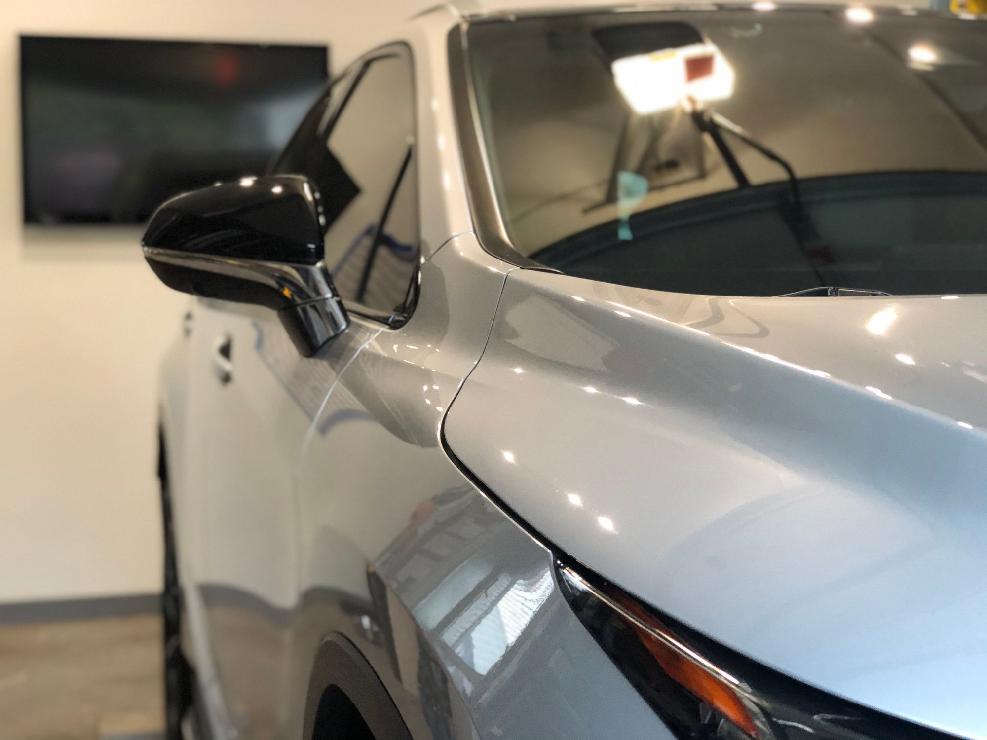

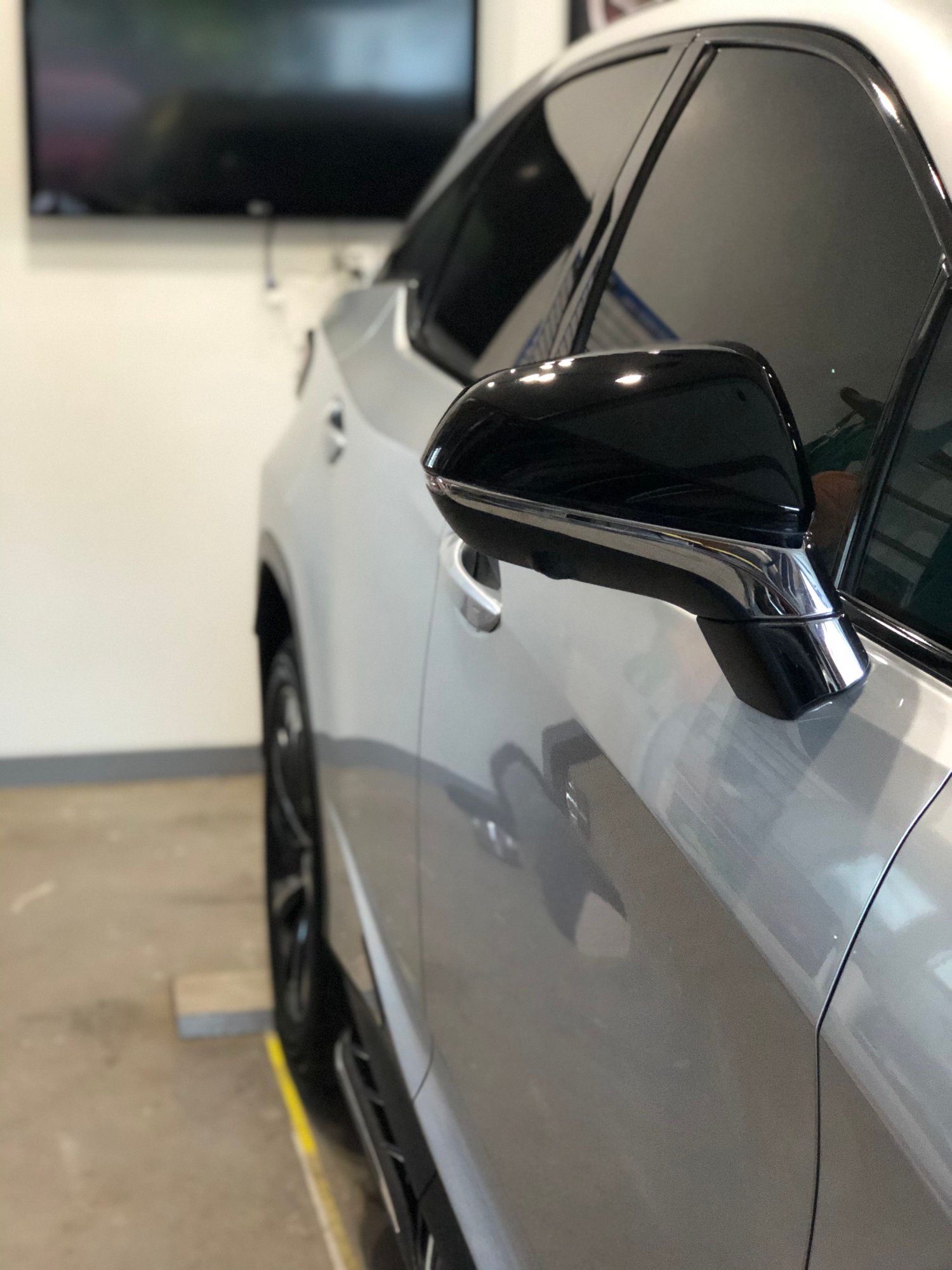

This is a base model RX mod. So, if you haven't noticed, the F-Sport trim comes stock with gloss black side mirror covers regardless of the main vehicle color. I know Audi does this with their "Black Optics" package which all the trim comes black (aka chrome delete) in addition to black side mirrors. I actually don't mind some of the chrome found on our RX. However, I did have the window trim vinyl wrapped in gloss black. So for me, swapping out the mirror cover was the finishing touch to complete the look. Took about 15min to do. Here are the details:
OEM factory black mirror covers- $42per side from my local Lexus dealership (they price matched another Lexus Dealership). I couldn't believe the price. I was quoted over $100per side from auto detailers to vinyl wrap the mirror.
P/N: 879450E060C0 Left side
P/N: 879150E060C0 Right side
Paid $6 for molding/trim kit off Amazon. This came in handy to help remove the mirror which is held on by two upper and two lower claw clips. The mirror cover then is attached by 6 claw clips. The top three were easy, the lower three were tricky.
I'm obsessed with this mod. What do you think?
Before.
After.
OEM factory gloss black side mirror cover replacement with window trim wrapped in gloss black vinyl.

The Raider theme looks great I love the black and gray look. It’s a really nice touch with the windows chrome delete. At that price you can’t beat it either. It’s nerve racking popping out the mirror isn’t it! It’s always the please don’t crack, please don’t crack, I don’t want to look, I don’t want to look!! Yes didn’t crack!!!!!!!

@EasyTurbo7 did you have to pop out the mirror glass and remove the screws to get the mirror cover off or can it just be popped off with a trim pry tool?
It’s been so long but from what I do remember it was fairly easy to do. The dealership printed off an instruction sheet at the time which I no longer have. I believe pry tool is all you need.
