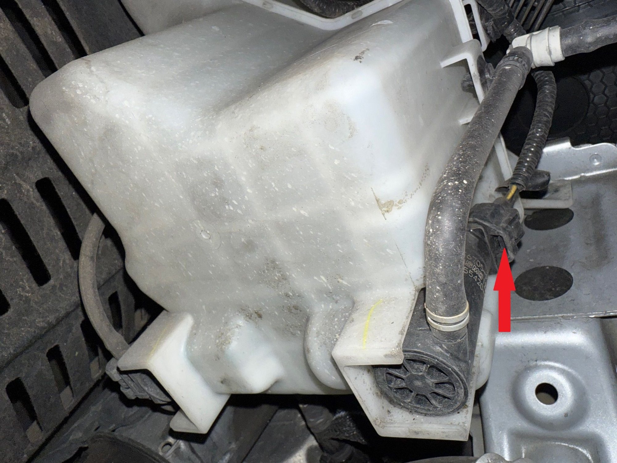

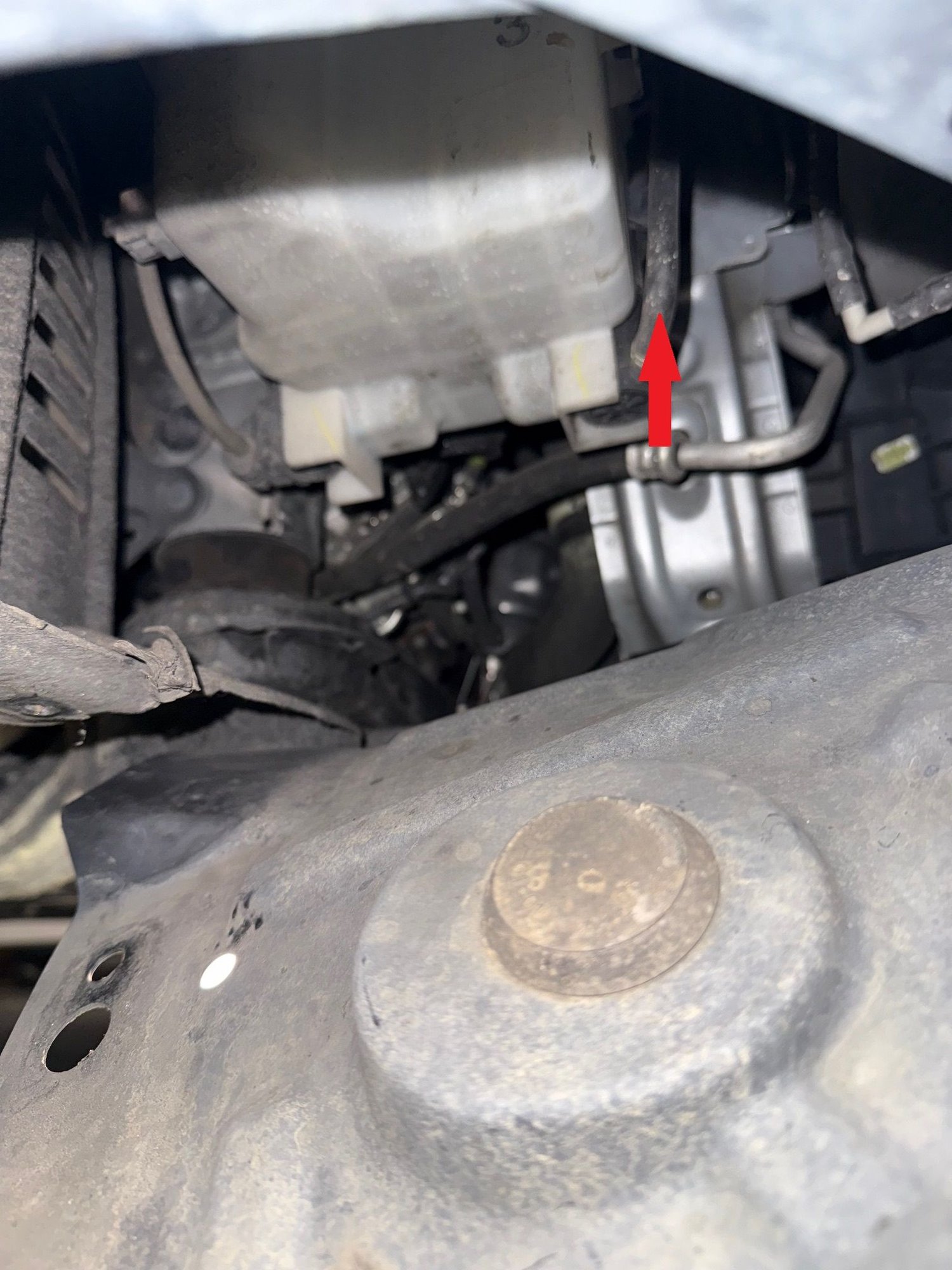

Hey guys. Just so everyone knows, I am providing an easy step by step instruction on how to disable your headlight washers by disconnecting the washer pump going to the headlight washer itself which is located towards the front. Long story short, some rodent chewed on the lines going to my driver's side headlamp washer which leaked washer fluid all over on that side so since I didn't want to pay $1-2k to the dealer, this alternative solution was the best to just disable this feature all together since most of us don't use it anyways. BTW, this is my wife's 2016 RX450h F-Sport.
Total time for the job: Less than 30 min.
Tools needed:
1. small flat head screw driver
2. socket wrench or phillips screwdriver
3. Electrical tape (optional)
Step 1: Remove the (3) Hex bolts/screws below the front passenger side undercarriage as indicated in the picture.
Step 2: Gently pull down the plastic liner.
Step 3: Look inside and up towards where the arrow is pointing
Step 4: Remove the connector going to the headlight washer pump. You will need to insert and push the flat head screw driver to loosen the tab and pull the plug after.
Step 5: As an optional step, I electrical taped the plug (had to creatively use one hand to wrap it as tight as possible, similar finger movement like trying to taking a girl's bra off with one hand ) and tucked it behind the connector.
Step 6: Tuck the undercarriage liner back in place and screw in the (3) bolts back (basically do the reverse/opposite of Step 1 and Step 2).
