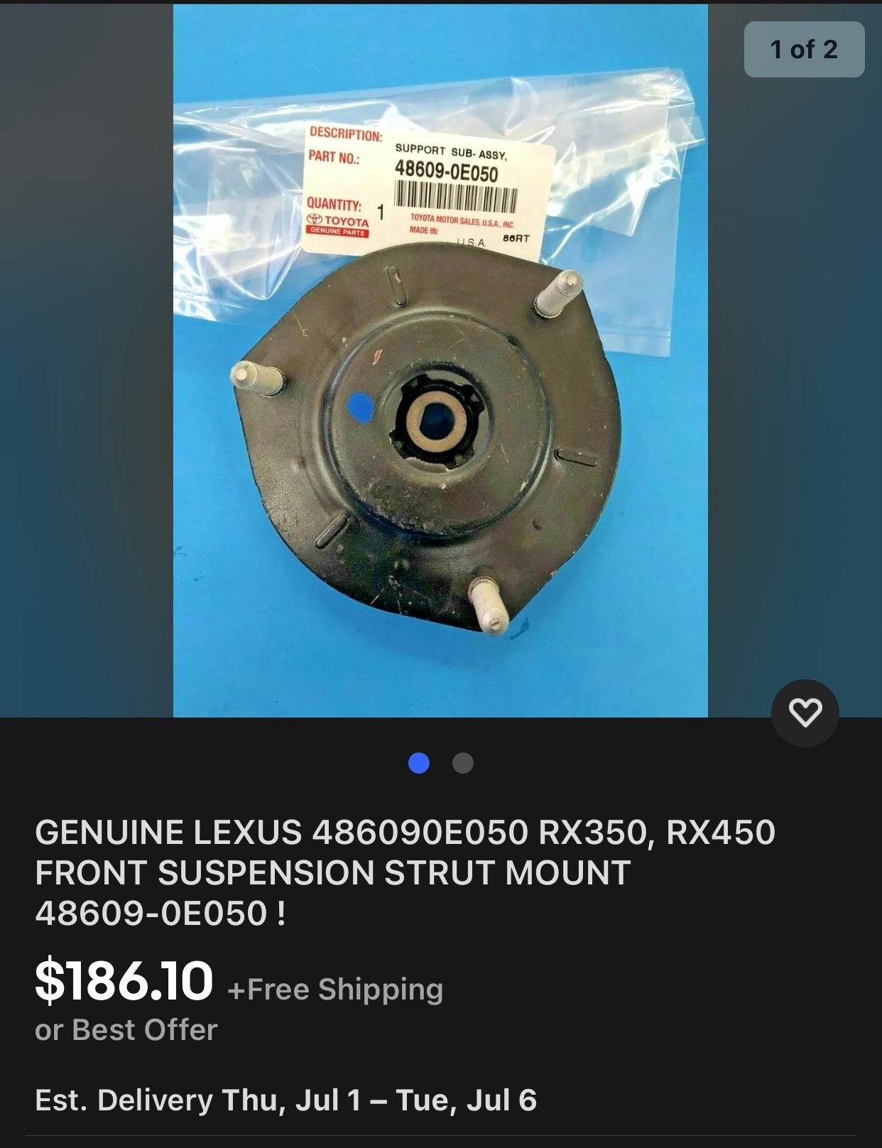

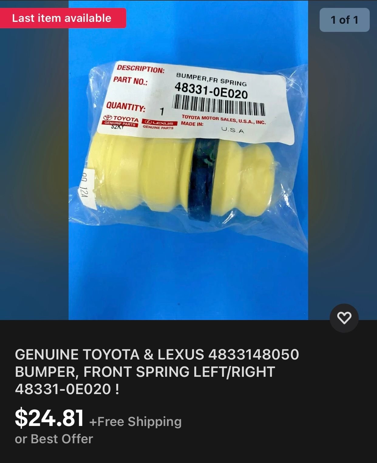

I already have 3 of the B6’s that I bought from Rockauto but I’m still waiting on that front passenger Bilstein! I have orders in with Shockwarehouse, and Autoplicity waiting to see on who ships first (direct from Bilstein) so I can cancel the other order.
I haven’t visited Lexus yet but am I going OD on parts replacement? I was planning on buying for the rears the bolts/nuts. And for the fronts I was going to order
(2) Stabilizer Link - (48820-06040)
(2) Strut Mount - (48609-0E050)
(2) Strut Bumper - (48331-0E020)
I might be getting a little confused. Up front is it the strut bearing or the strut mount or both that should be replaced?
thank you guys!!

There are no upper nuts for the rear shocks as the bolts thread into the bracket itself. As Clutchless said, I would grab new front sway bar end links as well. I almost always end up having to cut them off or have to put vice grips behind it to lock it in place as I unscrew the rusted-on nut. It’s nice to have a spare set just in case, as your project won’t be slowed down. Even if you don’t end up needing them, you will likely need to change them eventually. These can also be sourced from the Toyota Highlander.
I believe strut bearing & strut mount are interchangeable terms. The strut mount has ball bearings on the inside to allow rotation of the strut. If you want to replace the upper and lower strut isolators, you can do this too. Those are the little rubber pucks that the spring sits on. You can grab those from the 2010-2013 Highlander as well. Make sure you get left and right ones specifically, as our generation of RX is the only one to have ones that are directional (this also applies to the 2010-2013 Highlander). Our rear suspension is shared with the 2014-2019 Highlander in the rear. No strut mounts / bearings / isolators in the rear as it is just a simple shock absorber.

You will not need new strut mounts or bumpers. Save your money. They rarely wear out.
You should only replace the strut mount bearings. They are about $25 each I think. I got OEM Toyota ones on eBay. You just lift out the old one from the strut mount and replace it with the new bearing. Make sure you have the correct side facing up! Don't ask me for the part number. Look it up yourself or just search for the correct year (2010 - 2015) RX350 strut mount bearings or 2012 HIghlander front strut mount bearings on eBay. The same ones are used on most of the Toyota & Lexus models within that year range.

Thanks for the suggestion. I did not know it was possible to change just the bearings separate from the mount! I will be doing that instead.
