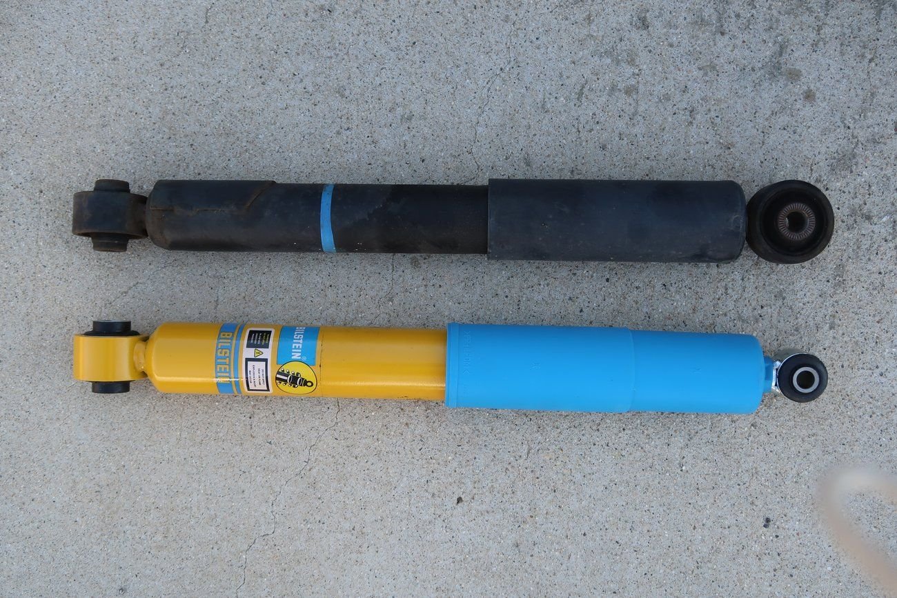

This is the best image of the shock I can find. The part on the right is different from the OEM. Any problem when installing it? Mine is an AWD.
i want to get the B6's. where would you recommend to buy them from?

See this
​​​​​​The Bilstein fronts that fit the RX are those from the 2008-2013 Highlander.
The Bilstein rears that fit the RX are those from the 2014 -2019 Highlander.
This information was provided earlier in this huge thread. You can look up the parts numbers.
B4 is for the normal RX
B6 is for the F-Sport or if you want to make your RX handle more like an F-Sport as they are stiffer.

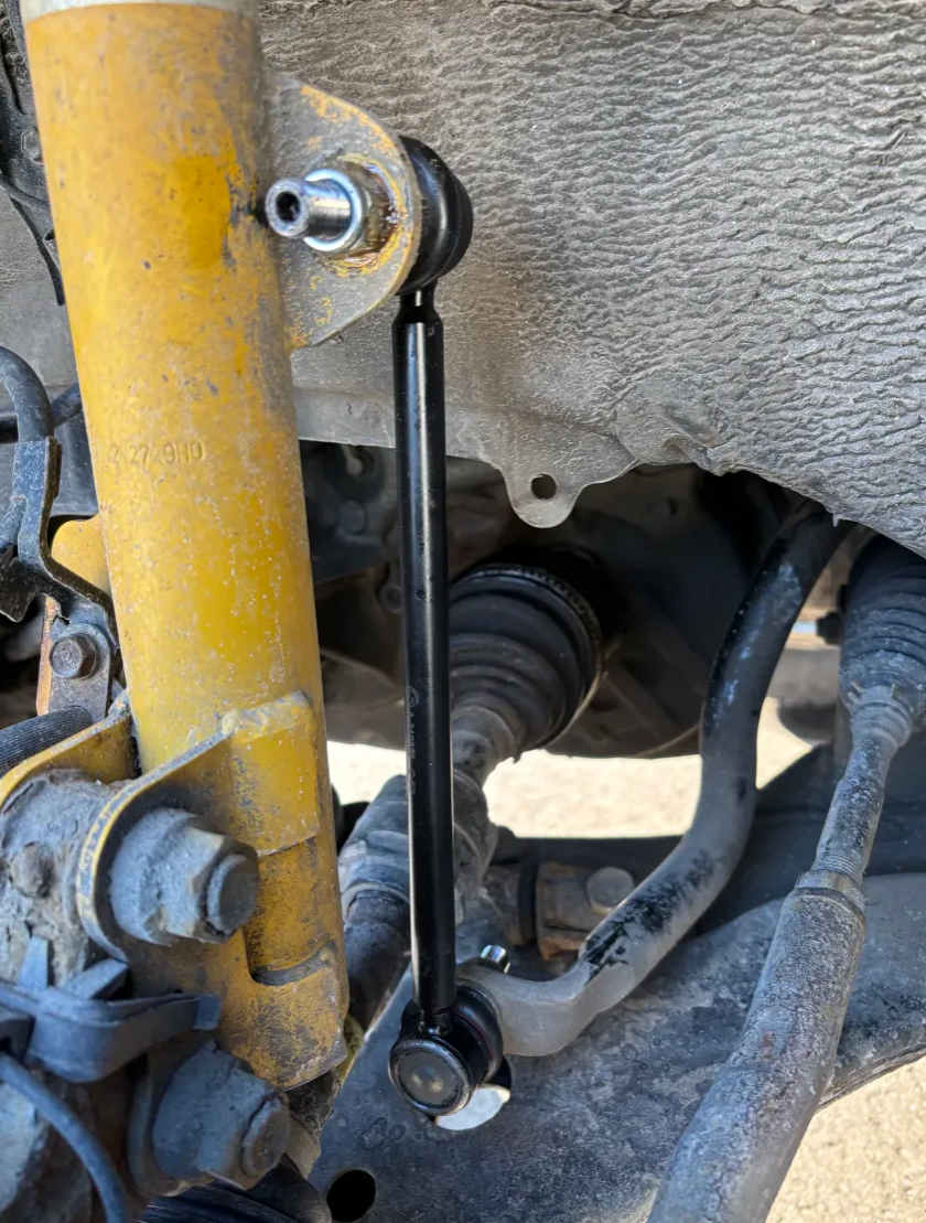

Also if you live in a rusty area, you may find that the stock front sway bar end links will not come off without cutting them off or heating them up to the point that the grease and rubber boot get disintegrated. I replaced mine with 2004-2010 Sienna ones which are 13mm thick vs. 10mm but are the same 260mm length so they fit perfectly.

^^ Great decision. Always a good idea to go with a larger diameter sway bar and end links on any SUV when you can. It usually makes a remarkable improvement in handling and stability, especially at highway speeds on blustery days.
Did the beefier endlink helped ?

Not that I can tell, but it's a heavy 4500 lb car like a Sienna and deserves something beefier than stock. There was no price difference either.
