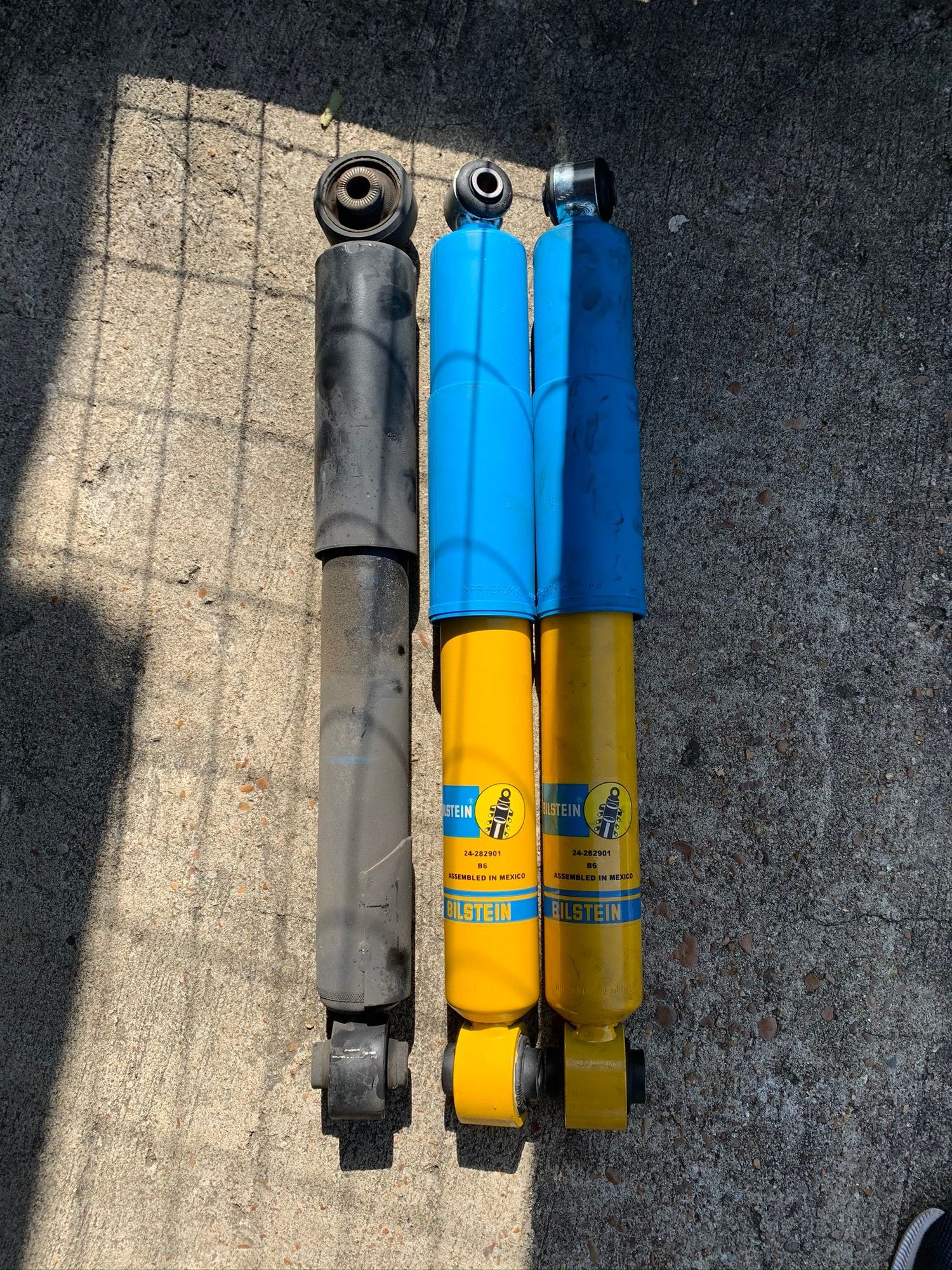

This is the best image of the shock I can find. The part on the right is different from the OEM. Any problem when installing it? Mine is an AWD.

I installed the Bilstein B6 rear shocks on my 2010 AWD RX350 and aside from them being a very tight fit in the upper mount, they fit fine and drive great. I actually found that on the passenger side it was easier to remove the upper shock mount, 3 bolts, then bolt in the shock, then put the upper mount back in. It was very tight and hard to line up. The driver side went right in. I think that was just unique to my car or that shock. Others have had no such complaints.
Bilstein does not list it for the RX350 because they have not tested it for the RX. They developed it for the 2014 and newer Highlander which has the same rear suspension as the 2010 and newer RX and has a bigger market and more buyers who would modify their vehicle with higher performance shocks & struts.
