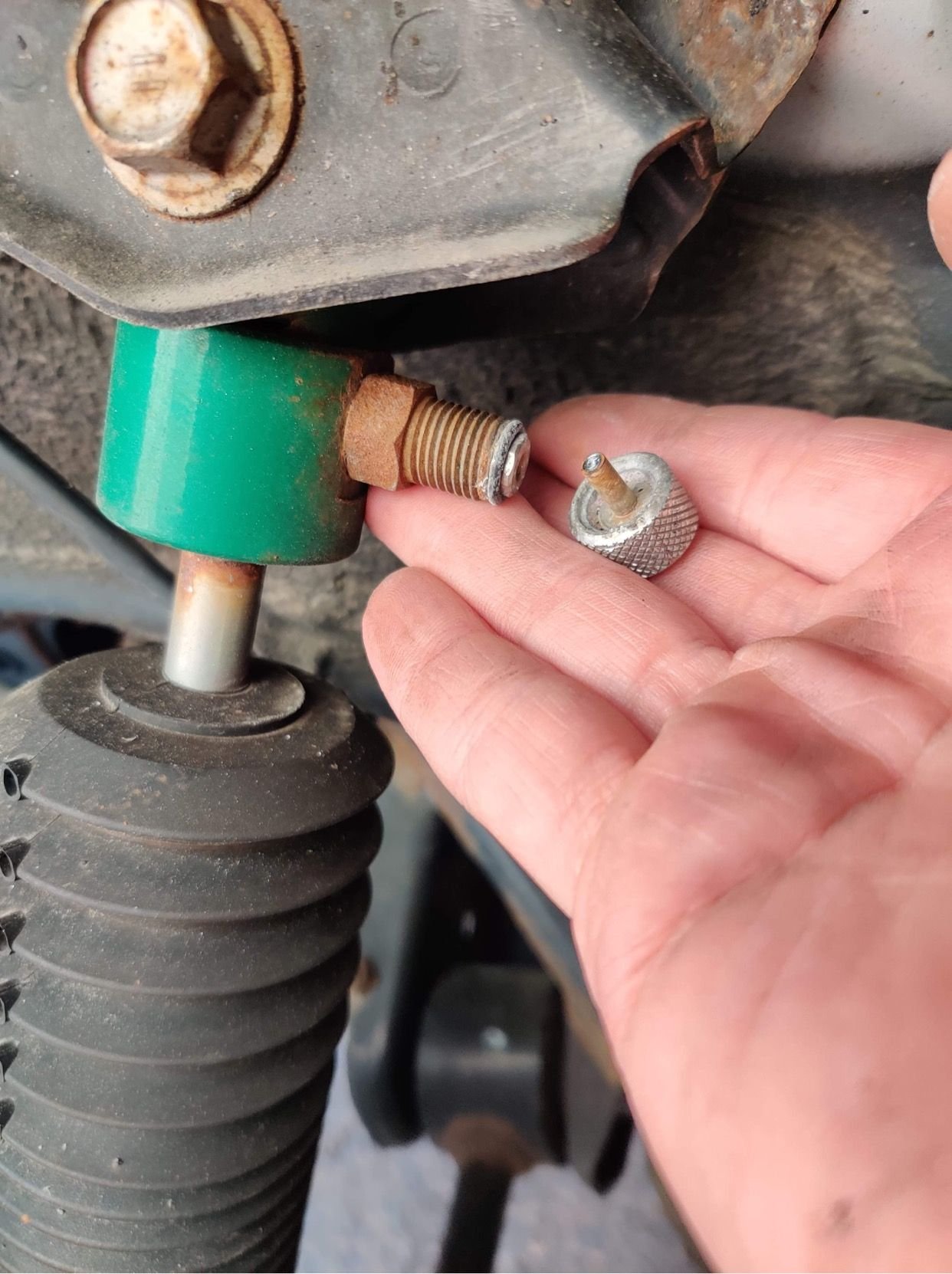

I want to inform everyone NOT to buy the Tein EnduraPro+ struts & rear shocks for our cars. It’s cheap Chinese garbage that does not deserve to bear the Tein name. After just one winter, someone on the Lexus FB group saw a failure with their adjustment **** on a rear shock. Also, the piston has already seen some decent corrosion, which is something that should never happen on any shock/strut piston.

^^ Good job calling out this lousy choice. The best solution for these vehicles from a longevity standpoint remains getting Bilstein B4 or B6 shocks (assuming you can find them in stock somewhere).

Agreed, my Bilstein struts and shocks are holding up as strong as ever. I am also really impressed by their ability to resist corrosion as well.
