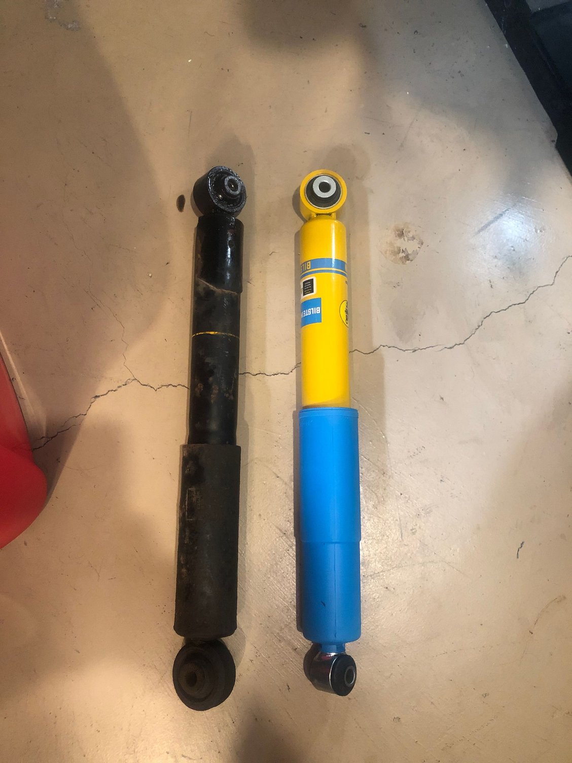

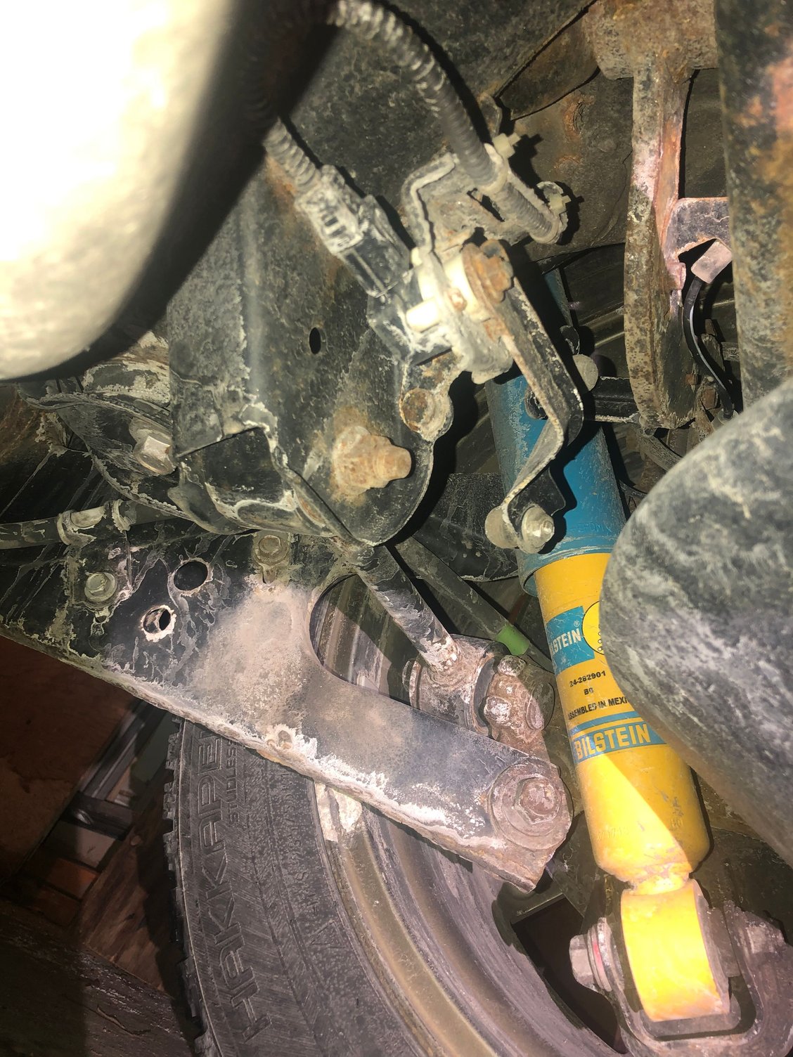

Hey @MattRX @Clutchless , thank you guys for the response. I have decided to install myself and recognized that it didn't fit at the bottom mounting area. I'm attaching here the images to show the different widths between the OEM's and the Bilstein's. The Bilstein B4 19-282862 model appears to be a bit wider at approximately 10-20mm than the OEM, which made it impossible for me to slide it into the bottom mounting area of the shock. Is it because mine is a B4 while the B6 appears to fit better or my RX 350 AWD is a different variant?
OEM shock
OEM shock
Bilstein shock
Bilstein shock
The mounting area that doesnt fit
The mounting area that doesn't fit

The B4 and B6 should have the same bushings. If both shocks are the same, maybe they had a batch with the wrong mounting tubes. Or they over torqued the original shocks at the factory leading to the bracket getting compressed.
If I had this issue I would use a pry bar to widen the lower mounting bracket and grease it up before inserting the shock. It will be fine after you torque the bolts.
Someone on the Ford Power stroke forum had this issue and had success with the pry bar method.
​​​​​​https://www.powerstroke.org/threads/...it-help.92268/
And they pried them wider on a Jeep in this thread:
​​​​​​https://www.wranglerforum.com/threads/rancho-9000-xl-metal-bushing-sleeve-too-wide.728609/
Or try a splitting wedge which you can tap in there with a sledge hammer..
https://www.reddit.com/r/CarRepair/c...ricks_to_help/
