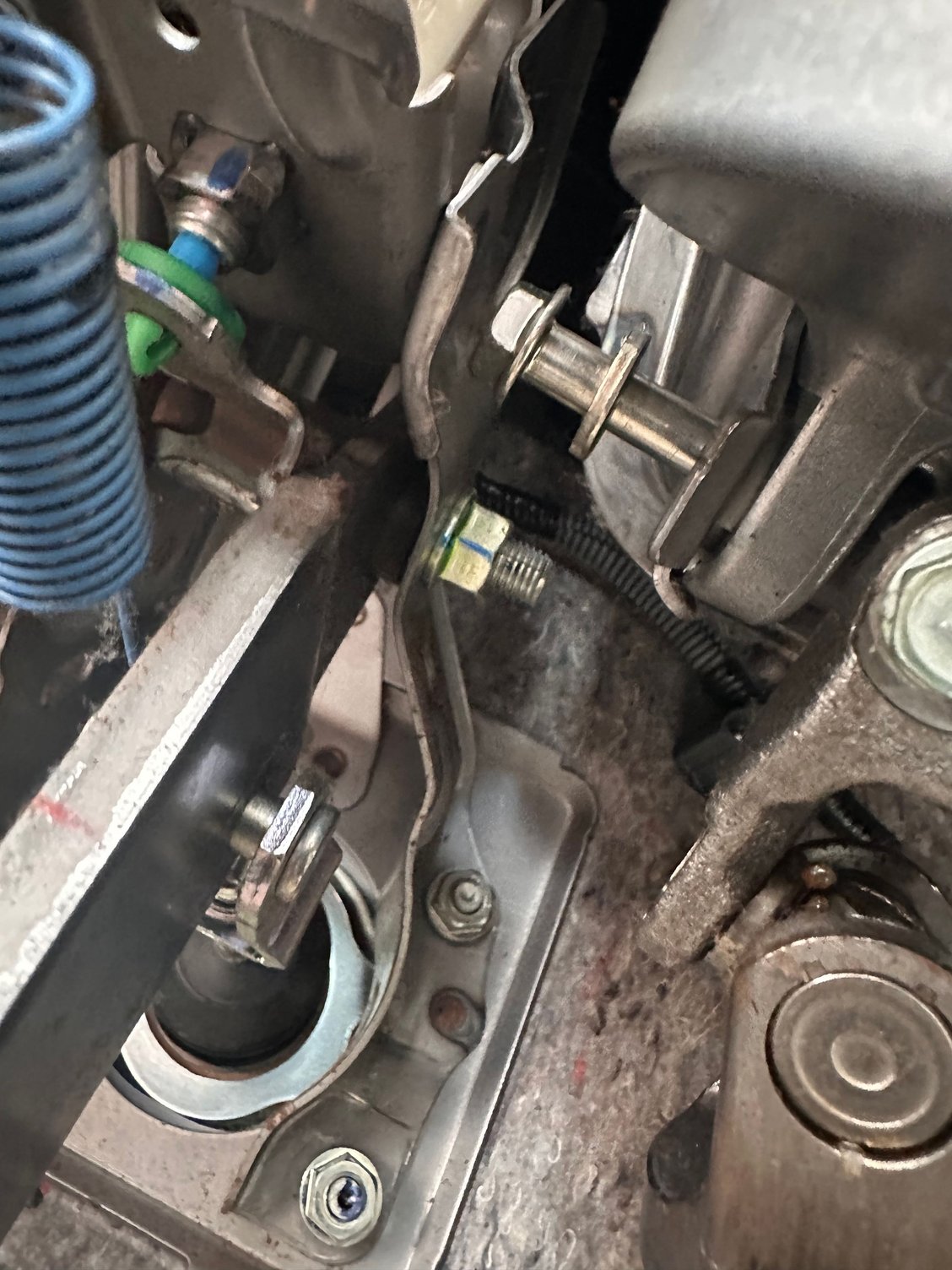

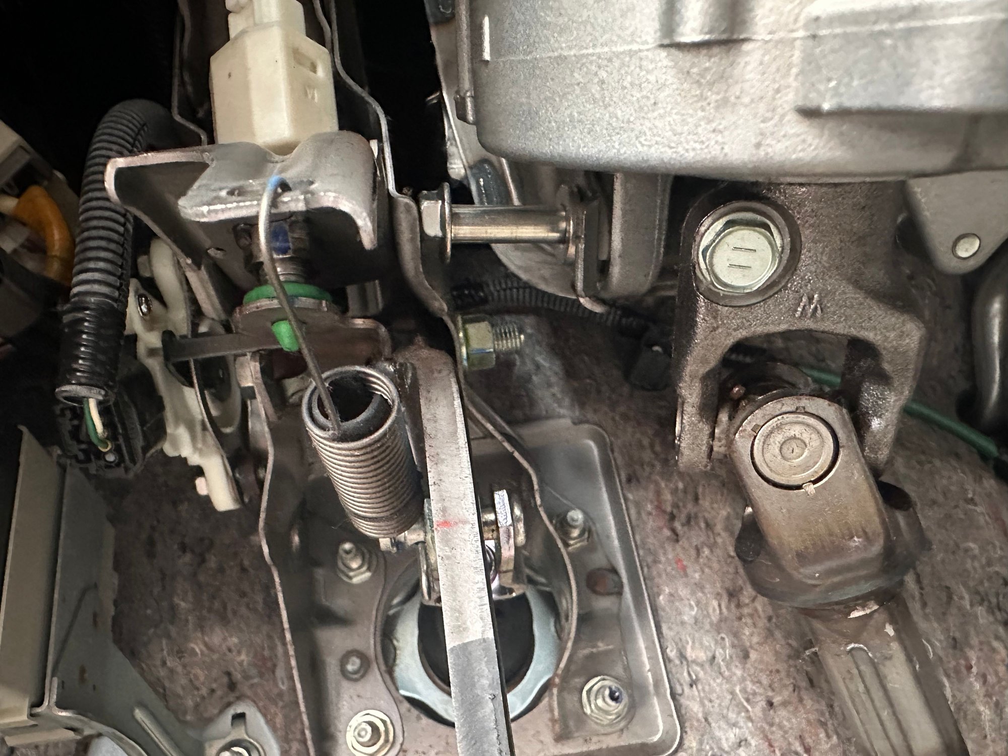

In process of changing out steering column on 2015 model. Only thing holding back completion is this bracket which blocks removal of lower column bolt.
Does anyone have a diagram of how this bracket is attached?
Bolt hitting brake bracket
Another angle
Another angle
