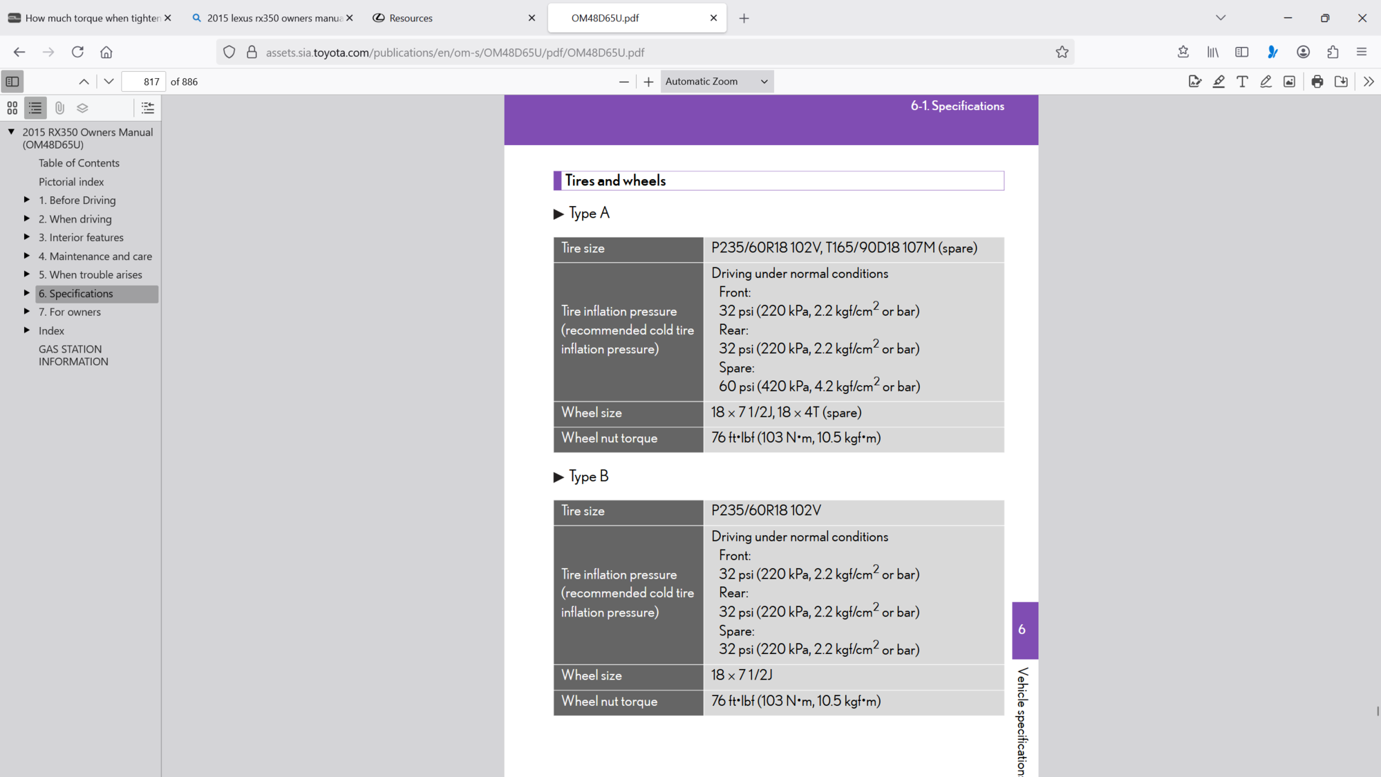

Originally Posted by rayaans
Perfect! Thank you. Just for reference, is it written anywhere apart from in the manual?
Generally no. Only in manual.

Old Apr 17, 2026 | 12:08 PM
ttomasic's Avatar
ttomasic
Joined: Feb 2013
Posts: 25
From: MO
never mind!
