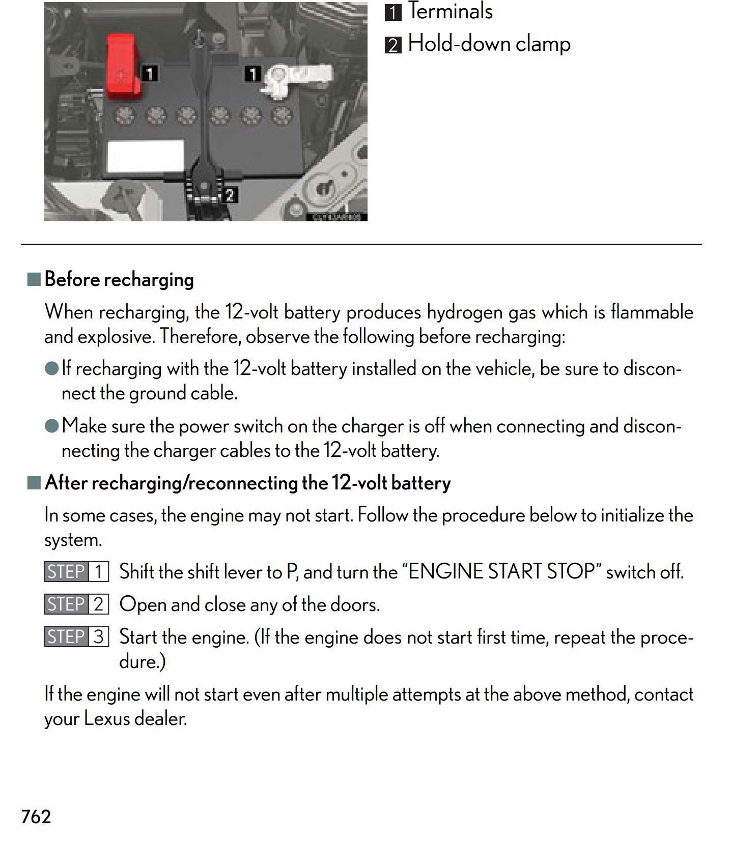

I just found this by accident: page (pdf) 996 of the 13 RX owner's manual.
and
