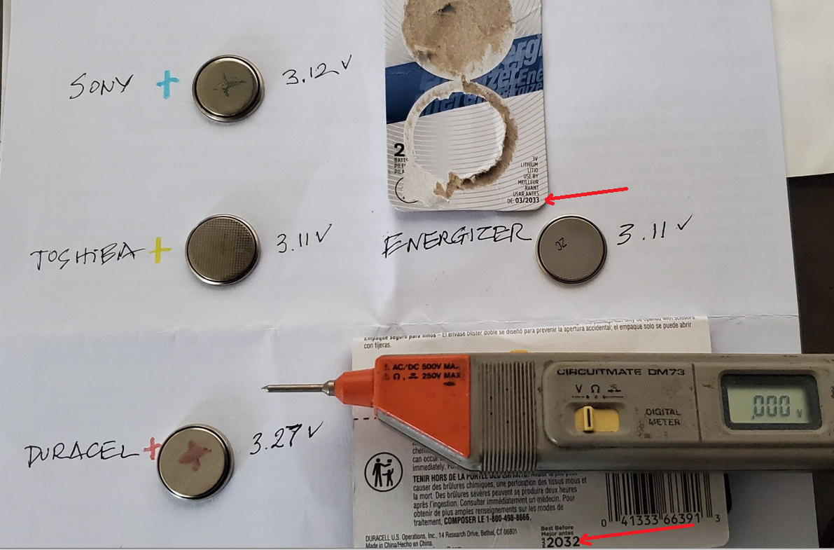

I don't want to be too technical but a 3V lithium coin battery read 3V is very weak! We need to eliminate all the basics first.

New Duracel batteries and just tested to make sure they were good, tested over 3v exp 2032 (which we know would be dead by then!). I had actually just replaced the batteries earlier this year but went ahead & bought new a few weeks ago and put those in- just in case. It is just strange, nothing has changed, no new phone or parking situation, etc. where electronics could interfere. It can happen anywhere but only on for a minute or two after the car is started. Example a few days ago happened in the garage, started the car & looked at the dash- no message. As I went to back up, it came on but then went off before I finished backing up. Today with a different key fob/new battery, it happened it a parking lot. Came on & finally went off after driving maybe a 100 feet. No issues in starting the vehicle so far just don't want to end up stranded at some point.
