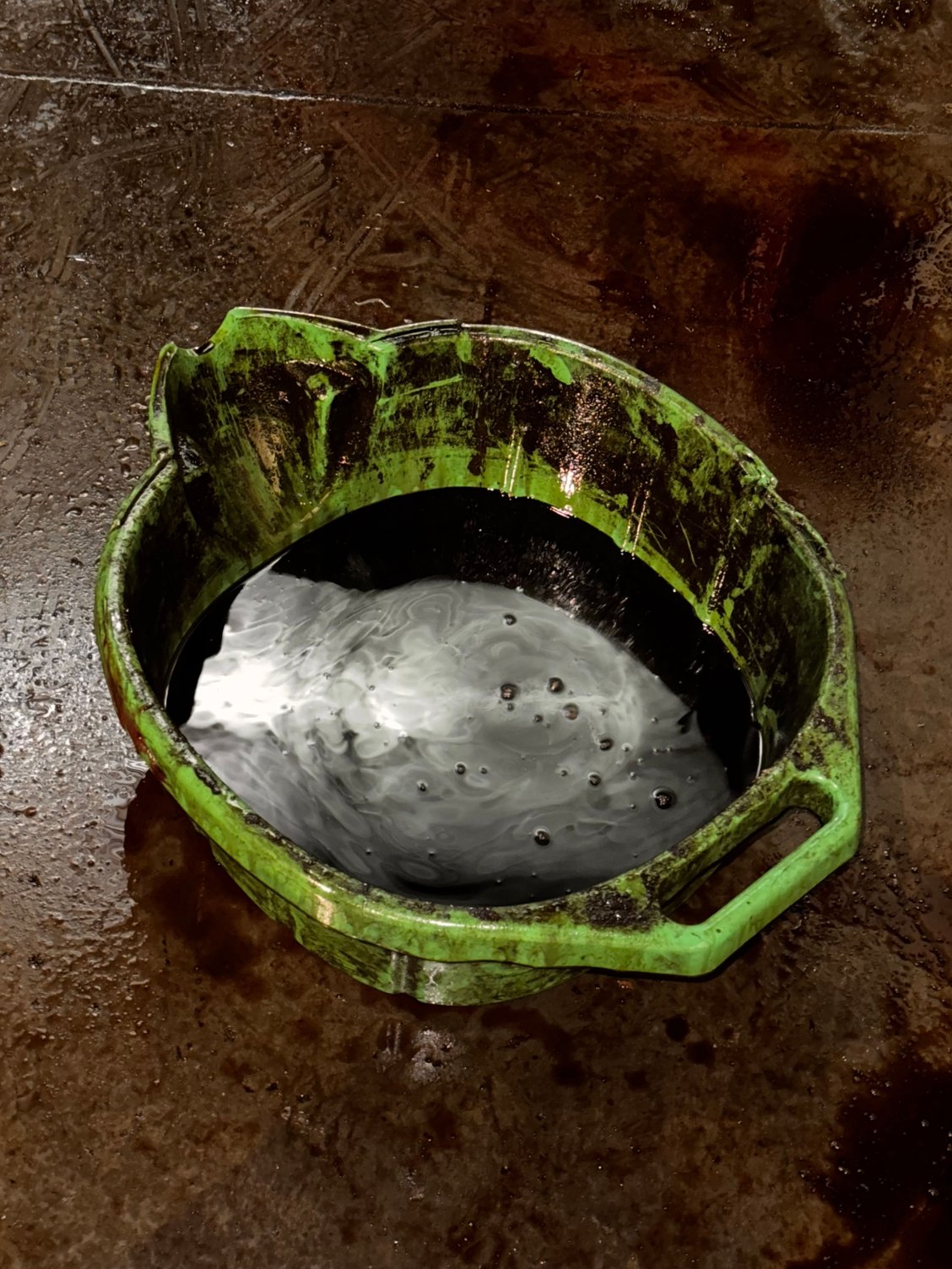

This is the lexus Oil called Life time !!!!!!! I drained 4 quarts getting better now but i have to drive more to get zero silence its mixing with old one now inside and may be i need to refill drain later
update
Hi all , my update after i did two drain and refill it was still exist , i did the third and add 1 tube 2 oz of Lubeguard instant shudder fix modifier , the problem solved , Thanks god and thanks @herndhonrestontransmission

Default Fixed : SHUDDER AT 40 mph
