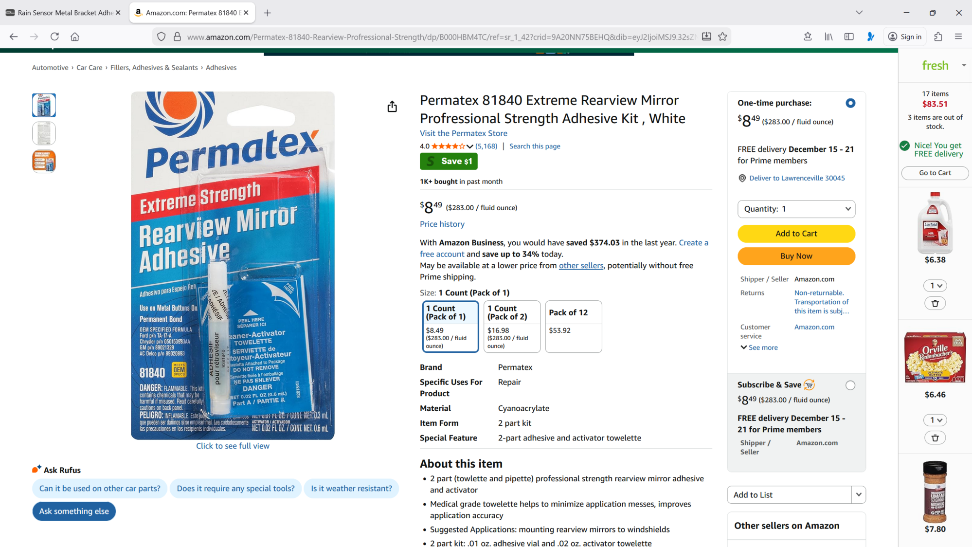

I had good luck with Permatex rear view mirror glue in the past for the review mirror metal supports that fell off the windshields in some of my old cars.
Maybe this type of glue will work. Just be sure to properly clean the area and the part of any remaining old glue residue first before applying it.
Thanks! I did actually try that twice in the past. Held well, but only for a couple of months.
I'm considering tryihng an Oven Heat Resistant glue. It's supposed to be good for up to +300C, and down to -60C
Something like this

Weird. I used that Peramtex windshield adhesive on rear view mirrors that held for years until traded the cars that it was used on. The adhesive lasted even on hot Georgia summer days.
I would perform a proper clearing of the area before using any more glues. You may have to scrap the area clean of old adhesive residue with an razor(plastic or metal)and use alcohol to ensure that the area is oil-free before applying whatever glue you are using to ensure a proper adhesion. I have learned that you must perform proper prep work of the area and part for any glues to make a successful permanent bond.
Take some pics of the windshield area and the part after you cleaned it before you apply any glue to it.
