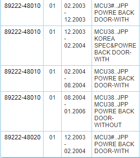

I didn't include the P/N prefix since I assumed (yeah, that assume!) that it was obvious. They all have the same prefix 89222-, e.g. 89222-0E010. I did a search to try to find out at what point each of the versions occurred chronologically but couldn't find anything so I need to remove the module in order to see the actual part number. What I'm not clear on is the module removable from the fust block or must I remove the entire block? You implied in your referenced post that it is part of the fuse block. If you - or anybody else - can clarify I'd appreciate it.

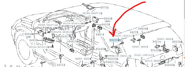

I've got a 2005 RX330 with a control module problem and I've posted here before trying to locate where it's mounted. The problem is that that series RX came with three possible control modules (referred to as multiplex door network computers) and I want to make sure that I replace with the correct one. The three optional modules are P/N 89222-0E010, -0E012 or -0E020. I've been told that it should be mounted behind the fuse block but there's nothing there. There is another module that is mounted to the wall left of the fuse block but that's for the headlight control. Can somebody out there point me in the right direction or even provide a diagram showing where this module is located?

The RX has many control modules.
It has one in each door, one for key transponder, one for gateway for Nav editions, etc, etc, etc.
I wouldn't go looking online for part numbers for anything yet.
Not really sure which module you need until you tell us what is going on and what's not working and how you came to diagnose you needed a module in the first place.
PS- each door has what you describe as a "multiplex door network computer" so, which door?
