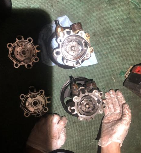

I cleaned all the sludge out on the inside but the only thing I didn’t try was cleaning out the oil galleries with gas or diesel. I still get that stupid rattle every time I start the car. Maybe I’ll try the front some day. I dread having to go back in and do the rear valve cover again, that was hell on earth. Curse you transverse V6 engine mounting

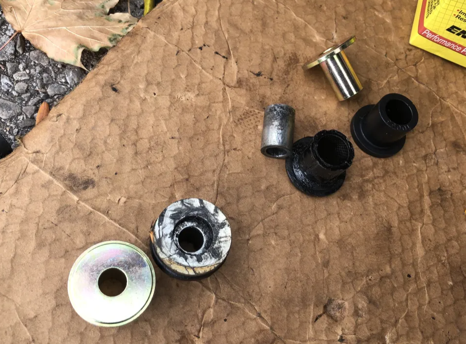

I also ended up replacing my Nolathane steering rack bushings with ones from Energy Suspension for the 05-15 Tacoma. The Nolathane bushings were just way too soft and got badly squished when torqued down to the factory spec of 52 ft lbs! It was leading to my VSC kicking on for no reason on and off highway off-ramps and my alignment had a mind of its own as the steering rack was moving! The Energy Suspension bushings also have far superior zinc-coated hardware that is much easier to install and the bushings themselves are super firm! The Nolathane bushings had a separate washer and collar which made installation a lot more annoying. Cannot recommend the Nolathanes sadly! Save up for the ES bushings if possible.

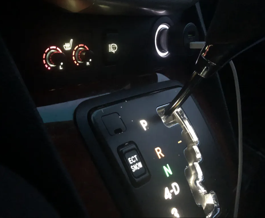

October 8th, 2023:
Original post: https://www.toyotanation.com/threads...#post-14899391
Added an LS460 light-up accessory port to my car! Since then, I have found some other options that would likely work from a GS/IS and ES. The LS ones are LED, while the others have replaceable 74 type bulbs. Ones from the Highlanders and RX300 do not have an easily replaceable bulb.

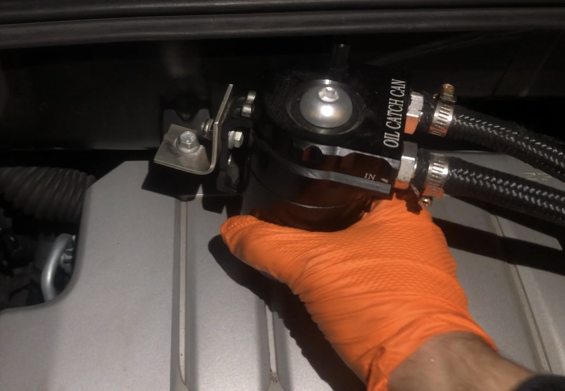

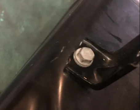

October 15th - October 16th, 2023:

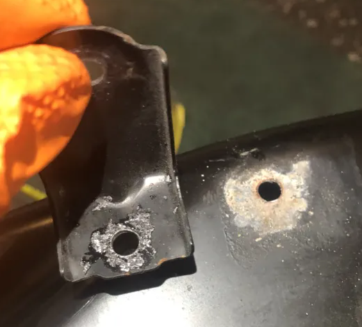

Drilled out the failing rivet on the bracket (one that holds the cover that used to be over the PS reservoir) that my catchcan is attached to. Nut & bolted it and the catch can is super firm now!

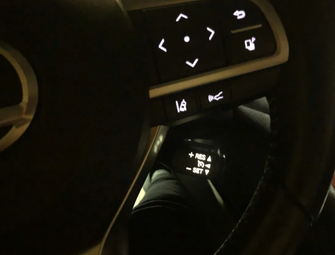

October 20th, 2023:

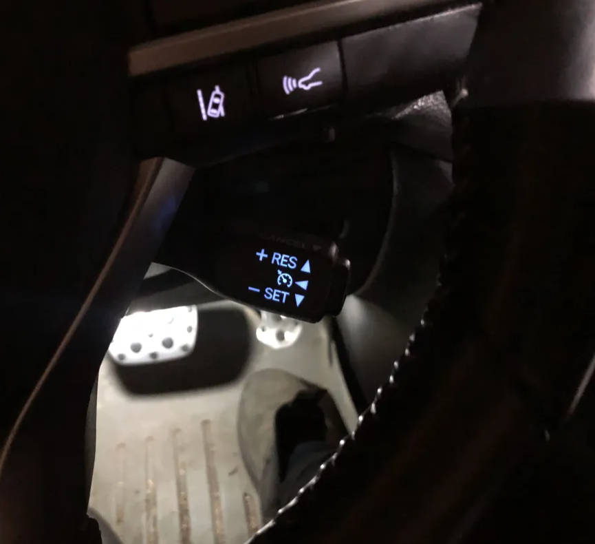

Original post: https://www.clublexus.com/forums/rx-...rol-stalk.html
Added an illuminated cruise control stalk I pulled from a junked 2015 RAV4. The stalk was originally blue, so I swapped the LED to white to match the interior
Original "blue" colour
White

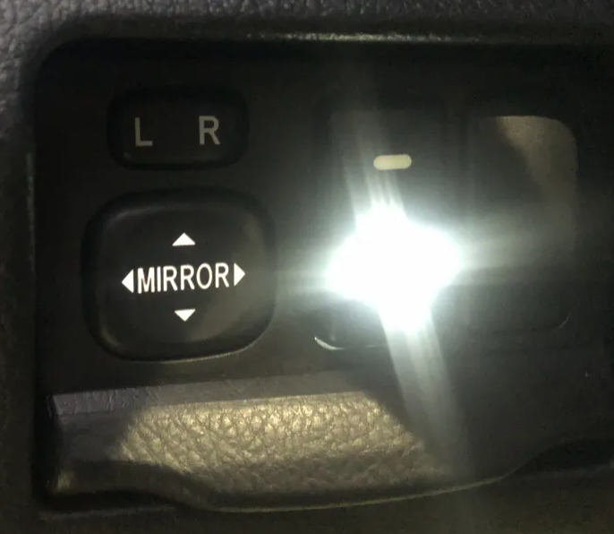

October 22nd, 2023:
Original post: https://www.clublexus.com/forums/rx-...h-install.html
Added light-up mirror switch from a 2013-2018 Toyota Avalon!

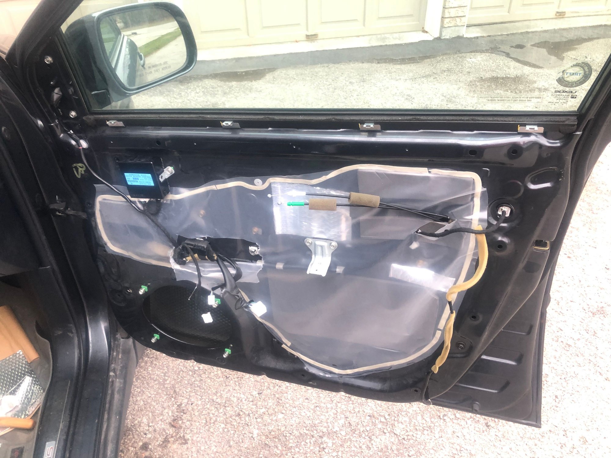

Dec 5th, 2023:
Finally got the front doors fully-deadened and put back together! Previously, I mentioned that the vapour barriers were beyond repair, so I had to make new ones. I used the old ones as a template and used some vapour barrier material lying around from a reno on our house.
With all the wires covered in Tesa tape and every big hole in the door covered with deadening, there are no rattles no matter how high you crank it! It really helps to put some deadening behind the mirror control module and that little metal bracket that holds the screw for the door panel.
Just like the factory barrier, I had to add a piece of tape for the flap to close where it’s open for the wires to go through. I need to brush up on my arts and crafts, but it’s functional! I used butyl tape from Dicor to hold it to the door.

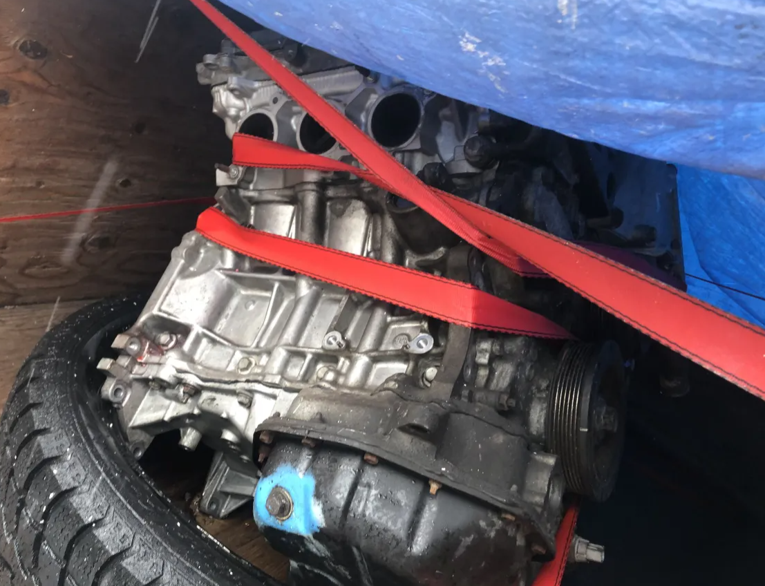

Now for the real news! Two days ago I picked up THIS
A cheap 2GR-FE from a 2011 Sienna! 200k km on it and looks so clean you could eat off it! Turned over nice with a breaker bar and 22mm socket, and when I looked into the intake and cylinders with an inspection cam, I didn't see any "malice in the combustion palace". It needs head gaskets (has the infamous coolant leak some of these had) but was running before they changed it for the customer. Came with everything minus the accessories and a bunch of spare parts + the ones already on the engine (coils, fuel injectors, etc). Since it's 2010+ it has the proper metal oil cooler lines and metal bank 1 vvt-i line. That also means it has the updated cam phasers! I'm planning on taking this apart and rebuilding it and having it on stand-by as a spare for my RX. Potentially even a swap for my 2002 Highlander. Depends what car needs an engine first! Now I have a spare U151F AND a 2GR, so the swap on the Highlander is entirely possible!

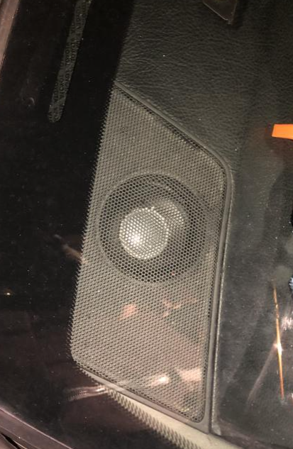

[QUOTE=MattRX;11523897]Alright, so nothing major has happened on the RX which is why this post has been a little dead. HOWEVER I need to document some stuff here so I have an organized/easy place to go and check my checklist, etc. so, I hope this is interesting enough! With that, I also have some more updates and future plans which I will also get more in-depth with at the end of the post. A lot of this stuff has been documented in other posts, but I feel like it would be nice to tie it all together in here.
May 5th, 2023:
Original post: https://www.clublexus.com/forums/rx-...er-system.html
2004-2009 Mark Levinson models have really nice metal mesh dash speaker grilles vs the flimsy plastic ones Pioneer models come with. Pair these less-restrictive grilles with the 3.15" Avalon dash speakers and the better mounting surface to add foam and you have yourself a no-brainer free junkyard upgrade! PNP fit!
Lookin' good! It also really shows off your dash speaker

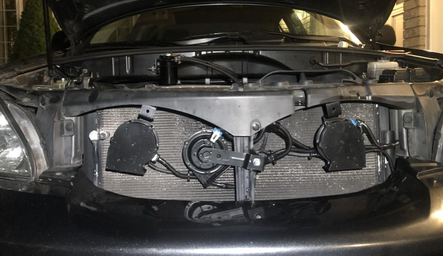

Buick 3-note horns installed (Notes A, F and C). Yet another mod that I miss from the Highlander. Some LOUD horns! Unlike the Highlander, our larger RXs have the room to fit the big ol' Delco Remy metal horns from Buicks, Cadillacs and other GM cars from the 70s / 80s / 90s. They don't make them like they used to! Wired to a 30 amp waterproof 2008-2019 Grand Caravan relay, and 20-amp inline fuse. Mounted that relay in the same spot as the Highlander too (driver side near fuse box).
