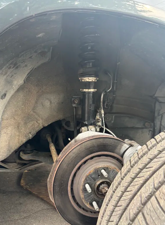

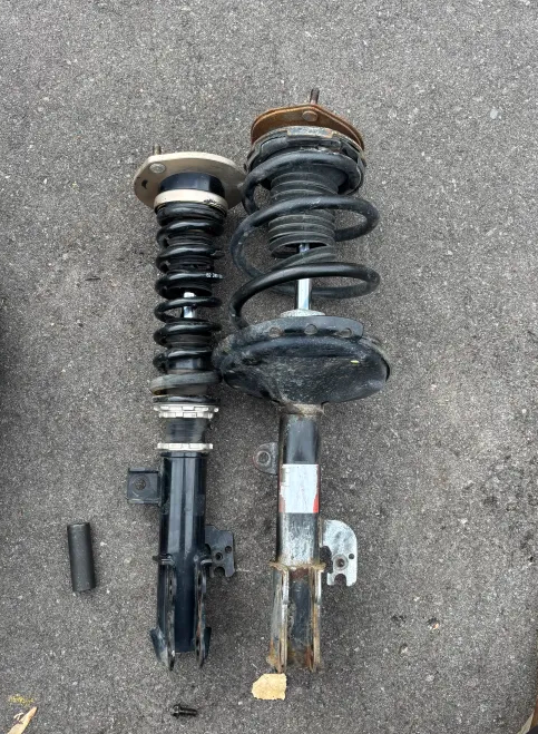

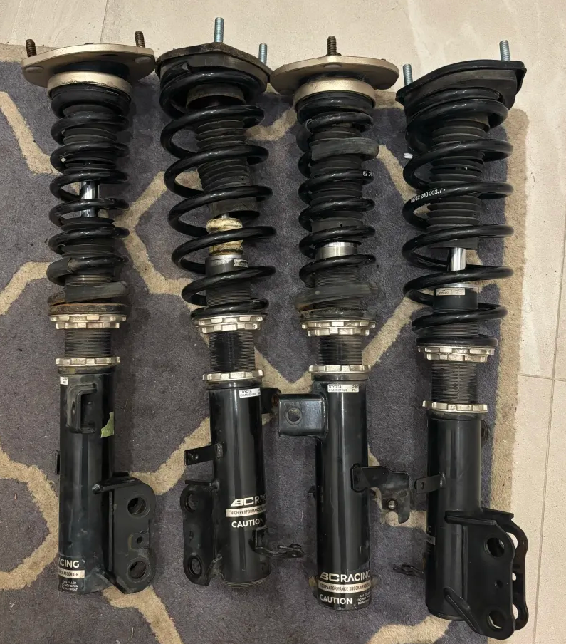

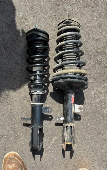

Finally got my hands on some coilovers! One of my coworkers had an RX330, and promised to sell me the coilovers before selling the car - now they are in my hands! They're BC Racing BR series. These are a couple years old and not perfect, but seem to be in pretty good condition overall and I am excited to try them! All four dust boots are ripped up and the springs have some rust, but I might want to go with some stiffer springs anyway.
The spring rate is 6k front and 3.7k rear, which seems really soft to me, so I want to try running them first any maybe picking up some stiffer 8k & 6k springs or maybe something even stiffer later. I test-drove the car and it felt almost as soft as stock. I can also play around with the damper settings too and that might help - we'll see. I like how firm my Eibach springs are, but I probably won't need to go with something that stiff if the car is going to be sitting lower. I really don't want to lose my ability to shove 1000+ lbs in the trunk and the car to barely sag - however!
For anyone wondering. The front dust boots are 150mm long and have a 50mm OD and a 22mm ID for the rod, the rears are also 150mm long and have a 20mm ID. Bump stops are 40mm long and have a durometer rating of 70a. It seems that most of the individual pieces are sold by BC, but the rear springs are special as they're not a universal coilover spring and they reuse the stock rear mounts. The fronts are 62-240-6 (62mm ID, 240mm length, 6k spring rate), the rears are 280mm long and are 62mm ID at the base, but get progressively wider near the top to match the contour of the strut mount. I want to make some custom all-steel rear mounts that use a straight 62mm spring, to open up my options for other springs.

Got them in today! They're stiffer than I was expecting despite being 6k front and 4k rear. I have the dampening set to 15 (middle) just to get a feel for them for now. The ride quality is similar to the Eibach springs, although big bumps are a bit more harsh, but smaller ones are handled better. Might have to stiffen up the front a bit, as 15 up front doesn't feel as stiff as 15 in the rear. The Eibach springs feel a bit stiffer, but you can tell they were on shocks (Sachs) with noticeably softer valving.
Body control is nice, there's even less nose dive and squat now - and the car feels even more settled and planted in a corner, with less travel it feels like it wants to pick up a wheel! The fronts being solid mounts have better steering feel and response by a little which is much appreciated, but that comes with a small NVH hit - albeit a minor one. Not going to bug someone like me who prefers something with a stiffer / sportier ride.
