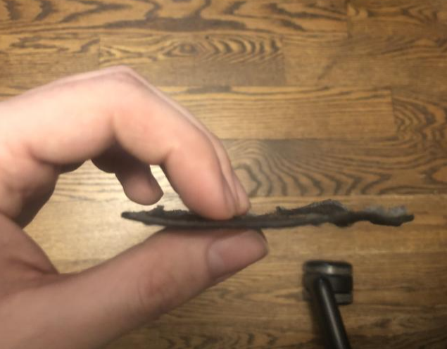

Top view of the cover, you can hardly see through i!
Side view - it's super thick at .5mm!

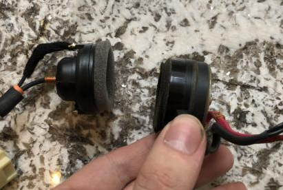

I have had the 2005-2012 Toyota Avalon JBL speakers in for a while but I waited for the tweeters before making an update. A lot of people hate on the JBL system and it's a very "hot" topic on the various Toyota forums. I'm not an audiophile, but I was a music student and appreciate quality sound. While I was not expecting this to sound like a high end aftermarket system with component speakers, crossovers, etc - I am SUPER happy for how little I paid vs. the improvement it brought! People expect a lot out of the JBL system, and maybe they have a right to if they paid for it new - but I didn't!
This cost about 84 CAD all-in and includes: Two 2 ohm 6x9 front door speakers (6.5" speaker in a 6x9" bracket - 6.5" or 6.75" aftermarket speaker can be substituted) 2 ohm 6.5" rear door speakers (Similar to the front speakers, although glued into the bracket so they're not removable) 2 ohm 3.15" dash speakers (2.75" measured - way better than the muddy factory ones, I can actually hear them! They can play to a higher frequency, but mostly shine with the punchier mids!) and 5 ohm 1 - 1 3/8" tweeters. Like the door and dash speakers, these are plug & play with the stock harness. These were original equipment on the 03-09 Toyota Harrier (right side was not a direct fit read more to find out).
2x 86160-AC430 - Front speaker
2x 86160-AC280 - Rear speaker
2x 86160-AC271 - Dash speaker
1x 86160-0W740 - Left tweeter
1x 86160-0W730 - Right tweeter
Avalon front speaker brackets disassembled:
https://www.toyotanation.com/threads...#post-14795941
These resemble the tweeters in my 2002 Highlander w/ JBL and are aluminum. Like the Avalon JBL dash speakers, these tweeters use a neo magnet, have fantastic crisp highs and sound great with vocals and instruments like saxophones, etc. Perfect for what I listen to! I prefer them over the larger voice coil Avalon/Prius tweeters which are punchier but not as crisp. You can get a decent sound out of this cheap junkyard setup if you play with the EQ, use .FLAC files on a CD and if you add sound deadening to the doors, and where the speakers mount. For EQ I used -1 bass, -2 mid and 2 treble. I can't wait to get an aftermarket head unit like on the 'Lander and get higher sound quality and more control over this stuff! Obviously I wasn't expecting miracles but I was pretty surprised with how well this all turned out. The setup's a little bit mid-range focused and (obviously) lacks some bass, but I will be adding a 8" or 10" subwoofer running off an Alpine amp to solve the bass response. For now, all of the speakers are running on the original Pioneer amp with no issue.
Part 1 - What this car lacked the most after the dash speakers - Highs / Tweeters!

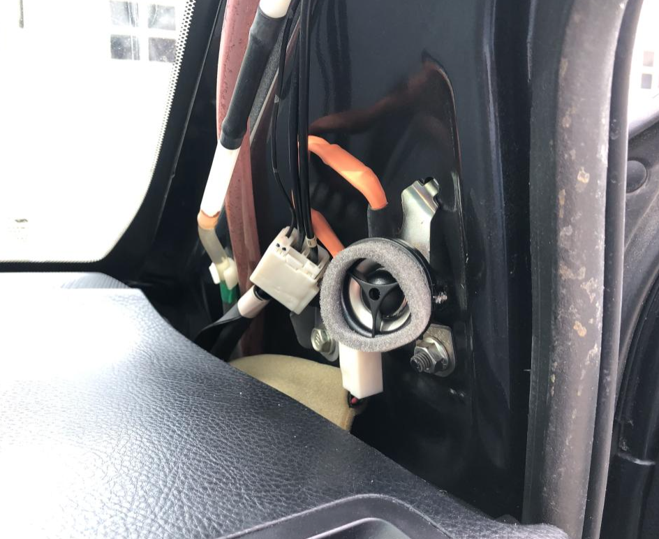

Stock tweeter - complete and utter garbage! It won't be very hard to improve upon this junk that sounds like a "phone speaker"!

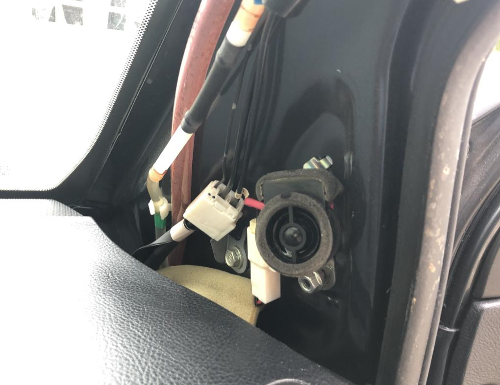

JBL new old stock tweeter - what a great upgrade for 8 dollars! MUCH better in every way! Sounds like an actual tweeter!
JBL - left, Pioneer - right
Great time to sound deaden your A pillars!
The driver's side tweeter was a perfect fit. For the passenger side, I had to take the original tweeter off its bracket and transfer it over to the JBL tweeter. Philips screw to remove it, be prepared as it takes a lot of force to take it off! Pry it off and remove as much of the old goop / adhesive that you can. The JBL tweeter then needs to come off, this one is also super tight and is a 7mm nut on a stud instead of a screw into the back of a magnet. Make sure to spread the wires away from the nut so they don't get damaged. Transfer the JBL tweeter onto the stock bracket, clock it correctly so the connector lines up properly and viola! I learned that the tweeters in this car are actually directional and have different part numbers. The other side is not as common and sells for almost 3x as much on eBay. After seeing how easy it was to swap it over, I'm not sure it's worth it to pay extra...
86160-0W740 (JBL tweeter - Driver / Left)
86160-0W730 (JBL tweeter - Passenger / Right)

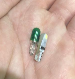

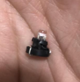

Next up is replacing the bulbs down by where the shifter is. My heated seat switch and ECT snow light were burned out. The windshield washer and shifter light were dim and probably not too far behind, I also decided to change my cigarette lighter light from a green LED I installed prior to a white one. I decided to "make" my own bulbs for the neo wedges by wrapping 3mm bulbs and a 5mm 12v "hat" into the factory neo wedge bases. The pre-made ones were complete crap and didn't even come close to fitting at all! The leads for the bulbs were way too thick, and the base's tabs were not even close to fitting the factory Toyota switches. The cig light had some weird proprietary bulb, I ended up soldering a 74 LED bulb to the factory leads. I'll be dealing with the bulbs up top when I change my factory head unit. I have done the whole interior on my Highlander already in yellow, so this shouldn't be too far off from that. For my heated steering wheel switch, I switched to a 3mm 3v LED bulb to change it from amber to white to suit the interior. I also plan to add a TRAC OFF switch from a FWD 2004-2010 Sienna at the junkyard. I'll be hooking this up to disable traction control, as I was getting tired of reaching under the dash to disable it.
Bulbs needed:
Cigarette light - 74 type LED / 12v 5mm LED bulb
Shift light - 74 type LED
Windshield washer - T3 neo wedge / 12v 3mm LED bulb
ECT snow - T3 neo wedge / 12v 3mm LED bulb
Seat heater - T4.2 neo wedge / 12v 5mm LED bulb
TRAC switch - T3 neo wedge / 12v 3mm LED bulb
Heated steering switch - 3v 3mm LED bulb
TRAC OFF from 2004-2010 FWD Sienna
New colour for heated steering. White instead of amber
Cigarette light
Shifter light
ECT snow & Windshield washer & TRAC switch
Seat heater
Nice and crisp white! Much easier to see than the dim green lights from before.

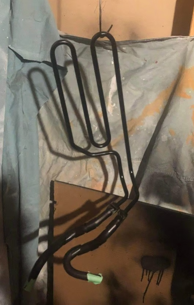

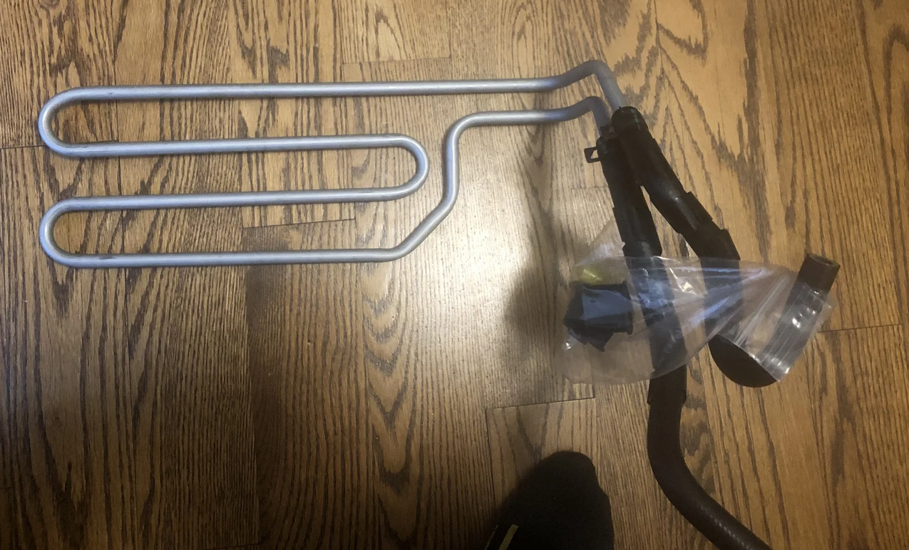

Now onto some mechanical stuff! My previous experiment of running a Chrysler 300C 5.7 flow valve for the power steering was an EPIC fail. It didn't firm up the steering, it actually did the opposite! My guess was due to the 300's larger PS pulley and possible rack differences. My next attempt will be a 2005-2010 Scion TC power steering pump. The TC has the same pulley size as the RX and physically fits. As a "sportier" car, I'm hoping this is the key to firmer and heavier steering in 07-09 RX350s! Staying on the topic of steering, I also decided to pick up a power steering cooler. You can use any power steering cooler that comes on the 2001-2007 4-cyl tow package Highlander or one of the super rare ones that came on our generation of RX if you can find one! (They weren't put on cars in North America). The one I bought was the Sunsong 3404295 one from Rockauto. Now this is all fine and dandy, but it doesn't come with the brackets. You need to source those from a 4-cyl TP Highlander or unicorn 2nd gen RX that was built with the cooler installed. I retrofitted the cooler on my Highlander and after hard Auto X runs, the fluid hardly rose at all! I'll need to find those brackets for my RX before I can install the cooler and I plan to do it along with the P/S pump, oil cooler o-ring / gasket and possibly the front and rear exhaust headers. In the meantime, I have painted the cooler in black enamel engine paint.
Power steering cooler! Looks almost identical to the one on my 2002 Highlander.

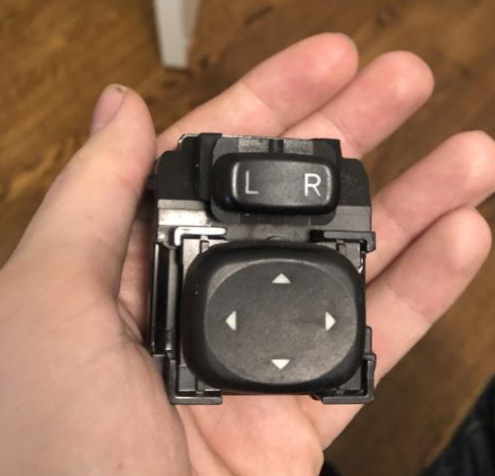

Next goodies to play with are illuminated mirror switches from a Lexus CT200h! Unlike the stock ones, these will require some different wiring to light up, it's just way cooler! I'll be tackling that soon on both my Highlander and 08 RX. Once I have these items rigged up (power steering + switches + other maintenance), I'll update this post! At this point, my RX is nearly respected as much as my trusty 2002 Highlander that hasn't let me down to this day. This thing has been a pleasure to own and I hope to own it for many more years to come!

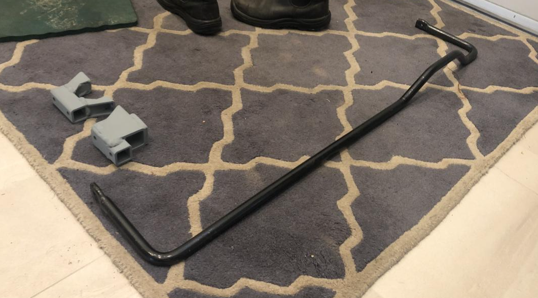

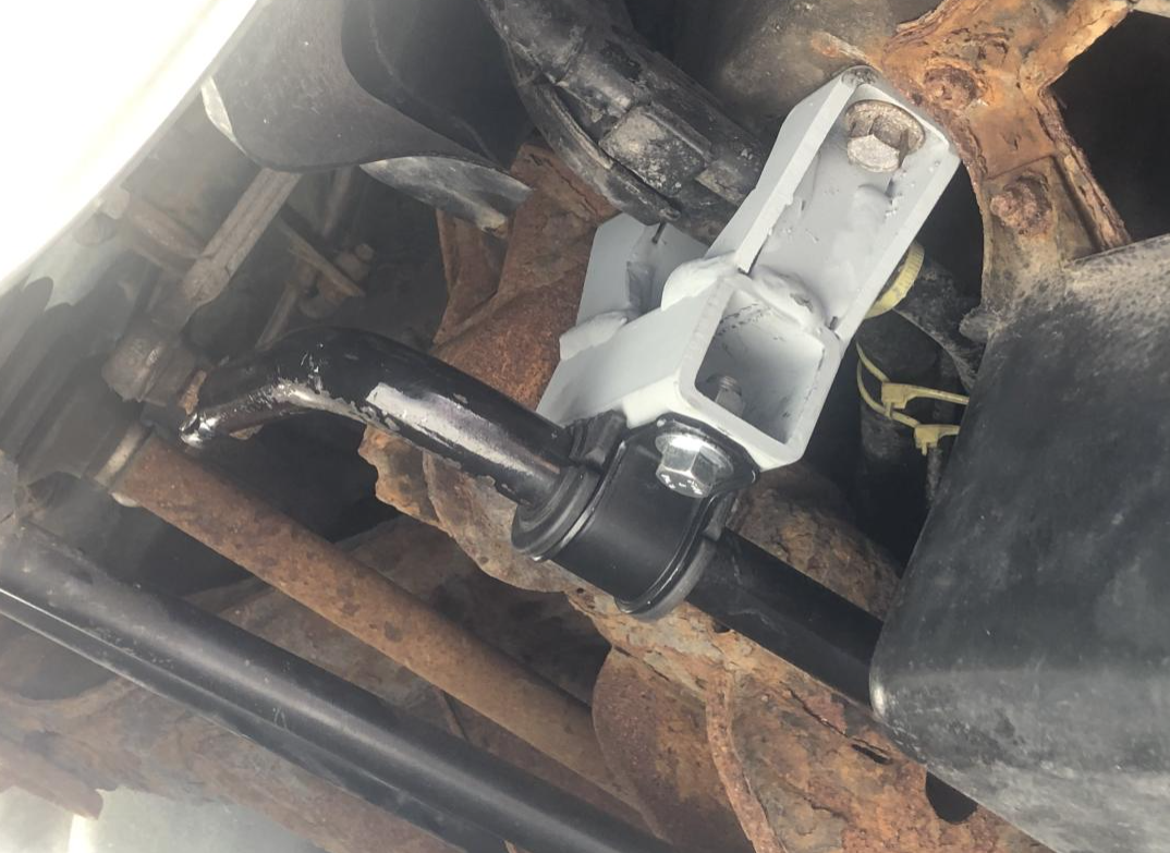

MASSIVE news for the RX today! I finally have some functional prototype brackets made for my V2 rear sway bar mounts for 99-09 AWDs! My drawings / mock up were a close match and the brackets had great fitment! They fit both my RX350 and Highlander, but I'm going to need to get another set made for the RX! Going to clean these up, paint them and put them to the test on the Highlander! The Highlander's getting them first because I already have a large sway bar to use them on (22.2mm), my RX350 just has the 16mm 04-07 Highlander one, as there is no size equivalent to the Addco 2109 for it. Now that I have the brackets and know they work, I can focus on getting an aftermarket sway bar made for my RX!

Success!!! Finally have my big 22mm rear sway bar back on my 2002 Highlander after years of it sitting in the basement after the factory brackets broke! Version two of the brackets are all painted up and on the car. Have had them on for three days and there is no flexing and creaking like the factory junk brackets that snapped within a month! So far it has been amazing and I absolutely miss this setup whenever I have to go back to the RX. These brackets fit my RX, but they're on the Highlander as it has a sway bar that's a big enough caliber to warrant them. Plan #1 so far is to revise the passenger side a little bit to make installation onto the car itself easier, but fitment on the car and bar itself is absolutely perfect, even more so than the original brackets which hold the bar a little crooked on the passenger side and don't tie into as many points on the frame as my new design does. Plan #2 is to get a custom sway bar made for the RX so it is as planted and as neutral-handling as the Highlander
