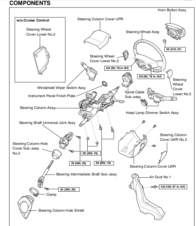

Originally Posted by DavidTB
So got the answer and the fix. The steering had spots in the turn that was very hard to turn, both ways. No fluid leaks. Turns out it was an “the steering column flex coupling, intermediate shaft”. Basically a shaft on the steering column that has a small u joint. The u joint was stiff when it got to a certain angle. Fixed at a local shop that is very good with steering and front end work. The part was only available from Lexus. Shaft $422, and $200 for labor.
+1 Thank you for sharing your fix and following up.
Is the part that failed in this pic and if so can you tell us what parts?
I would like to know for myself and others that may go thru these same symptoms cuz didn't think of column issues and if labor only $200 could maybe be a diy job.

Default These
This, the u joint was real stiff, locking. Looks like these three parts came as one unit.
