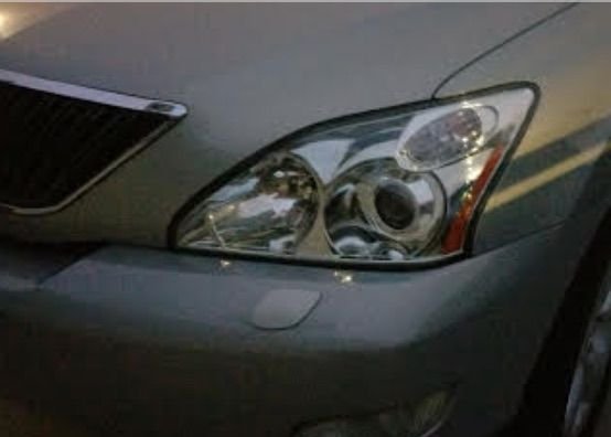

I am looking to replace the headlight covers on my 2011 ES350 Lexus. They are yellow and cloudy. Can I replace just the lens covers? If so where do I get them?

After Sylvania restore kit use. The lens was very yellow and cloudy.
I used this kit to restore the lens:
Amazon Amazon
Cheap and actually came out great.

last photo was taken 4/30/2018. new photo today 03/25/2019. car is outside in SoCal sun 24/7.

I have the same kit in my aresenal though I have not used it. Any kit without UV protection will not last, which is why that kit is probably the best you can get for the money.
