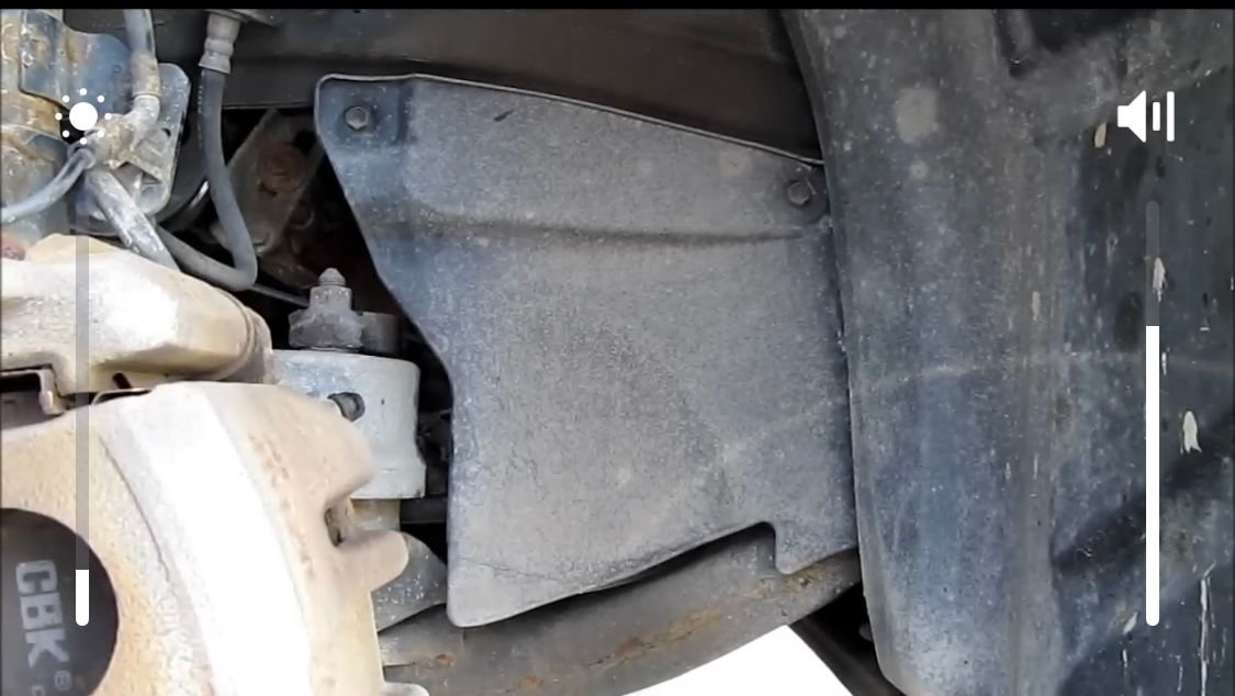

What is this plastic piece called?

Default What is this plastic piece called?
It takes two 10mm bolts located behind the wheel hub on the passenger side. Both my mechanic and the dealership cannot tell me what this part is.
the power steering belt is just exposed so I like to close it up again
Any help is appreciated, thank you.

What car?

side cover looks like rx350 if you have lost the cover go to a dismantle yard and buy a 2nd hand one or make one out of plastic

Originally Posted by XRX
What car?
​​​​​​​Sorry: Lexus Rx330 2005

Hello,
I had the same problem. I looked in ebay but it was too expensive so I just went to the junk yard and got it for like 10$

It's a Front Fender Apron Seal, RH. Part# 53736-33030. There's a few on Ebay. Cheapest is $20. $75 new OEM
It was impossible to identify in the parts catalog by looking. I found it by looking at instructions to replace the power steering pump
1. REMOVE FRONT WHEEL RH
2. DRAIN POWER STEERING FLUID
3. REMOVE FRONT FENDER APRON SEAL RH
Thank you so much for your help! Was driving the dealer and my mechanic crazy.
