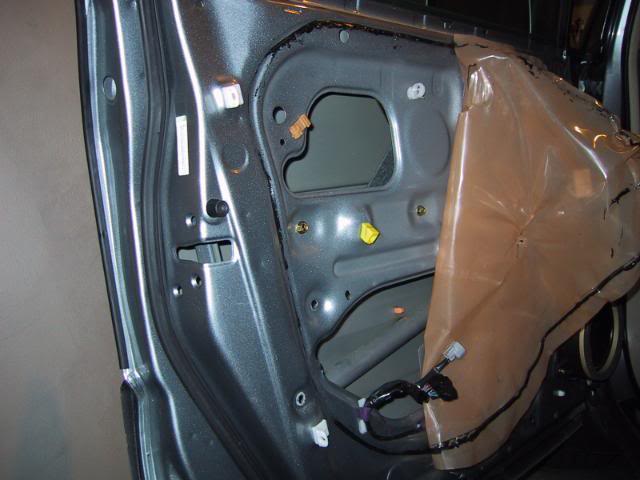

So, it sounds like it's just easier to re-attach the rods with that piece (handle/lock assembly) being unbolted (like in the video)....and working from the outside of the car to reattach the rods. (hope that makes sense)
I totally understand the piece we're talking about, I just don't see the bolts to detach it. Do you have to loosen them from inside of the panel?
For example, I don't see them in this pic (or how to access):
Not sure I see them from the inside either:
Thanks again for your help.

2nd picture shows the head of the bolt, Right of the pink clip and at the bottom of the assembly.
The top one (2nd) is to the right (as viewed in the picture) of the handle.
The access is through the hole ... you stuck your camera in there.
You are over thinking it. It will be intuitive and believe me identifying the bolts is the least of the problem.
Salim
