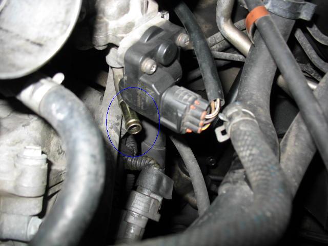

We have talked before about the IACV valve on the throttle body. Now some have removed the IACV valve completely to clean it out, this is also good to see how the valve is functioning itself. However, I wanted to show a little advanced step without having to remove the IACV to clean it.
Note below the blue arrow. This is running along top the air assist hose that connects to the engine block through some hoses and goes into the IACV valve at the end of the arrow.

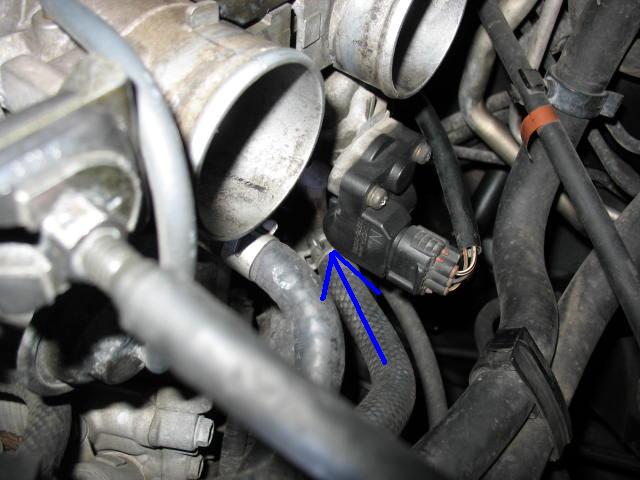

Now I disconnect the air assist hose and you see the valve.
Attached Thumbnails I have a bad gas mileage, how about yours ??-img_3428.jpg

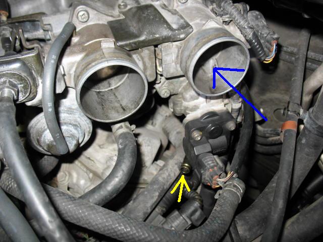

Then you want to shoot in the hole where the blue arrow is with carb cleaner or other engine degrease (actually I used something akin to liquid wrench that also worked well) and whatever you spray in there, will come out where the yellow air is pointing. For me, it was a little black at first and then clearer.

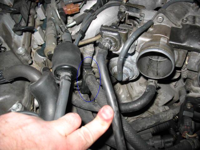

Now in the previous photo you can stick a small plastic cup or several sheets of paper towel underneath to catch the residue.
Next step is the this piece circled in blue. This plastic piece is where the air assist hose from the valve on the IACV valve goes to (do also clean that hose with some cleaner). Its function is to divert the air to the front and rear bank. This also gets dirty and I also had a bit of residue in here, too.
