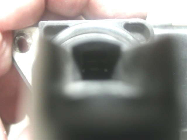

Old Jul 22, 2007 | 10:51 AM
Lexmex's Avatar
Lexmex
Joined: Apr 2004
Posts: 17,318
Likes: 202
From: Miami, Florida
If you turn the sensor upside down and peak into one of the two openings you will also see 2 small threads. Clean these also by simply spraying in there and then turning it rightside up. Blow in it after about a minute or so and give it a little shake, then it let it dry for a minute or two and reinstall.

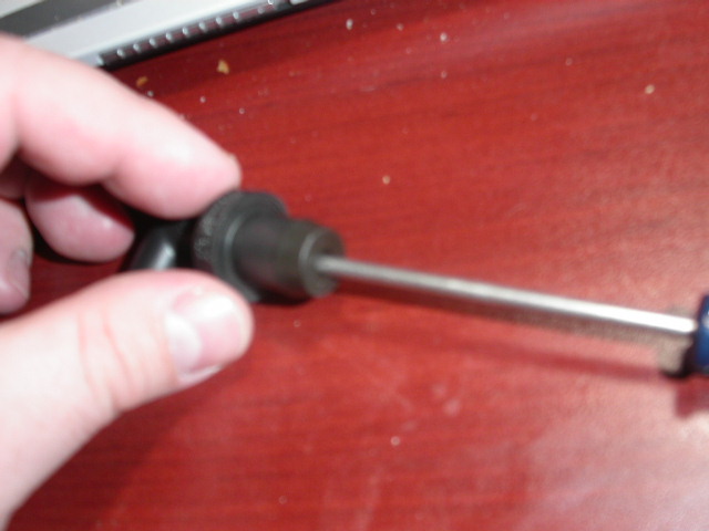

Old Jul 22, 2007 | 11:11 AM
Lexmex's Avatar
Lexmex
Joined: Apr 2004
Posts: 17,318
Likes: 202
Just pull it out with a strong tug and then disconnect it from the clamp on the rubber hose it attaches to. What I recommend is spraying some of that computer keyboard cleaner or electrical contact cleaner in there (works better than carb cleaner) and then rinse it out with water. You should be easily able to press it in with a screw driver/paperclip or other.

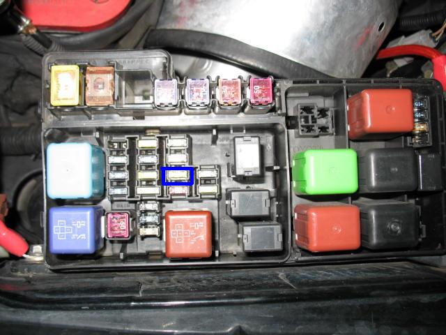

Last thing I recommend to do is pull the negative battery cable off for a few mintues to reset the ECU. The short of it is that your driving habits are evaluated so to speak by the ECU and depending on this and the state of the vehicle will ultimately affect your gas mileage.
Another small trick that does the same thing, though not quite as effectively is to pull out (with the key of the ignition) the EFI fuse located here in your fusebox. Take it for at least a minute and then put back in and start up your vehicle. It might have a low idle at first but then should start to pick up. This is normal. Pulling the EFI fuse for a minute can also help reset any CEL (Check Engine Light) you may have, assuming it isn't something that is permantent such as a messed up part, bad sensor, etc, then the light will stay on.
