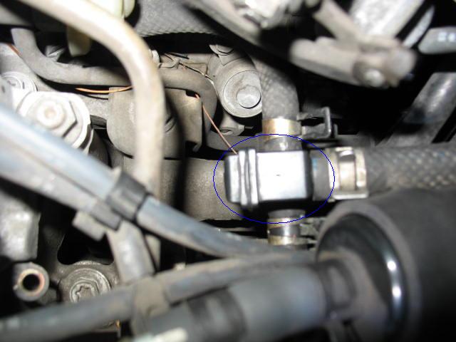

An overhead view of the piece. What you want to do is disconnect the hose on both sides of this piece and then clean it with some cleaner (carb cleaner, engine degreaser) and then wash the piece out with water.
What cleaning that IACV valve and this piece should take care of is some low idle issues that sometimes occur with these vehicles.
Attached Thumbnails I have a bad gas mileage, how about yours ??-img_3431.jpg

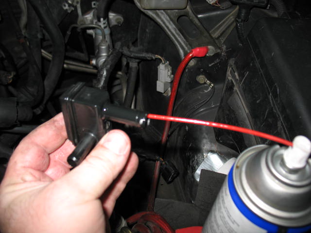

This is what you have to do with that piece, remove it and then spray as shown and the spray should come out both of the lateral sides. Then clean out with water and blow air into it.
Attached Thumbnails I have a bad gas mileage, how about yours ??-img_3447.jpg
