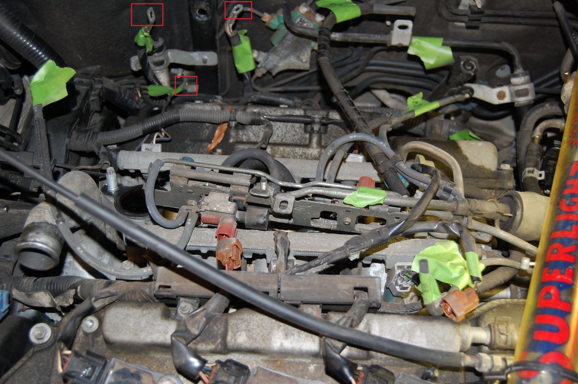

Last time I removed the plenum I left a ground unconnected and had the hard late shift issue.
There are three grounds, see photo below. Left two connect to the end of the plenum. Third connects to the back.
I had left off the one that connects to the back

This was it. I dug around behind the intake and the ground wire was tucked down under the wiring harness. Thanks for the help!
