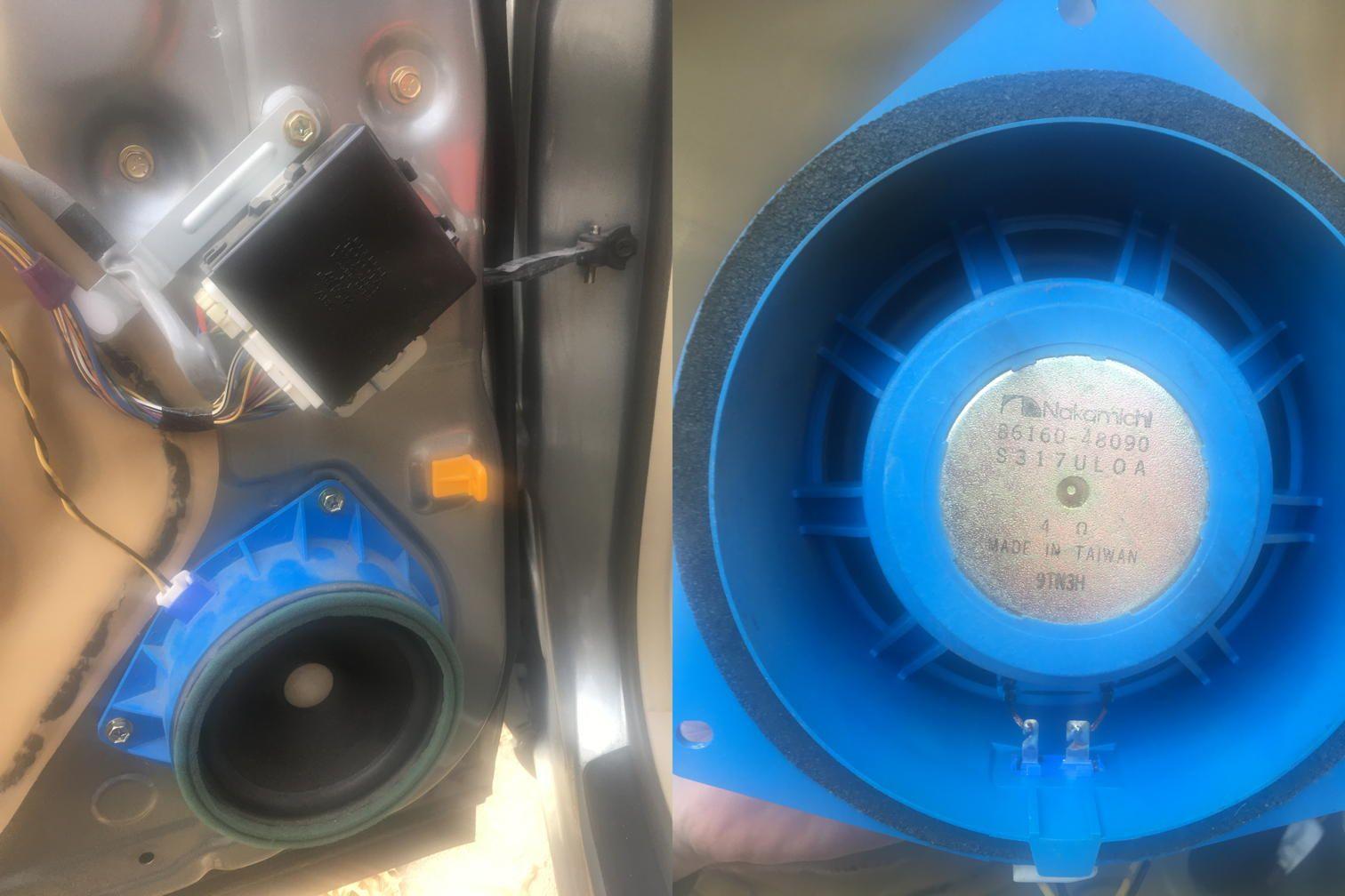

OK, turns out my 24 year old speakers are not trashed - at least not on the driver side.
Also, turns out the Nakamichi system door speakers do NOT have built in amplifiers, and they are NOT 2 ohm (as I have seen mentioned before). Here is what I found on the left front door:
And here is what I found on the left rear door:

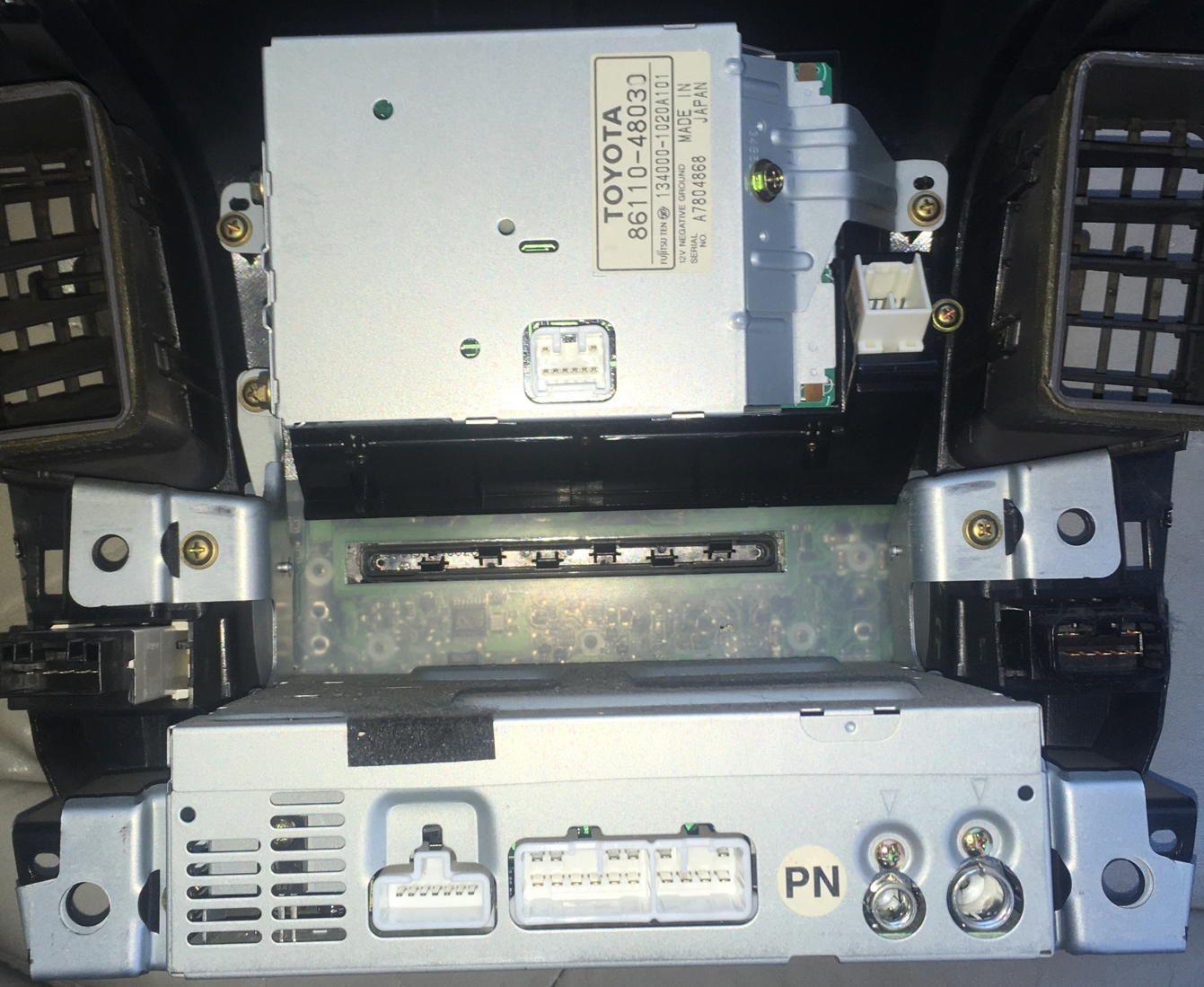

And just for reference, here is what I found on the back of the radio:
Anybody know what the smaller of the two coax cables is for? I know the larger one is for the radio antenna.

There are Two antennas referred to as diversity antenna and Mast antenna. The diversity antenna should lead to side glass above the passenger side rear hatch . There is track like a defroster track.
still have to figure out what id sounding distorted. You may like to test the speakers out. The coil is held by webbing and then the cone is suspended by flex material to the frame.
