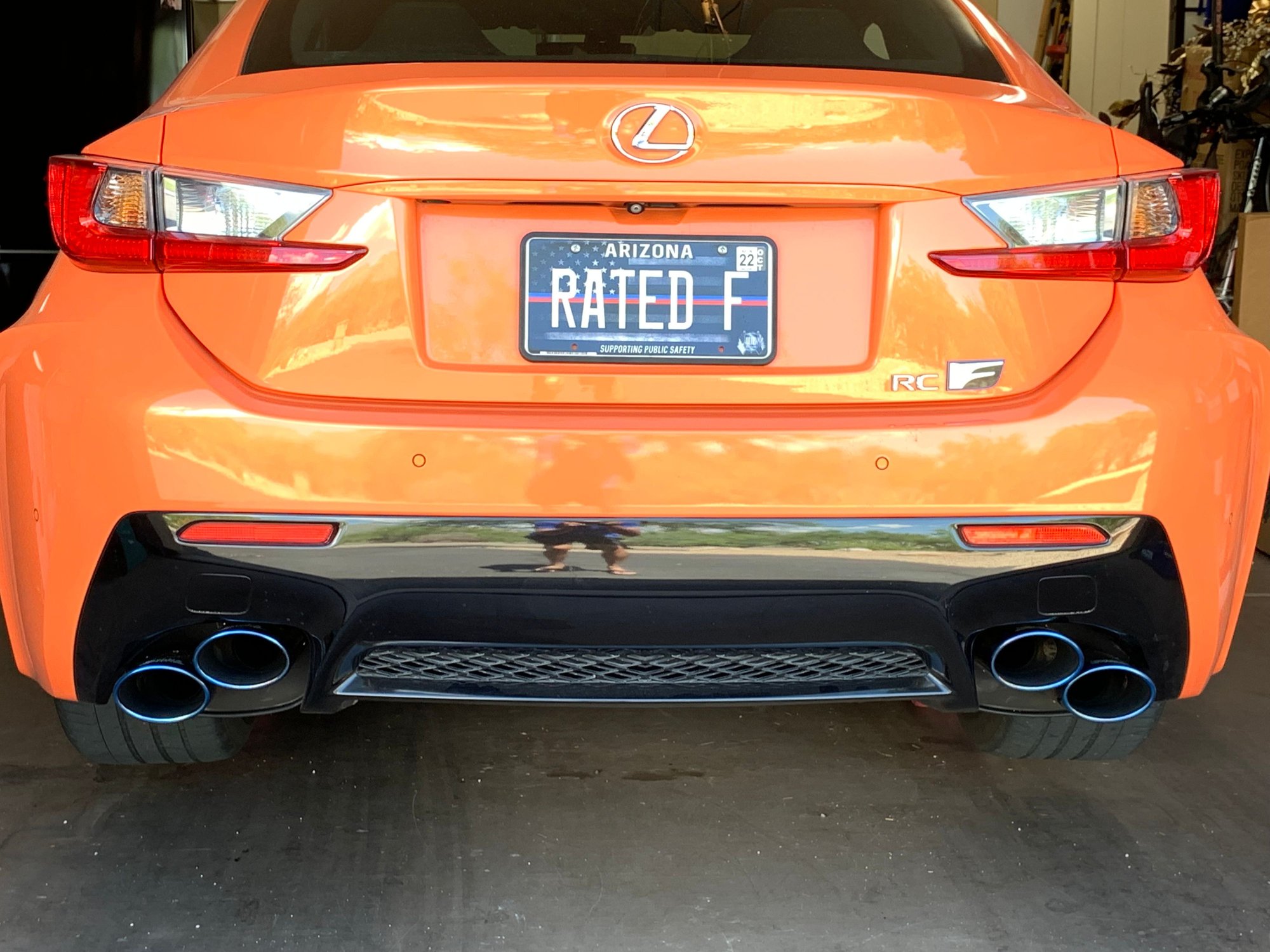

Just finished installing GrimmSpeed gaskets on my 15 RCF to replace the front gaskets that came with the Invidia exhaust due to a CEL. I didn't use any sealant, just installed the new 7 layer metal gaskets after cleaning up the surface.
Looks like the passenger side gasket had a leak out the bottom on the Invidia gaskets that came with the exhaust.
So far, no CEL and I'll let you know if it comes back. If solves the CEL, this might be an option for those just purchasing an Invidia or dealing with a leak and CEL.
I also painted the back of the exhaust cans black. I just did the back and left the rest since you can only really see the back from behind the car and it looks good from underneath with the chrome.
Invidia gaskets. Passenger bottom side appears to be where the leak was.
Invidia Q300 after blacking out the rear of the cans
Stock Invidia Q300 exhaust

Looks great! The black out look is nice! Shame about the gasket but yep, you can clearly see it failed. Which makes me wonder if perhaps the gaskets that are provided are simply not thick enough from the flex of the exhaust..
If you remember, do you know how much thicker the 7 layer grimspeed gasket was over the standard invidia gasket?
Also which paint did you use for the rear of the mufflers?
*Fingers crossed this solves the problem for ya!

The 7 layer grimmspeed gasket was about the same thickness as the Invidia gasket, but definitely higher quality.
I used VHT FLAMEPROOF Coating for painting the cans after sanding with 320 grit and cleaning with rubbing alcohol.
There might be better paint, but that's what I could get on a Sunday morning at AutoZone. Looks so much better in my opinion.
Went for three drives to cure the paint and no CEL. Fingers crossed!
