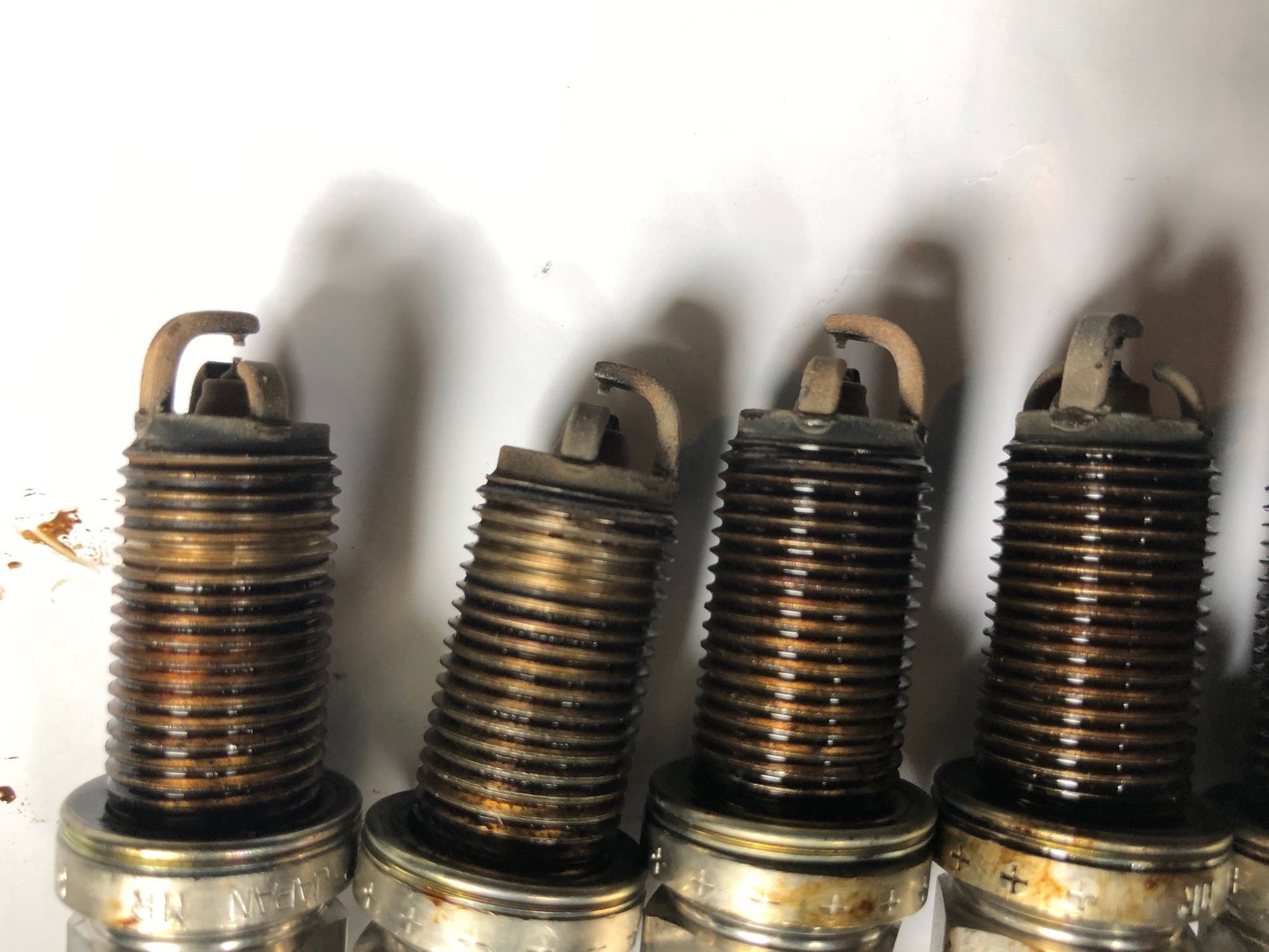

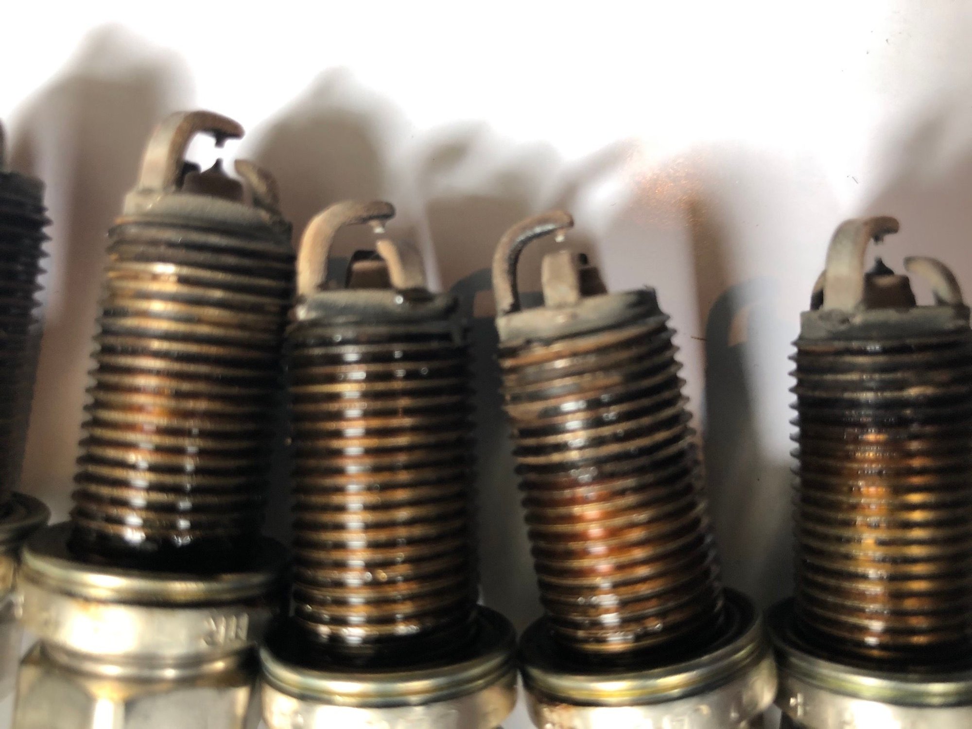

Did my spark plug change at 60,500 miles. Below is a photo of the OEM plugs. They seem fine. Wanted to show you guys what you thought. I replaced them with iridium Denso IKBH20TT plugs. I got them at Advanced Auto Parts for only 8.99...with 20% promo I got all 8 plugs for $61.71. I suggest if you are getting close to 60k to buy these in advance. Much better that the $18 a plug that Lexus sells as rebadged Densos.

No difference. To be honest when I inspected the plugs half way through the install it looked like I could have gone much longer on them.... but I was already 5 plugs deep into it...lol. Start up was crisp and immediate like before, power is still there, my mpg on eco still reaches 25mpg easy on a long hwy run....I think I may have felt a difference if I was closer to 90k.
