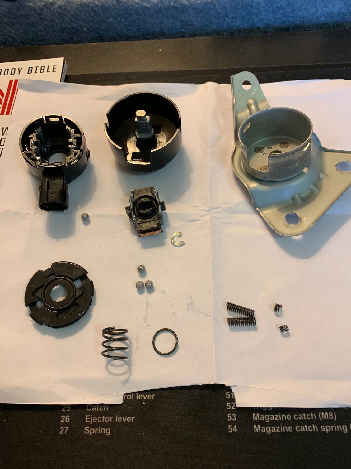

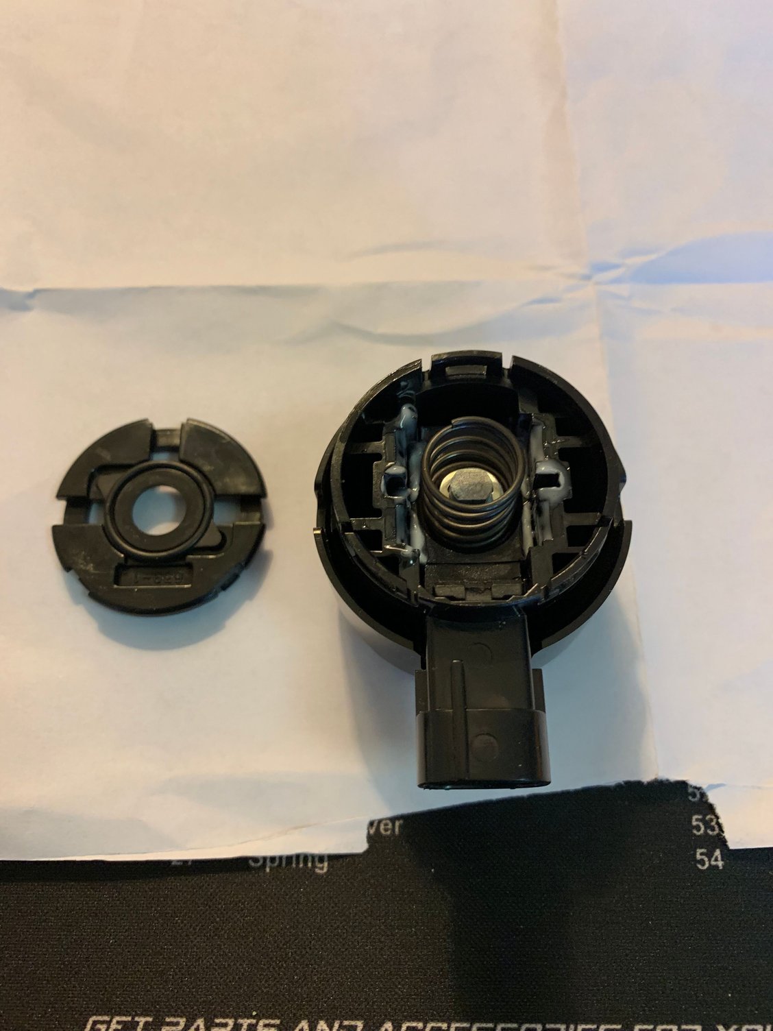

I took care of that stiff switch on my RCF. Here are some pictures I took when I did it.
Taken apart.
Showing 3 springs after cutting.

Looks very familiar to me.

Nice pictures. My biggest complaint about it is, you can roll into the throttle especially coming out of a turn past the kickdown switch since it requires so much pedal pressure to get past it, your foot slams to the floor and suddenly you have 100% throttle.

I've been driving them back to back for a couple of weeks now. Issue #1 - the kickdown switch in the GSF is too stiff and artificially limits WOT. I chopped the springs in my ISF's kickdown switch and it is no longer noticeable when I go WOT. I think I need to do the same thing to the GSF to be fair. Issue #2 - the GSF seems so much more gentlemanly than the ISF. My ISF throws me back in the seat with an attitude while the GSF squeezes me back. It's just not the same, but both cars leave the average driver in the average car totally for dead. Issue #3 - I am still sorting out all the options on the GSF, and just today I figured out the mirrors will not do stupid things in reverse if you pair the key with the personalized settings. I've bee suffering because I normally set my mirrors to zero overlap, and the damned things go crazy wide if you don't have a key paired to the seating preset. The ISF does not do this. Pissed me off to no end at first because I always back into my garage, and more often than not, back into parking spaces to ensure I don't scuff the carbon fiber nose (OK, I do the same thing with my ISF too).

JT2, how is this thing attached to the car? I see no screws through the 3 holes on the flange in the top picture, or you already removed the screws before taking the picture?
Yes, the bolts were already removed in the first picture.
